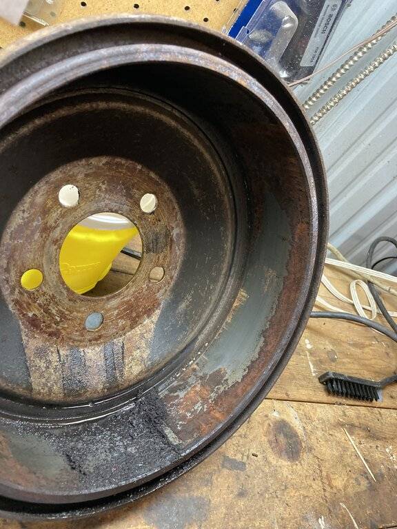

Pull the wheel and the brake drum. Odds are that the rear axle seal is leaking and the shoes are stuck to the drum. You could also have a stuck wheel cylinder, if that is the case replace all of them. Other possibility is that the brake cable to that wheel is seized or someone has messed with the cable adjustment.

Most of the time you can free up those stuck cables by grabbing the cable with both hands and bending it back and forth. Even getting it to back off a little bit should make it easier to get the drum off. Then you can use a pry bar to retract the cable all the way.

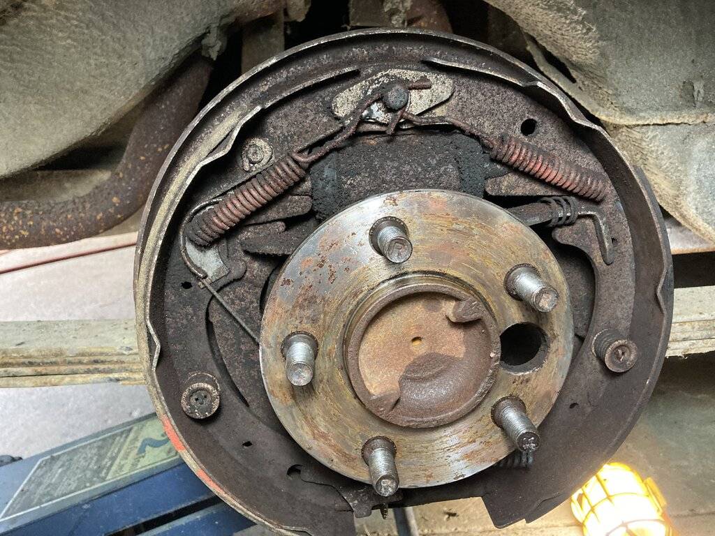

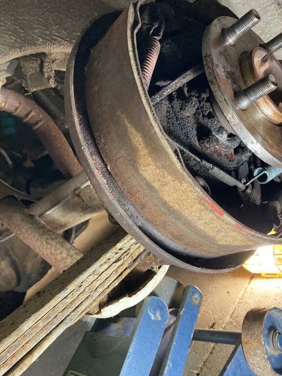

So, here is want I found today. First of all at 78 yrs. I had brain fade. I used a floor jack to lift the tire, but could not get the tire out from under the fender. Then the light bulb went off. Get the bump jack from the trunk which of course lifts the body. Problem solved. I found the brake shoes to be stuck to the drum in two rusty spots. See pics (I like pics). Thanks for all the comments.,,,rsh1966vip
