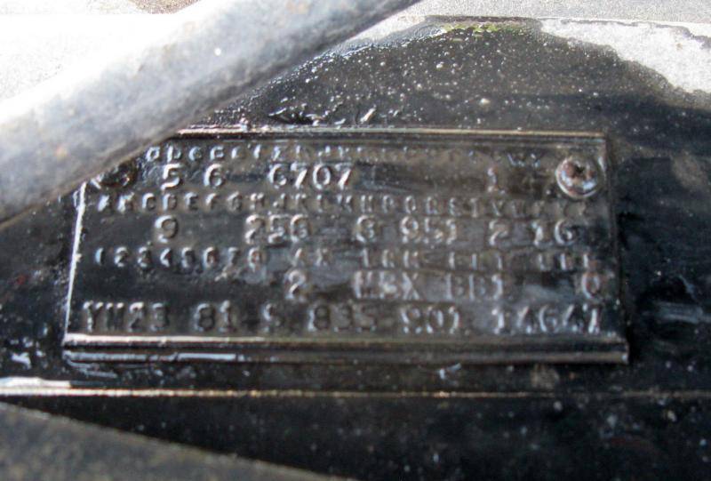

Just need a bit of help from someone who knows. I have a 1967 Crown Coupe I am completing for summer 2015.
I cannot fully decode the fender tag and if anyone can help me with the "unknown" options codes shown below it would really help.

thx. i do have the buildsheet but i havent found a source yet to decode it. if you or anyone can point me to a good buildsheet decoder that would also be helpful. thx again.

CAR: Chrysler Imperial 2 Door Hardtop
ENGINE: 440cid 4-bbl V8
TRANSMISSION: 3-Speed Automatic
TIRES: Unknown tire code -9.15 X 15 Rayon Good Year 3 band white wall
BUILD DATE: September 01.
AXLE: 2 Unknown Axle Code -2.94 ratio w/8.75
INTERIOR: Black Bucket Seats.
PAINT: BB1 black
OTHER: I think I see a Q here and if so that's a horizontal accent stripe in medium red.
MOLDINGS:
ABC OPTIONS:
D9: Front Disk Brakes
H2: Power Locks
J5: Unknown Option -LH & RH 6 way power bucket seats.
K8: Power Windows
N8: Rear Window Defogger
Q9: Sentinel Lighting
R5: Unknown Option -AM/FM search tune radio
S1: Air Conditioning
V2: Unknown Option -still unknown
X1: Tinted Glass (all)
Y6: Black Vinyl Top
abc OPTIONS:
b5: Rear Arm Rest w/ Ashtray
d6: Unknown Option-rear seat speaker
g6: Unknown Option-Bumper reveal molding
h7: Fender or Hood Mounted Turn Signal Indicators
j0: Tilt/Telescoping Steering Column
k7: Passenger Outside Manual Mirror
u1: Sold Car When Built (Somebody Ordered It)
I filled in all but one of your blanks post up a nice, big and clear pic of the sheet and a pic or three of the car.

Anyway, I will post a pic of car and buildsheet shortly. This resto is frustrating me a bit as I bought this car "from a distance" and it turned out that it wasnt accurately represented. If i got it from an FCBO member all those years ago, hey its cool as I'm a big boy and usually know what I'm doing, but I probably should have gone to see it before buying it:whew:

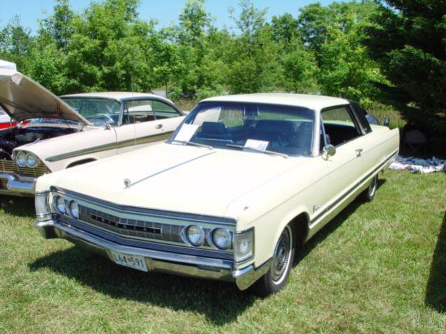

buildsheet and a couple of photos. i also have the Certicard showing the original owner (actually was quite a prominent company in Augusta GA, home of the Masters).

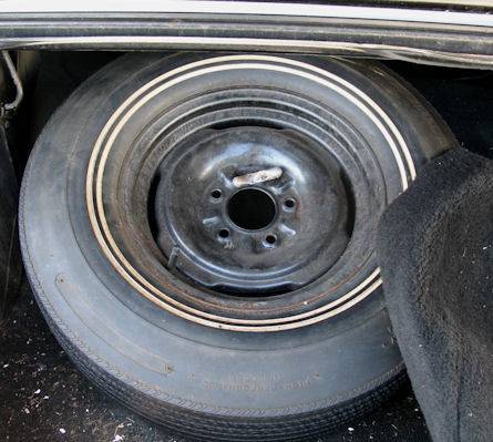

the spare in trunk seems original..is that a "three band" whitewall, or the vintage photo shot at the below? i may be answering my own question, but expert opinions from people smarter than me about these cars still matter

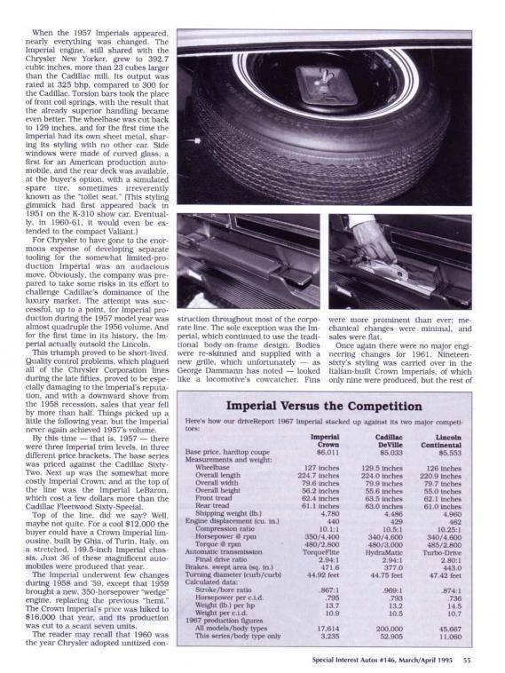

My spare and another active member with a '67 both have the original spares and are both triple stripes as pictured.

We are pretty sure that the three stripe pattern is the factory pattern for '67. Or at least one of them.
Your spare may be original. If you look at the literature on the imperialclub.com website, some of the pictures appear to be two-stripe, but it's hard to tell. So there may be an early-build thing going on. Do you know when it was built? If I'm reading your data plate translation right, you have air, but no Auto-Temp, right? If so, that's good, since it will be more reliable. But to the date of build, Auto-Temp was a late-year introduction. So if you have it, it's not an early build.

I found this car in Oklahoma about 9 years ago..the "old fashioned" way in the Auto Trader magazine i picked up on a trip to Tulsa. Car had been in OK since early 1980's. The company that owned it originally sold it in Georgia in 1972, so it has a decade of its life i dont anything about.
I am in contact with the family of the original owners and they are looking for pictures of it in use, and hopefully a few taken at Augusta National Golf course in the late 1960's.
Maybe something will turn up in that search..a 40 yr old Arnold Palmer standing next to it or something:yaayy:

I saw some of the period advertising material on the Imperial website and it looks like "two-stripe" whitewalls were also available at introduction. See magazine ad photo below.
I think the steel wheels are the "flatter" faced ones as you said, and my car has lost two over the years. if anyone knows where I can find a couple of correct steel wheels please let me know if you get a moment.

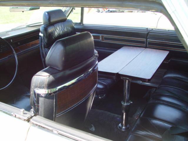

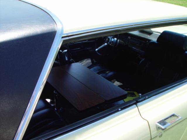

Could you get the Director's table in a four door?
No Google images showed up.
Imperial Club site says it was only available in the Crown Coupe. I presume those folks are correct on this point. Plus, they had this neat info too on options (also shows Mobile Director only in Crown Coupe).
