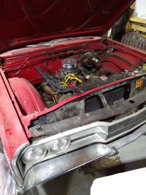

Here is some more pics. I kinda gotta the old girl cornered and it's a bear to get it out for now. Underbody is in good shape, no rust.
After I got it I had radiator re-cored and put a new gas tank in. Got it running and actually drove it about 10 miles to my new house. Guy stopped me and wanted to buy it right there. Exhaust needs to be replaced, it rusted a hole in it from sitting so long. It needs new wheels and tires as they have been on there since '74. Top and interior will need some work, top mechanism works.
Which engine and how long has it been since it has been started? There is a big difference in value between 383 and 440 equipped cars. From what I can see of it, this is still a nice car, appears to be 383 with drum brakes. Paint is still usable as a good driver, as is the chrome, could use a new top and the aforementioned exhaust system, will probably also need a full brake system overhaul, and of course tires. To arrive at a reasonable value, a nice Polara 500 vert in #3 condition is around $12.5k, deduct from that any repairs needed to make it drive.
