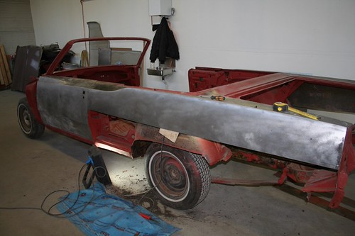

I would need some help with the measures of the body. The car is in the body shop at the moment and we are starting to build the trunk floor, wheel housings and the quarter panels.
The measure we would need is the distance between the quarter panel and frame beam OR at least the distance of the quarter panels, from side to side. As the whole rear end was in a such bad condition and not original, we don't know how wide is the body. Perhaps if someone would measure and take the picture of the place measured? For example a couple of pictures, one from the very end and one right after the wheel arc.

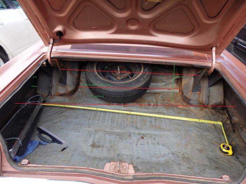

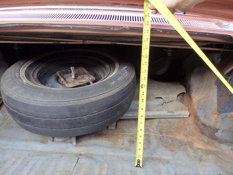

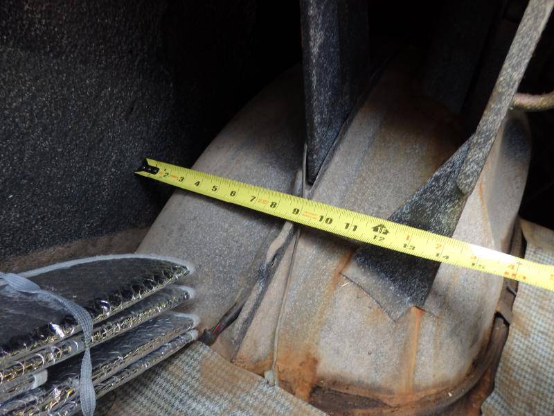

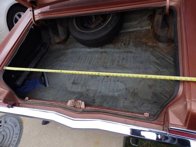

Howdy. Here are a few random pics and dimensions. Let me know if there are some other measurements needed.
Floor to roof lid, 19 in
Witch of trunk opening 53 in inside lip, 55 outside edge of seal.
Quarter panel and wheel well gap, appx 2 inches.
Trunk lid hinges apx 55 in.
