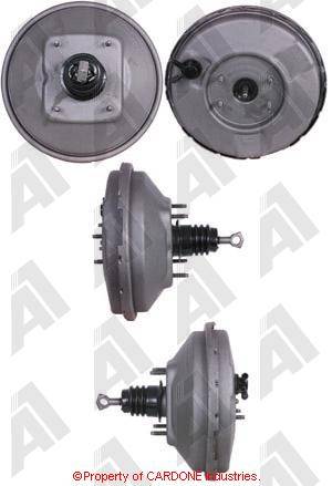

Does your car have console shift? If it does (Sport Furies usually do), then you can use the 71-73 single diaphragm disc booster. They look like this, and while not technically correct, it will bolt up and work - you may have to do a bit of modification to the backing plate behind your drum brake booster. They are fairly easy to find from parts stores.
71-73 Disc Brake Booster

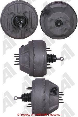

However, if you've got column shift, you're pretty much stuck with trying to find an original 65-68 Bendix dual diaphragm disc booster. They're hard to find, but they're out there.
65-68 Disc Brake Booster
