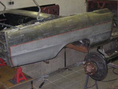

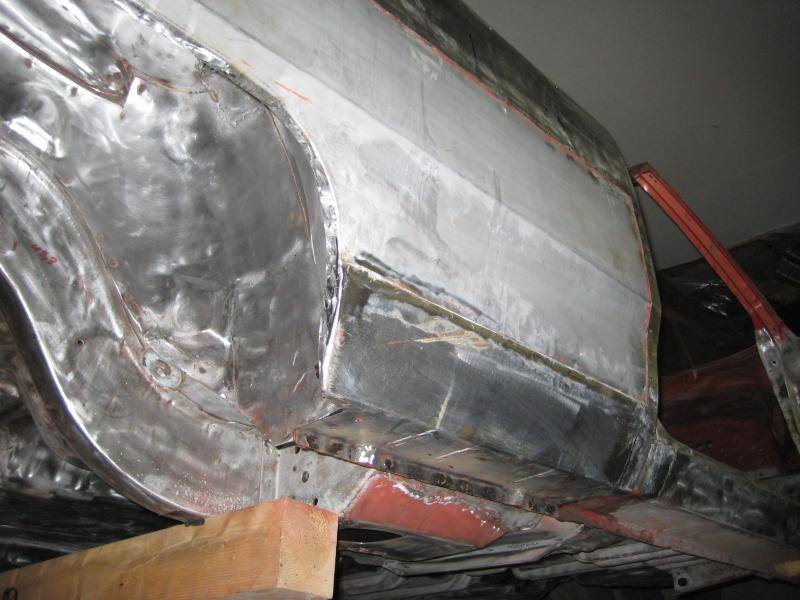

complete floor pan from firewall to trunk
both frame rails,rear panel in trunk,also replaced the hood,trunk lid(took 2 to make one),both doors .front and rear inner fender wells.
Metal work like this is like art for me. You, sir, are a true craftsman. You are the only man I've seen to be able to get those awful Sherman aftermarket panels to look right.

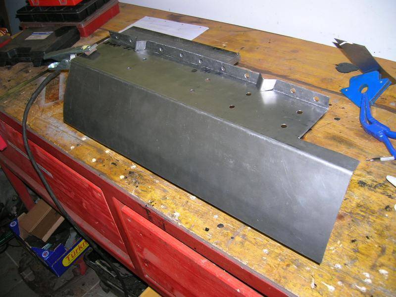

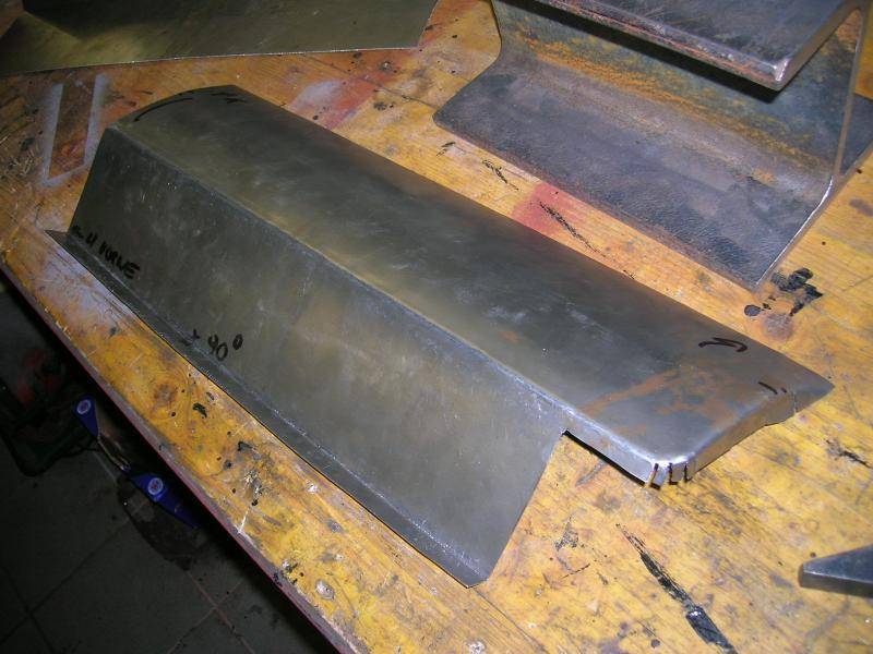

You are right, it took a long time to got the Sherman Parts right:
I had to replace the sheetmetal in front of the wheelhouses...
That is EXACTLY the piece I screwed up horribly. Same cut lines and all only it went down to the rocker in front of the wheel opening. The factory bonded that area to the inner rocker. I couldn't believe it. My hat really goes off to you. Yah, it was the same Sherman piece...
