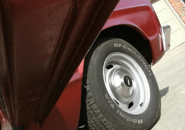

Don't have good pics to help you, but here's what I've got.
The 255-60s on the rear (years ago), and hte 235-70 on the front (currently).
Obviously, you can research the dia of both sizes and have some reference from that.
The 255 looked very purposeful on the rear., but the sidewall looks a little more 'abrupt' due the rim being only 7" wide.
the 235-70 looks more normal, nicely-rounded sidewall, and fills the front wheellip nicely.
Between these 2 sizes, though, I'd say you'll be OK with either size. I did NOT run 255-60 on the front, though, I had 235-60. With a 255-60 on the front you'd better check for adequate brake hose clearance.
The 235-70 would be my current choice, except that preventing me from latching my pass-side FS latch has me flummoxed on that size -- it does not seem like it's a too-large tire for a C-body.

View attachment 476902[/QUOTE]
