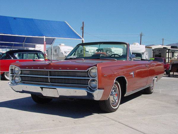

Due to the Chrysler a-symetrical rear axle position on the leaf springs (forward of the center of the main leaf's middle) extended shackles did LITTLE to raise the rear of the cars. It just deflected the rear of the main leaf downward. Notice the relationship of the bottom of the rocker panel to the center of the wheel covers. Plus that the rocker panel should be parallel to the road surface.
