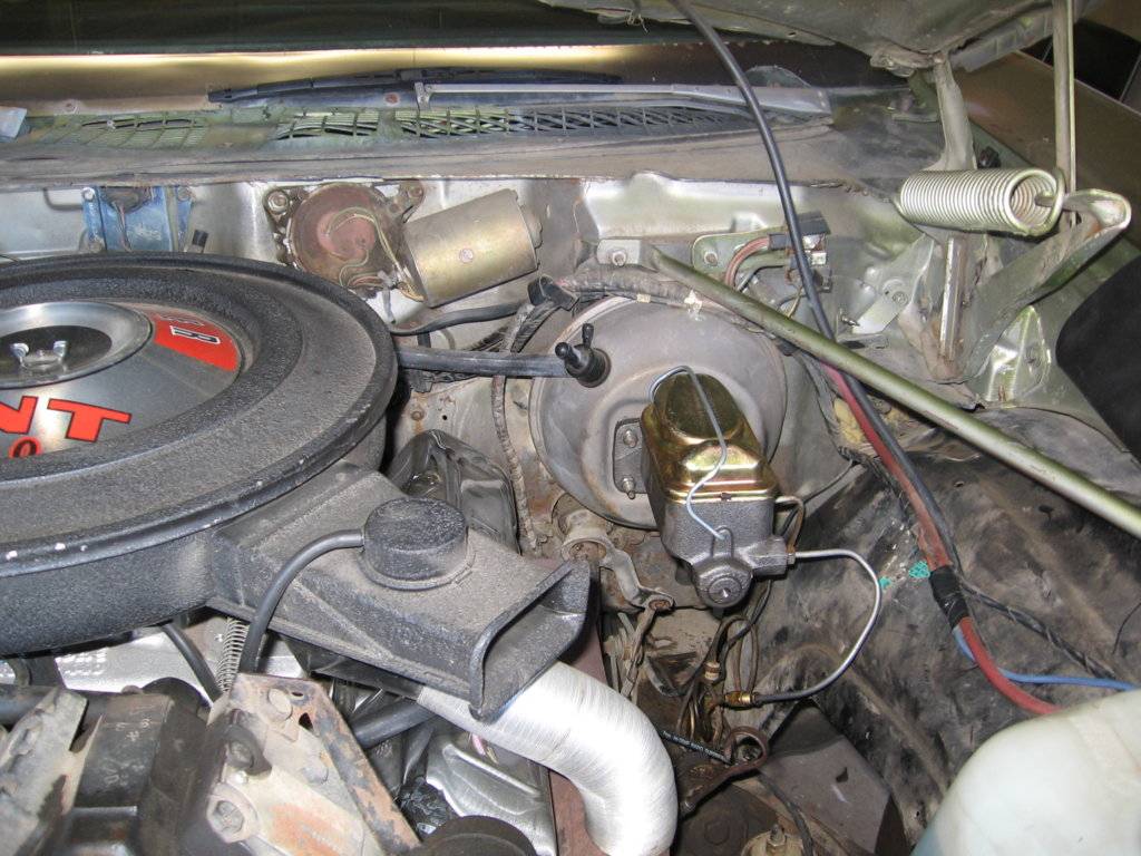

I had a similar problem. All power through the alternator was gone, running on the battery. I replaced the voltage regulator; took care of the problem for 6 months. Same event happened two weeks ago; it was fun driving home at night with low lights and non-working signals. This time I replaced my alternator; no effect. Thinking it was not necessary, I replace the regulator again; no effect. I was baffled.
I switched to looking at the cables coming from my battery. I actually found a corroded connection; when I jiggled it the car shut down. I corrected that; no effect.
When I say no effect, I mean my ammeter displayed a discharge, every time.
Still confused, I started jiggling the connections to the bulkhead connector of the fire wall. I simply jiggled them, all of them. Looks at the ammeter, viola! It was charging!! Apparently, one of those connectors is bad; I don't know which, but I'm glad I didn't toss the regulator I bought 6 months ago. I expect it to happen again. What I don't know is, should I replace that bulkhead connector, or just the wires?
When I say bulkhead connector, I mean the thing to the right of my booster with the 4 wires going into it.
This thing? That's not what most refer to as a bulkhead connector, that's the start relay.
This down under here would be where your bulkhead connector is.
If the connector to the starter relay is loose or corroded (smaller of the two red wires), that will kill power to the bulkhead connector. I would suggest running a second wire of 10ga from the hot lead of the alternator to the big terminal of the starter relay, be sure it has a fusible link. That will reduce the load on the ammeter by about half so that it does not burn out. Fried ammeters on older mopars were common and could cause a dash fire.
