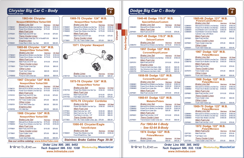

My right pass site hard brake line is rusted and the fitting has broken off. How do I measure for the size of hard line? Or does anyone know the proper size?
You may be in luck in that Inline Tube has a pattern for your car and you can order them prebent.
This is a link to their catalog page, go to the Mopar one: Catalogs
They didn't have what I needed for my Monaco, but after wasting a decent amount of money on bare tube I ruined trying to bend it, they made me some exact copies of my bad lines for a very reasonable price.
Those are some decent prices...180 for stainless....complete set....not bad. I have the 67 newport as well.
