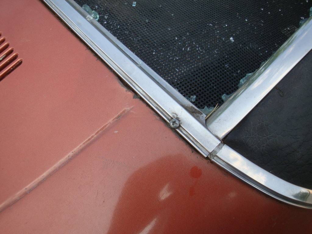

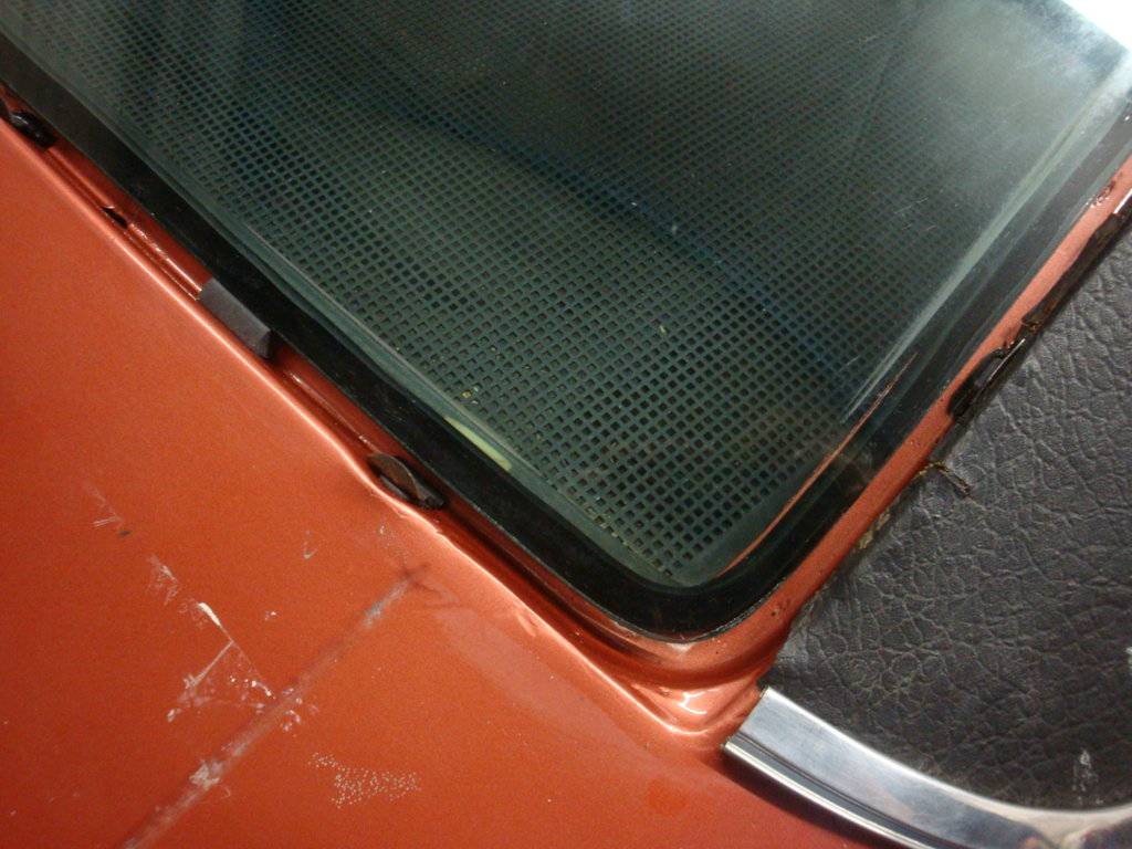

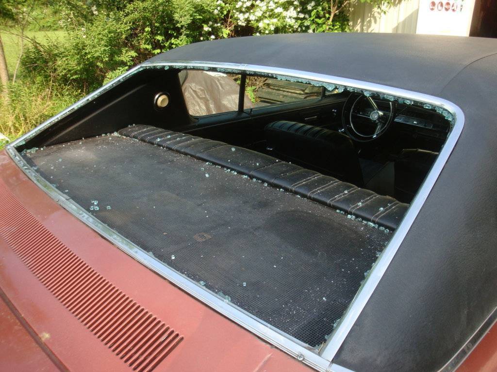

Unfortunately, I didn't take any photos of the rusty window channel before I cleaned up the rust and painted it. Someone before me buggered up the mouldings and even managed to dent the dutchman panel when they removed them. The screw that they put through the trim was touching the glass and led to the shattered window.
Jeff
Those are excellent pictures. I measured my channel depth to the bottom of the glass and its about 1/2" at the bottom...1/4" at the top...my trim is flush to the glass at the bottom but not the top...there is a gap there. I think the 3/8 is correct. I know my lower clips are toast...and the panel needs some rust repair..not bad but a good delay.

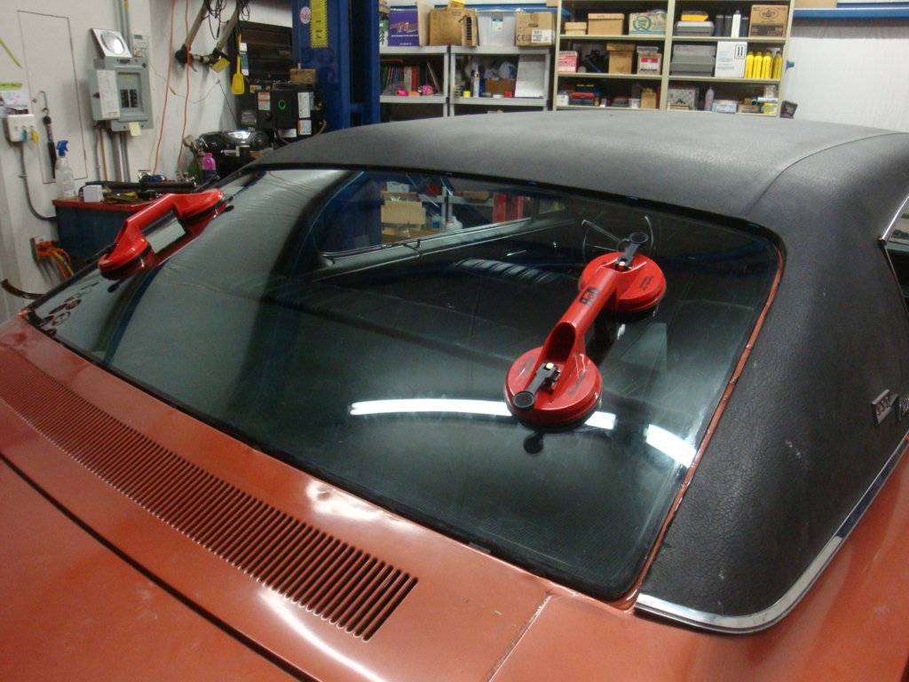

Not hard at all. The butyl kit comes with the rubber spacers. You put the tape on the glass and stick the glass into the opening and push on it. The butyl is fairly firm, so it's not going to squish out like urethane can.

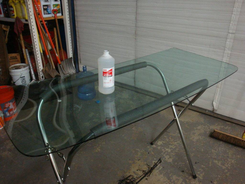

I would skip the primer. It's more suited for fully cured paint. It may lift fresh paint. The butyl will adhere fine to your fresh paint. It's not needed on the glass either. Just clean the glass with alcohol.

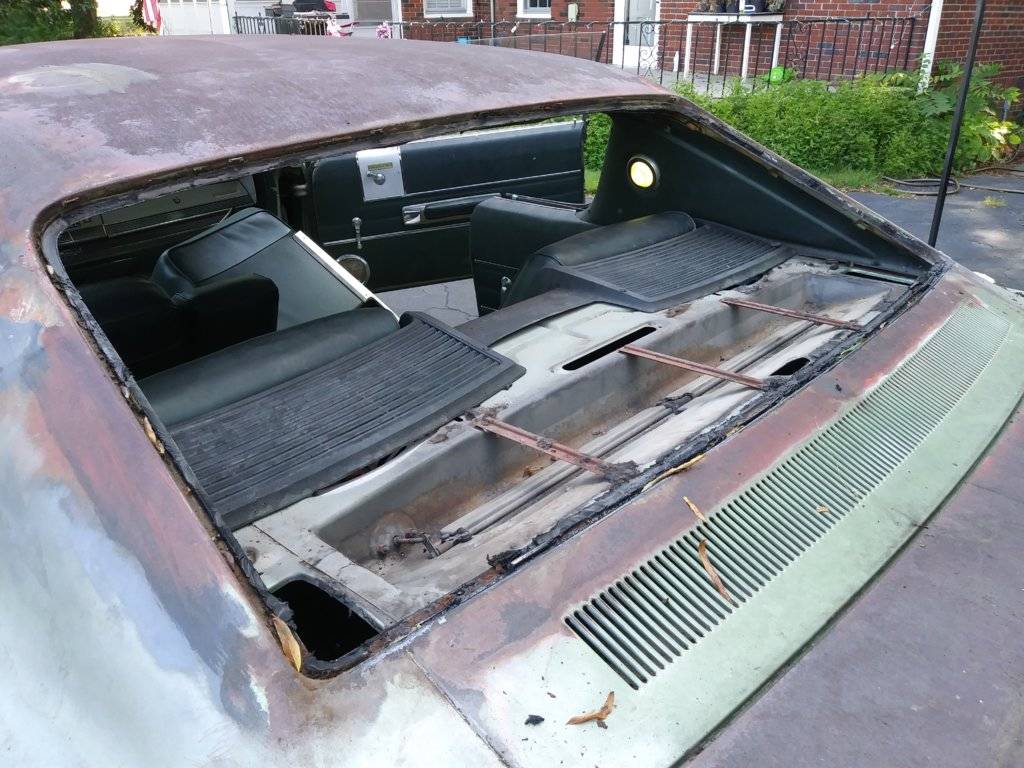

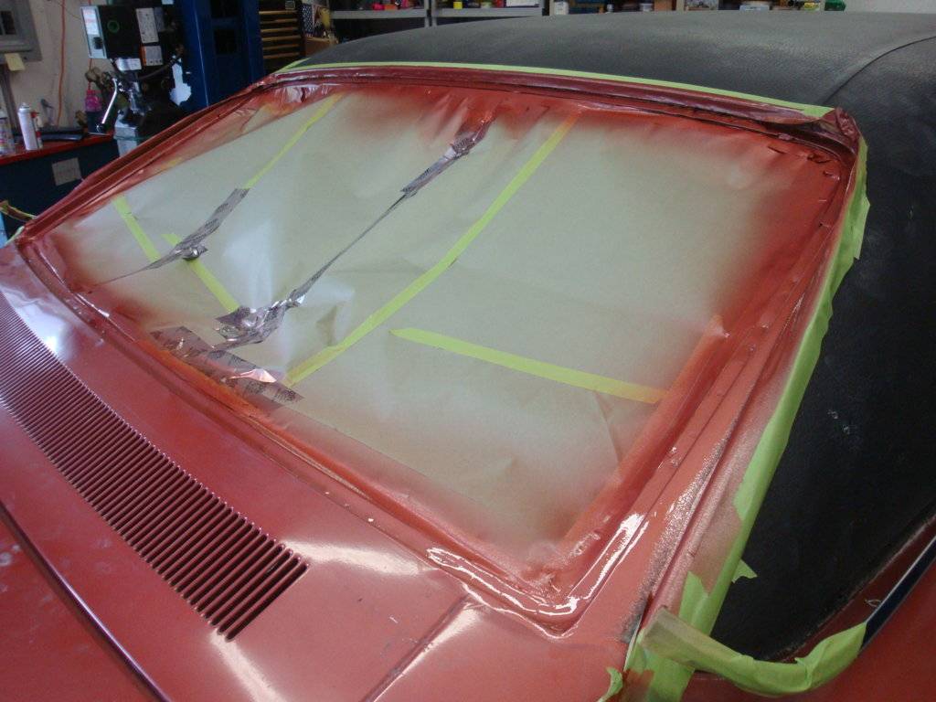

Got it out...time to clean it up and fix the rust. Going to brake the small holes shut...might add those drains. Going to paint the frame and install the glass...I will finish the roof later and blend into the painted frame.
Doesn't look all too bad, rust-wise.

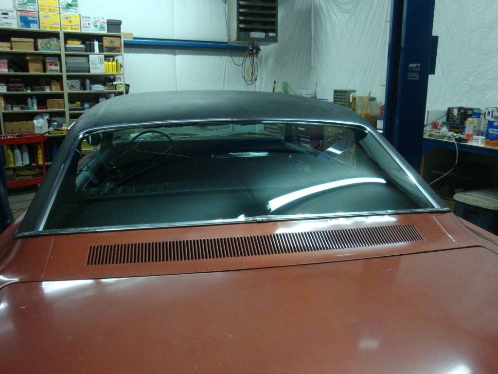

As you can see in my pictures of the Newport, I used the shorter clips along the bottom.
