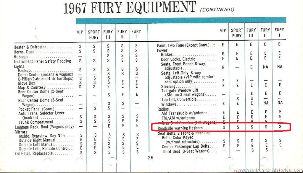

Here's pictures from the 1967 Fury dealership data book showing a 1967 Fury dash. I circled the "roadside warning flashers".
From: The 1970 Hamtramck Registry - 1967 Plymouth Dealership Data Book - Fury
More from:
The 1970 Hamtramck Registry - 1967 Plymouth Dealership Data Book - Engineering

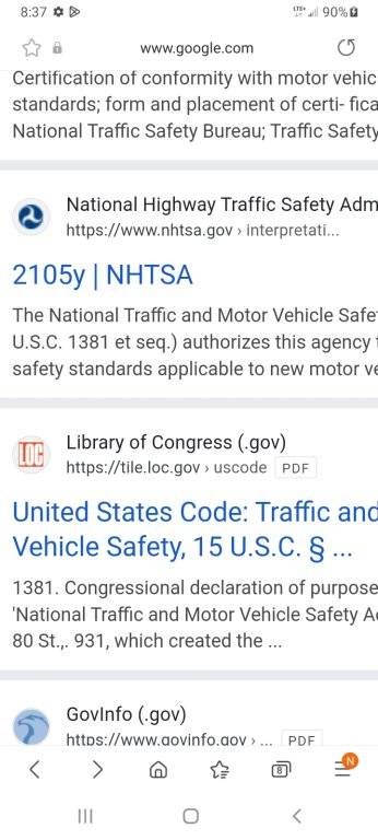

I don't have a direct link. I found it on the Library of Congress site. I understand that you have hazard lights in your car. My point is, because you are not required to have them they don't have to work.

I did find National Traffic and Motor Vehicle Act 15 (U.S.C.A. 1381) and really, it's mostly legalize for the bureaucrats and doesn't specifically call out any of those requirements. At least that's the copy I saw, although I may be looking at the wrong section.
