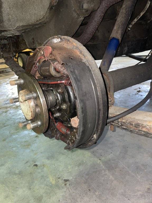

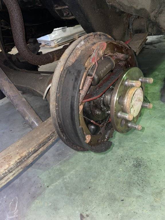

I have a 1967 VIP Fury. The front brakes are 11 x 2-1/2” and I can’t seem to find shoes and mostly drums in that size. New drums I can only find from Bendix and Napa are for 2-3/4 or 3” size for a very expensive price. Question, Will the 3” shoes and drums fit, if I just replace those parts? Assuming I can’t find the 2-1/2” size.

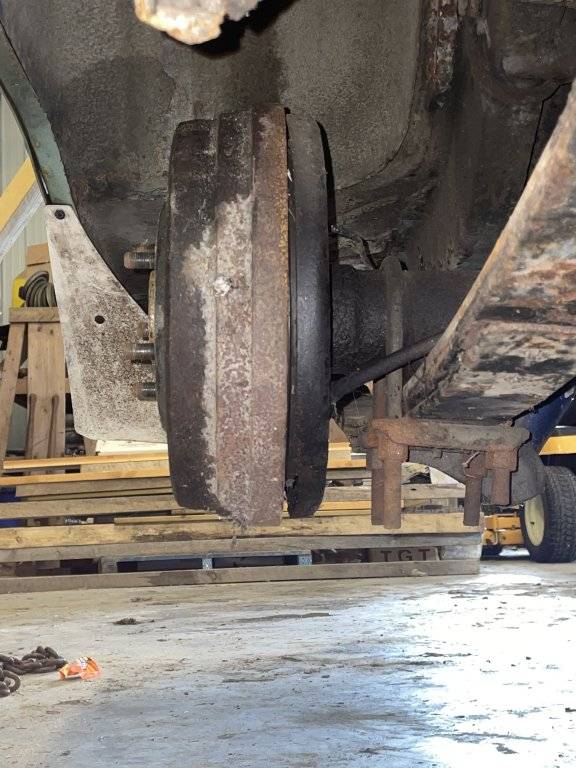

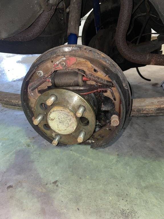

The rear is my big problem. Someone replaced everything including the backing plates to 11 x 2” size. But they don’t fit, the drum doesn’t go all the way to the backing plate so the shoes ride about 1/2” outside the drum. I figure 11 x 2-1/2” shoes and drums should fix the problem. But I’m not sure. Any help is appreciated.

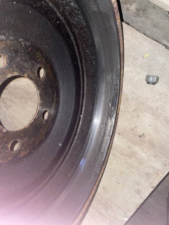

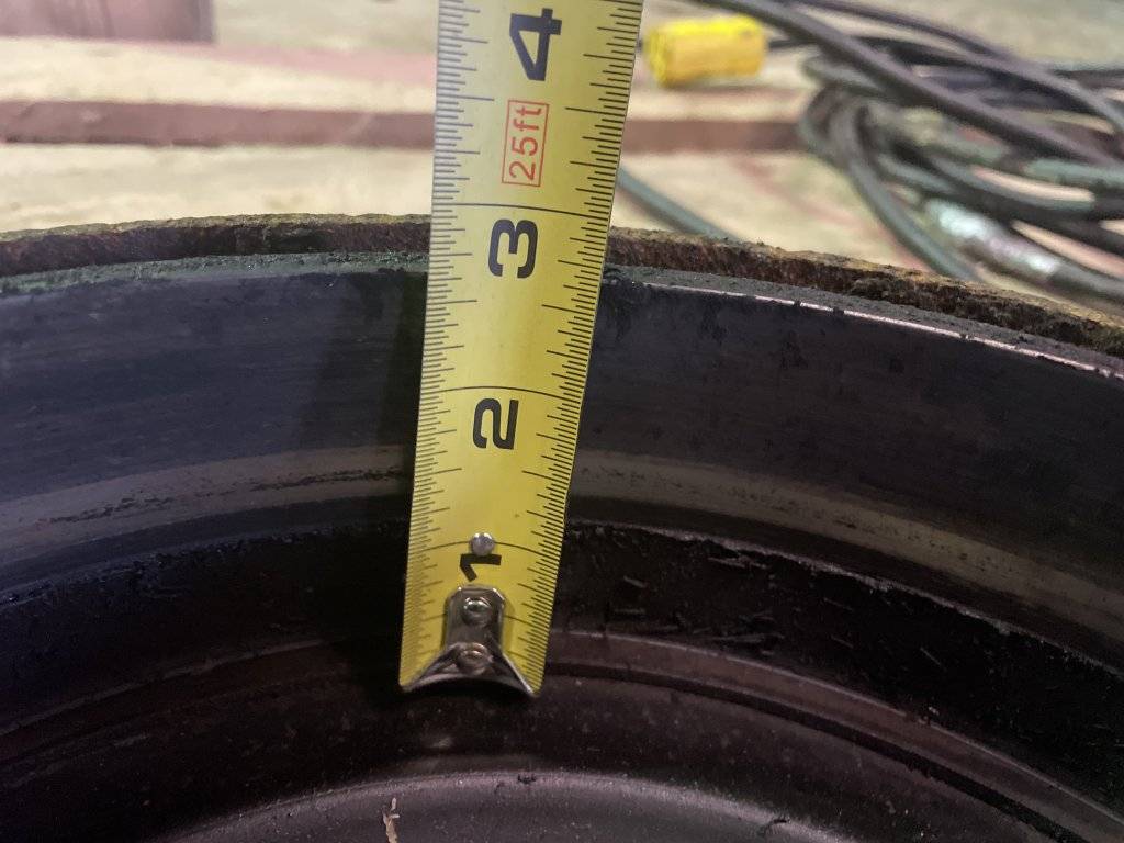

FURYGT. The fronts I measured the material width. Now that you mention it, that might be smaller than the shoe itself. I’ll recheck and proably there 2-3/4” because they ride perfectly in the middle of the drum.
The rear drum fits perfectly on the axle. It’s just offset so the drum doesn’t come close to the backing plate. So the shoe sticks out 1/2” and obviously the shoes don’t ride in the Center of the drum machined face.
Does 2-3/4” front and 2-1/2” rear sound right for this car? It’s pretty much an unmolested car from what I can see.

I’m beginning to suspect the backing plate is for a 2-1/2”. Does anyone know how to tell which backing plate I have and if the 2” backing plate is available.

When it comes to MOPARS, never say never. It is possible that your car was built with 2 1/2" rear drums or someone may have done a swap.
