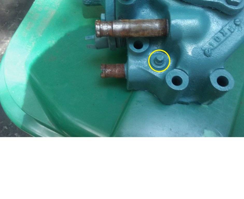

I kind of like the "Cold" and "Hot" idiot likes on my 68 Chrysler. But I also want a temperature gauge. Is there any way I can have my cake and eat it too?
Really? I didn't realize -- that's cool. I knew there was a second hole for the oil pressure but not for the water. Thanks!
What temperatures do the idiot lights actually engage at? I’ve always assumed if it got to the point where the hot light came on - you’re screwed anyway.
Those are the nipples for the heater hose.JCT, which thing should I be looking at? The short unpainted thing or the long unpainted thing?

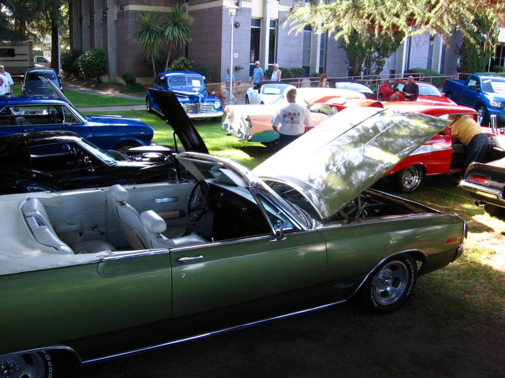

There it is! My "Hot" light did come on in my Newport.Here's an idea . . .
By observations going back into the middle '60s on our '66 Newport and other similar factory a/c Chryslers (and from techs who worked on them), if the factory cooling system is clean and has a good radiator cap, you'll never see the "HOT" light illuminate unless . . . there is a leak and part of the coolant has leaked out, a failing water pump, a failed thermostat, or a failed fan clutch. Now that the cars are now much older, these "HOT" modes might also include a cooing system with a lot of "accumulation" in the water jackets that needs new freeze plugs and a good flush when they are removed for replacement.
