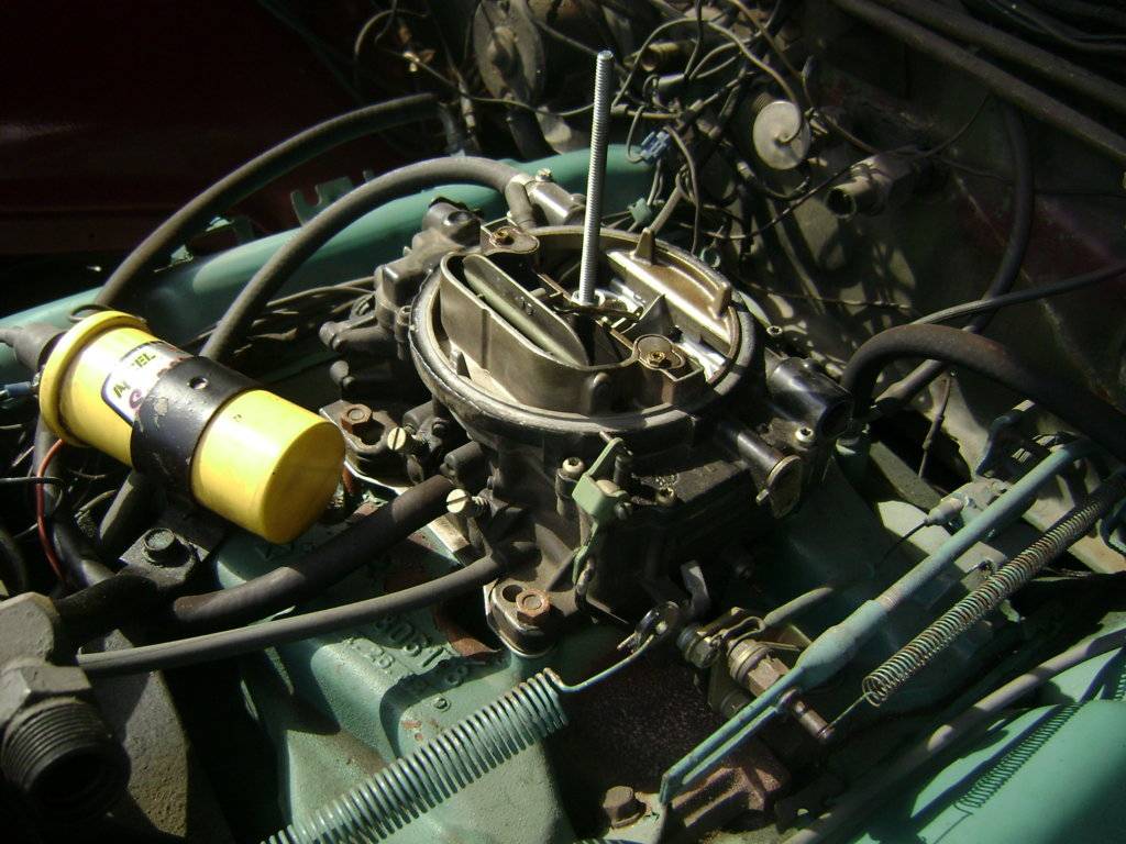

    When I had my 68 NYer with 440 I installed the Mopar Purple cam shaft 260/260.
    Worked great with stock convertor,750 carb,Pertronix ignition,3.23's and TTi 2.5 exhaust system
