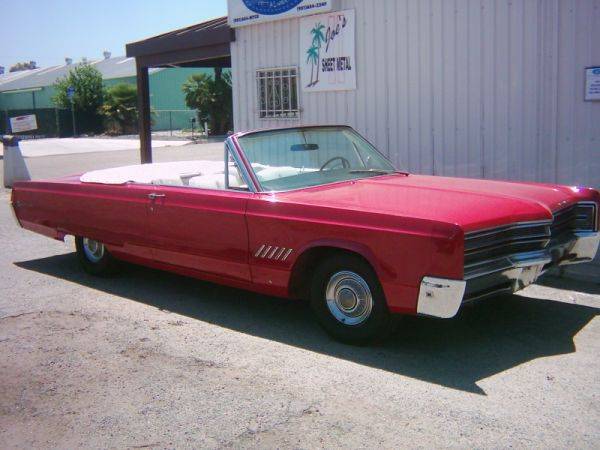

I would say Robbins. I have used them a couple of times, including my 68 and have always been very satisfied. 68-1.jpg

I would say Robbins. I have used them a couple of times, including my 68 and have always been very satisfied.View attachment 3642
