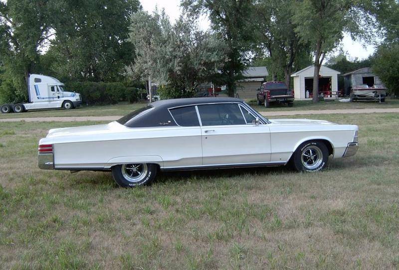

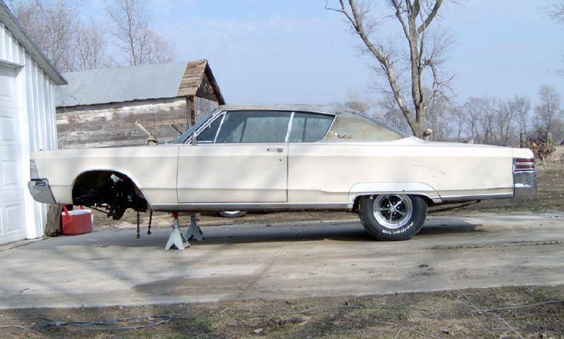

Front wheels are 15"x7" with 225/70/15 and the rear are 15"x8" with 255/70/15. There are no rubbing issues, and the wheels are from Wheel Vintiques.
I believe the 255s are 28" tall and the 275/60/15s are 1" shorter and 1" wider. I have been told the 275/60s will clear but I haven't had one on any of my own '67-'68 Chryslers to be certain.
