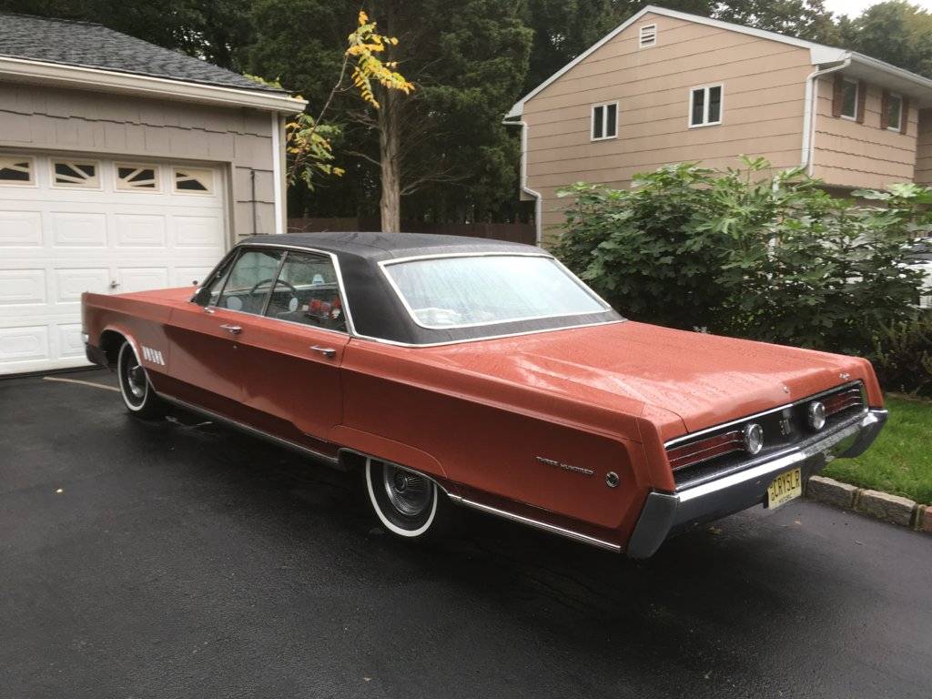

I read your request of Bronze Turbine.....And I thought I would post these, though it has nothing to do with the AC question...damned stupid shop!!!!
This Turbine Bronze '68 300 is un-restored and was purchased new by my folks in 1968 June. I was 11 and remember seeing the car pull into the driveway. It's unmolested and all original with the usual wear and tear but despite some of that it shows well. Dad was a Depression Era guy so this is a 440CID with crank windows and NO A/C....runs beautifully and fast as the devil! I have had it since 1974.

THANKS for sharing the photo of this bronze beauty. 4-door 300's aren't real common, but I think flatter the slab-sided styling, especially with the black vinyl top. Crank windows break down a lot less than power windows do, and the cowl vents on these cars ALMOST cancels out the need for AC.
Thanks! You know what's interesting, Dad traded a '65 Impala for this car and it took 3 months for delivery. WHen he brought it home he said this was a "sport" model and I'm not sure if he meant "SPORT" as in fast....b/c it IS! OR if he was referring to the "300 Sport" model vs. the former letter series. Whatever, it was a few years later that I saw an ad in an old Popular Mechanics, 1957, for the 300C and I was bitten by the MOPAR bug, C bodies only. I have had a number of them....this one is hard to beat. Do I wish it was a coupe? Sure? A convert? Absolutely....but they did a great job on the roof line and true, with those cranked vents open, at 80+mph you don't need A'C! Thanks for your interest. :thankyou:
