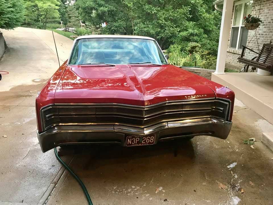

I don't have access to the car and my parts guy is asking if I need 2" or 3" brake pads
on my stock '68. It looks like the rear drums are larger than the front. Do I need a set of each size?
TIA
Photo for attention.
All 440 '68 cars had 11x3 front drums with self adjusters as standard equipment.
Tow package gave you 11x3 drums on all 4 corners but with no self adjusters.
1968 Chrysler imperials had disc in the front ( buddy brakes) drums in the rear 11 x 3
