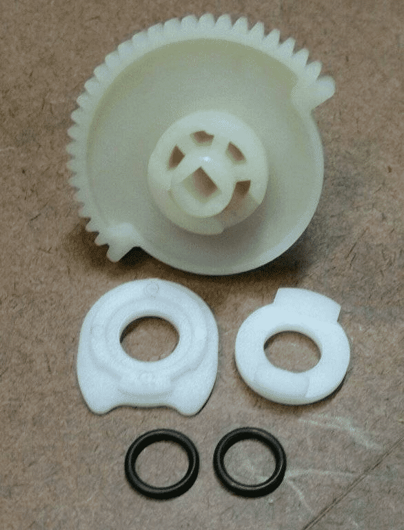

Sorry Big John, the part(s) I need are the actual gear motor that turns the shaft that opens the head lights. There is a gear inside that has stripped.
Post a picture of the gear set you have, there are different ones. I just ordered this one from an eBay seller.

You know... I figured that they were all the same. I see the repops are said to be '70 up, so now I don't know.
I have seen where the gear can be turned 180° and the good section used. That may be an option for you.

The difference is that the hole in the center of the gear (and the rod that goes through it) was changed from a square cross section to a rectangle.
I'm assuming that the '68 is square and looking at the pic, that seems to be true.
If the short side of the rectangle is the same size as the square, you could shim the square to fit. If the square size is larger, a little time with a Dremel and file to open up the gear hole to fit.
