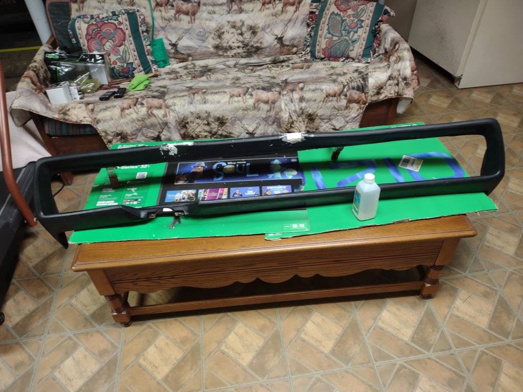

Im gonna try same thing to my 69 300. Dash was total disaster. Had to remove complete frame to the remove pad. Went the bondo route but gonna find material to recover while its out. 50% bondo just doesnt look right, no matter how smooth.

My 69 300 dash had to be totally removed to get to bolts that hold pad. The 300 has a wrap around pad and frame similar to the wrap around bumpers. The pad is one large circle.

I had one almost new in early 70s but had to get rid of it when they shipped me to asia. Finally got another one this year.
