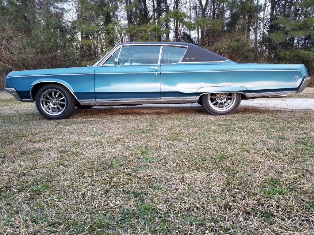

    [​IMG]
    Hopefully that helps, I used it to buy the wheels I had on mine...
    BRAND: RIDLER
    PART NUMBER: 650-8865G
    FINISH: GREY/POLISHED LIP
    DIAMETER: 18"
    WHEEL WIDTH: 18"
    HUB: 83.82
    PCD1: 5-114.3
    OFFSET: 0
    BACKSPACE: 4.5"
    [​IMG]

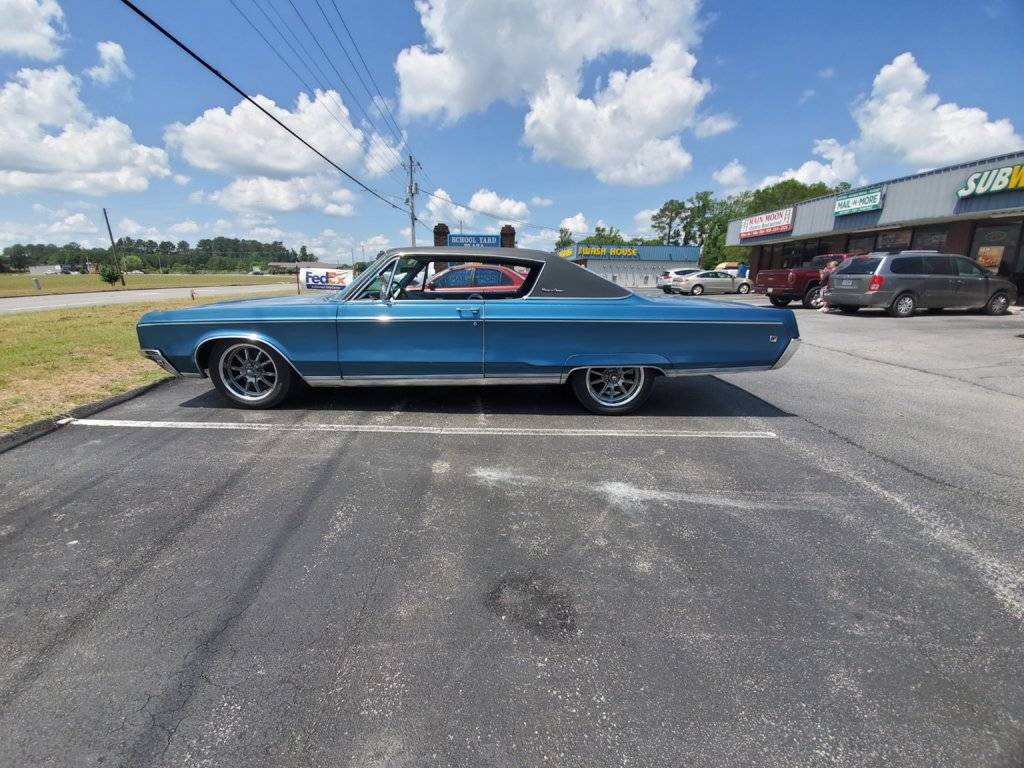

    Aside from the one I just posted? Here's a wide angle shot...
    [​IMG]

    Let me try it this way...

    Yea that worked looks awesome those are what I want for my 68 4 door Newport. Did you have any issues on the back tires. And the specs you put up was that all four rims and what size tires did you run??
  10. BLUPORT
    BLUPORT Carpe Diem Cras FCBO Gold Member
    Messages:
    1,463
    Likes Received:
    1110
    Joined:
    Dec 10, 2018
    Location:
    Eastern NC
    The fit perfectly, same size all the way around, with 235-55-18's

    What’s the wheel width in the back
  15. BLUPORT
    Messages:
    1,463
    Likes Received:
    1110
    Joined:
    Dec 10, 2018
    Location:
    Eastern NC
    All are 18x8
    • Agree Agree x 1
