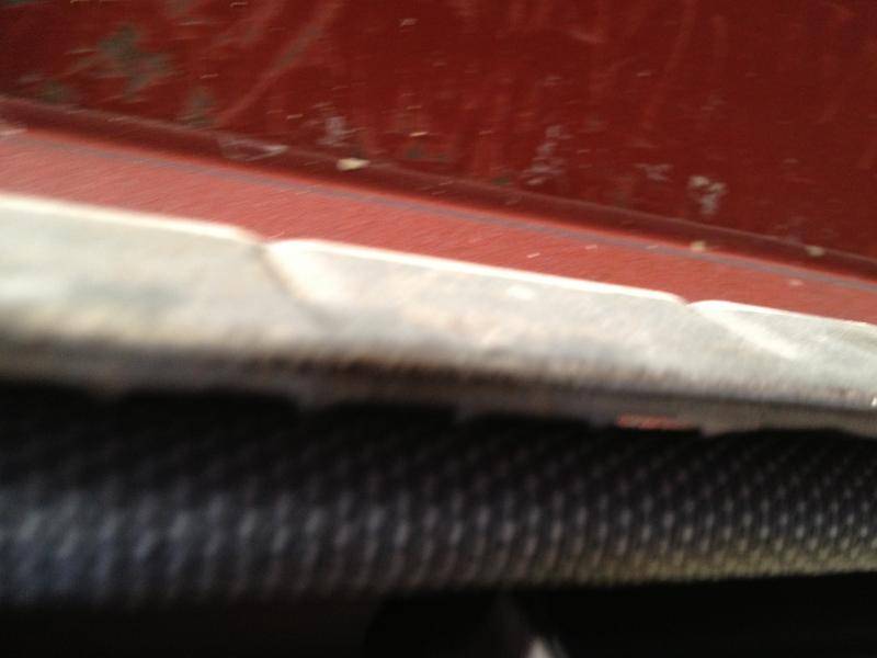

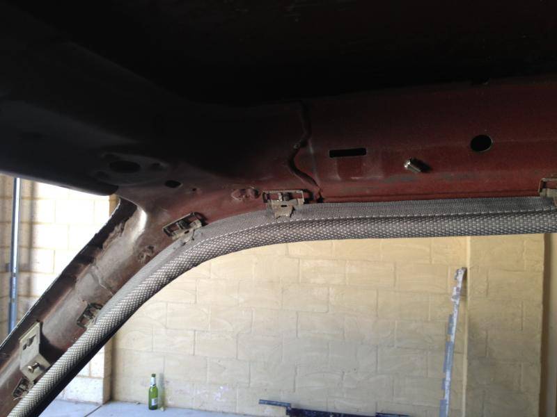

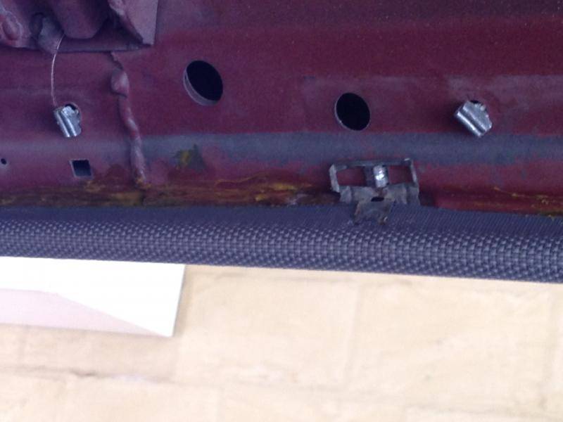

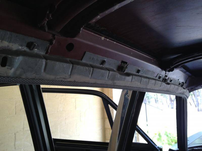

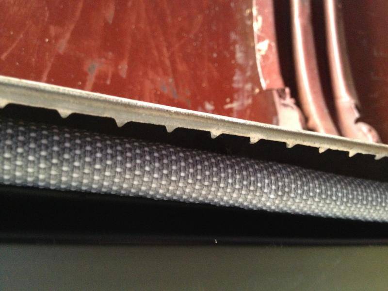

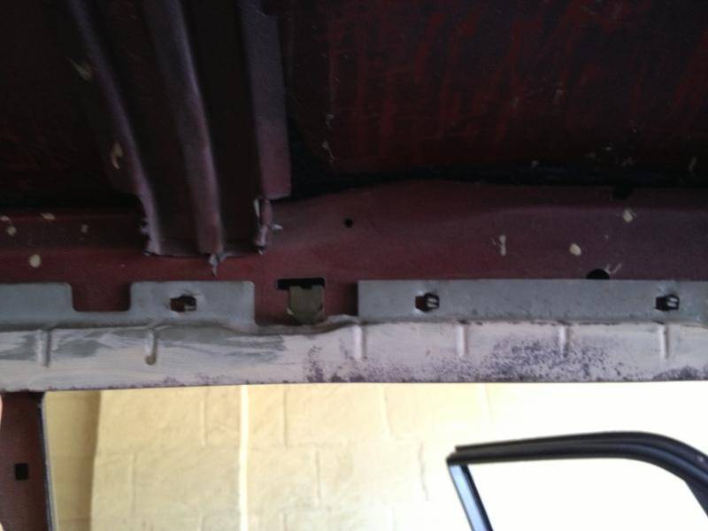

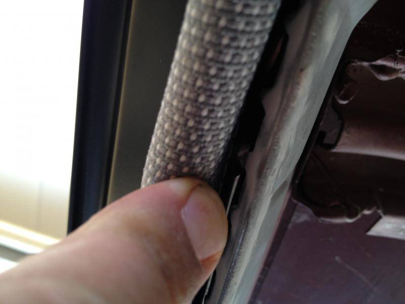

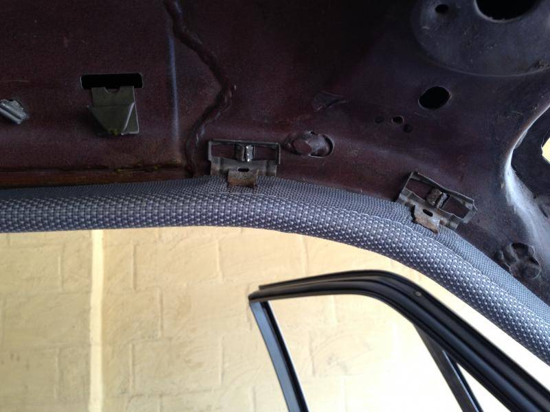

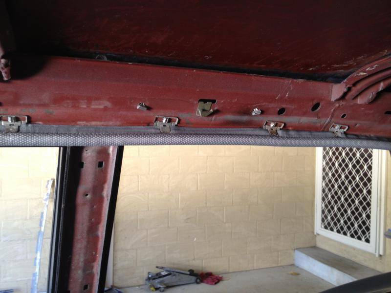

Windlace install pics
I t took me awhile to get the answers i needed about windlace installation not much availible online hopefully pictures will help someonelse.:sSig_thanks: to the members of this forum
