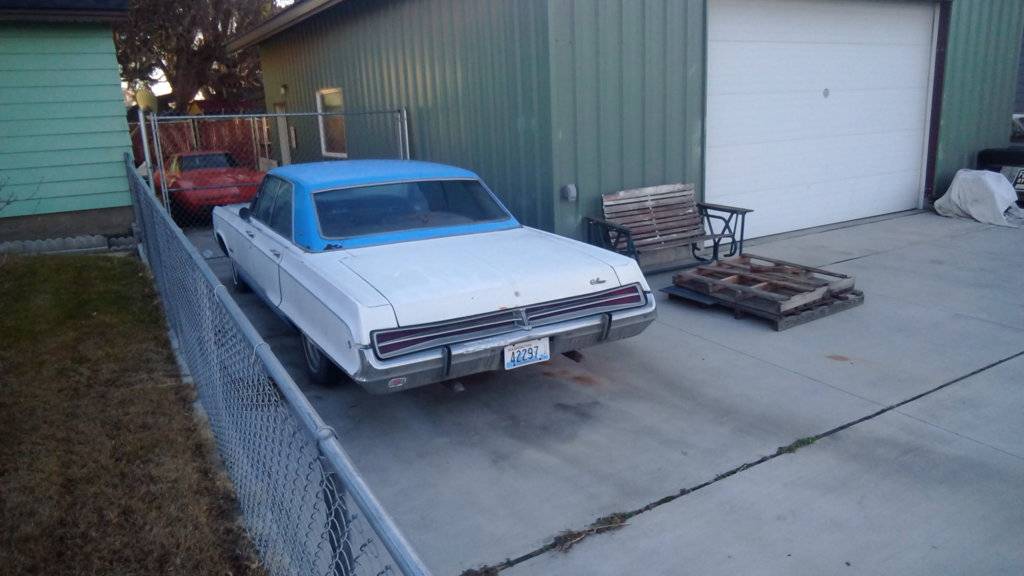

Hello fellow C-Body Brothers! Has anyone installed the 1970 Dodge Charger Flip open style Gas Cap, Filler Neck, and Gas Tank on a C-Body Car? I'm looking at doing this on my 1968 Polara Coupe. The tank Swap is what concerns me, mounting points for hangers etc.

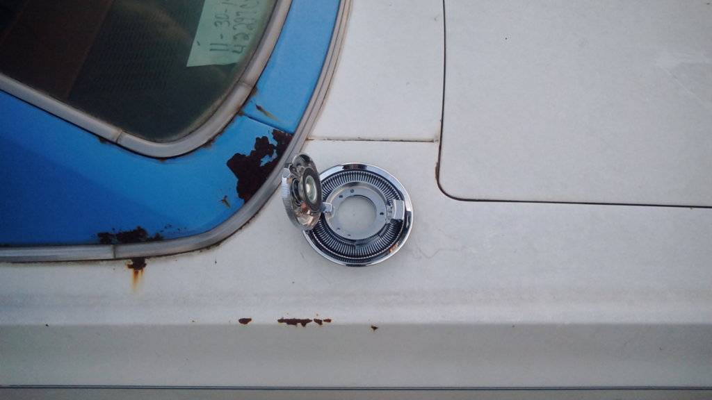

Hey just a big shout out THANK YOU! to all you guys for your comments and advice. I just turned out the lights in the shop, Tomorrow I'm doing it!!!! LOL!
Good Morning C-Body Brothers and Sista's! Just received the flip top gas cap parts from Vans Auto LLC. The 1968 Monaco 383 cu in, A-727 TRANS. This was my first resto on my Dads car which hooked me on C-Body's. Runs like a "Raped Ape" For those of you Kat's that dig the Jive! My 67 Polara which shares much of the same body style will receive this modification.
