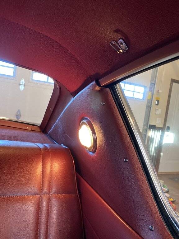

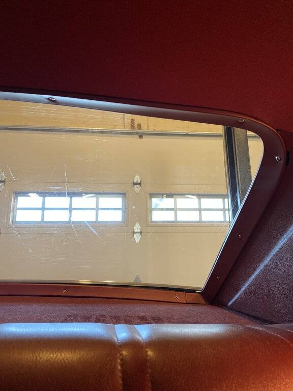

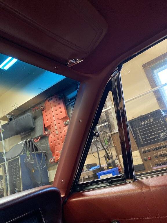

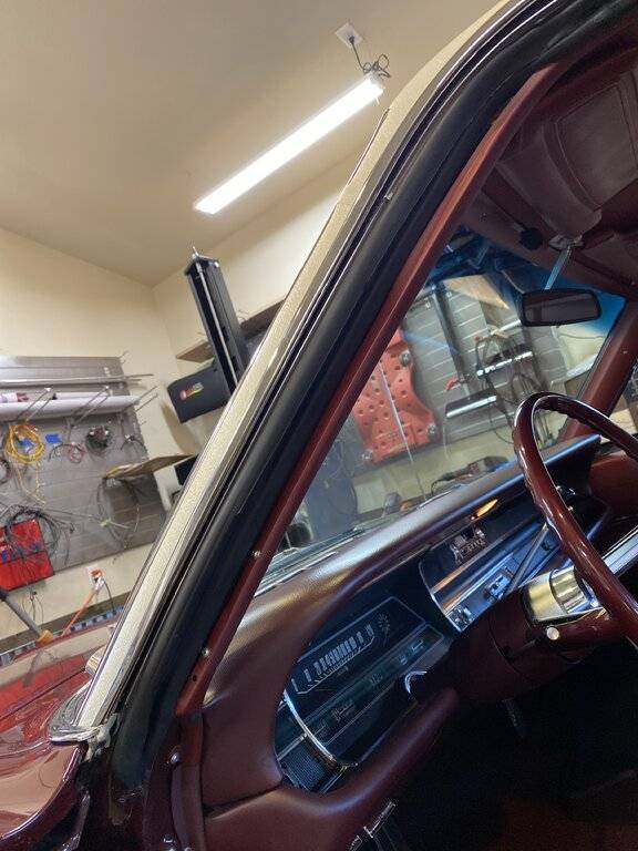

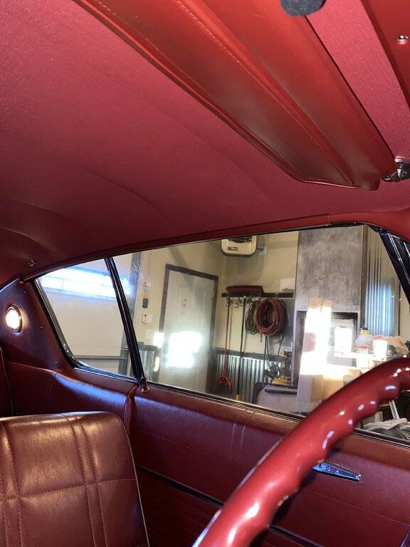

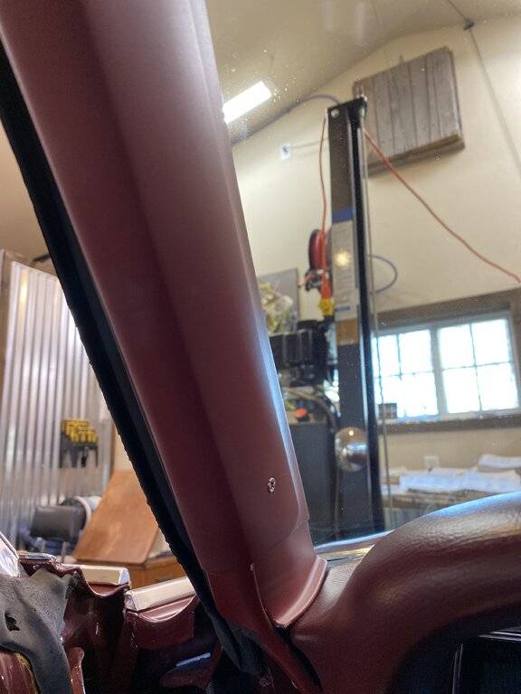

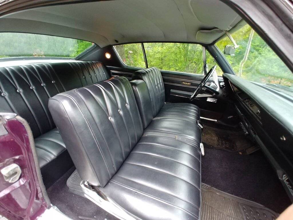

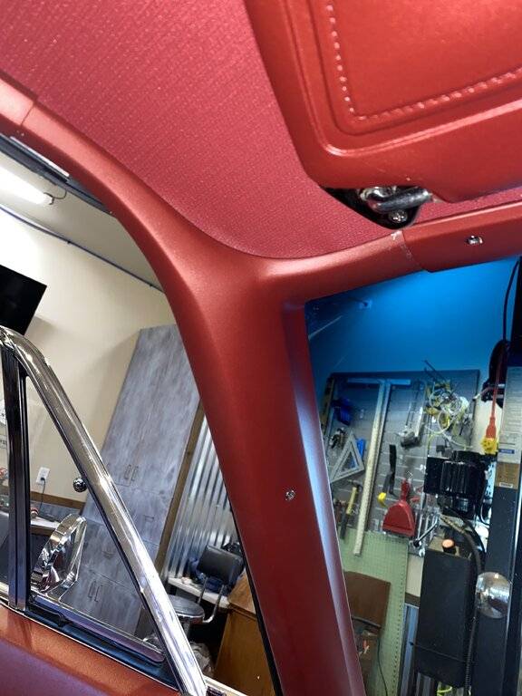

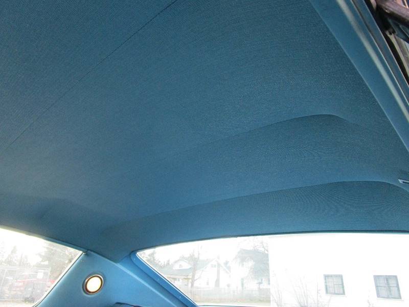

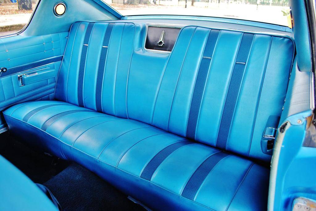

I need some good reference pictures of the interior metal trim. A pillar, along the headliner and around the rear window. Trying to put it back together. Thanks in advance.

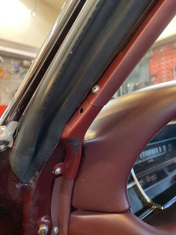

‘68 Polara fastop should get you started.
starting with the left front A pillar
This one’s a tricky SOB. It it is 3 pieces to adjust for dash height (bottom of A Pillar)
You wanted where the interior roof rail where it meets the headliner as well.
One screw in the front to attach it to the A pillar, otherwise it snaps into place and the rear is held by the sail panel. I don’t recall a screw back there.

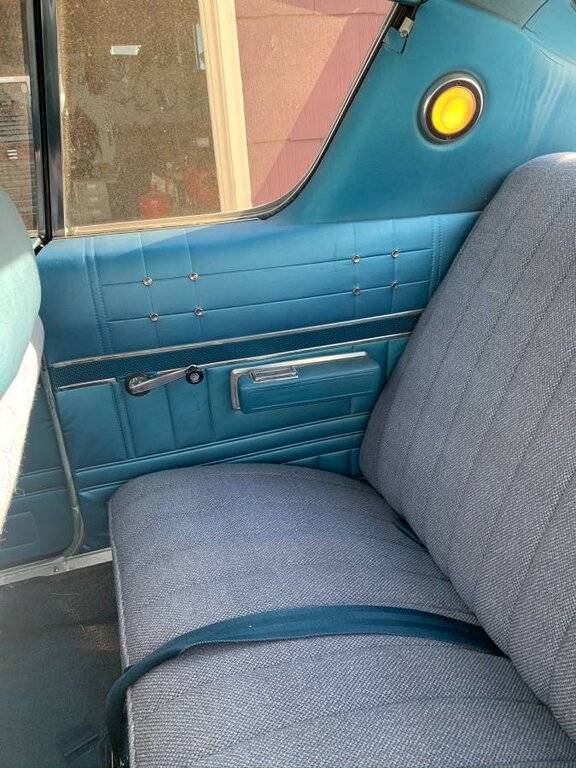

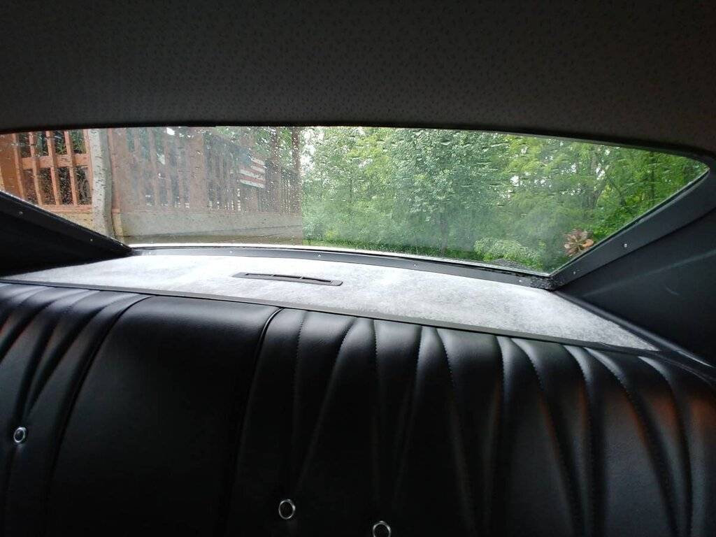

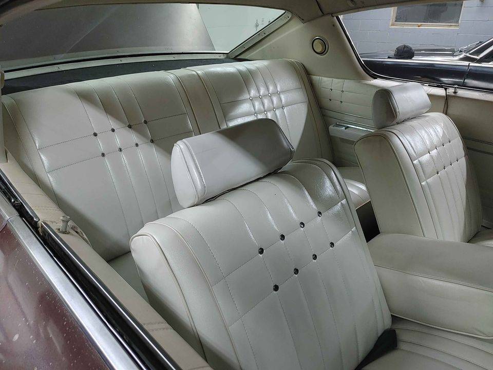

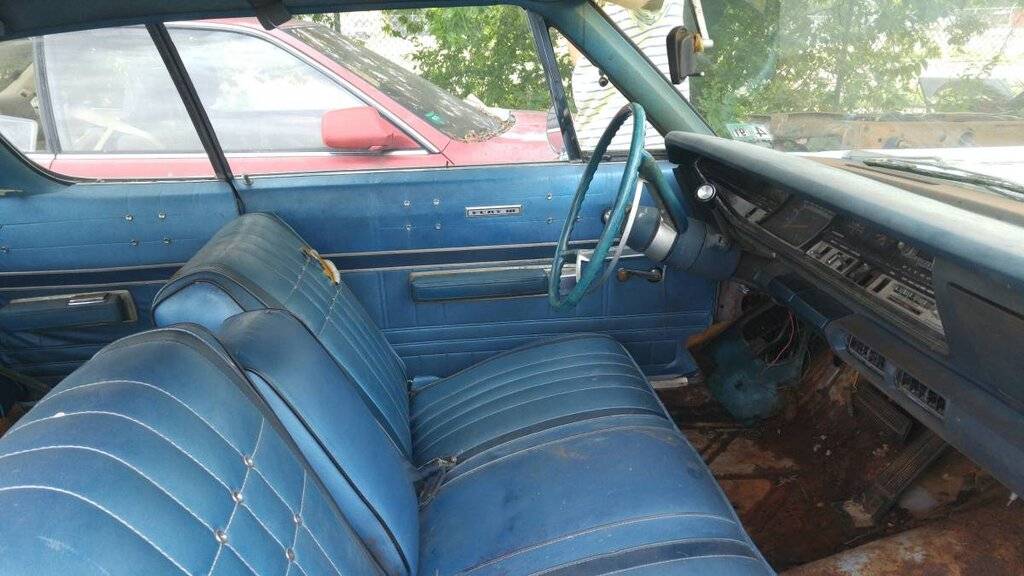

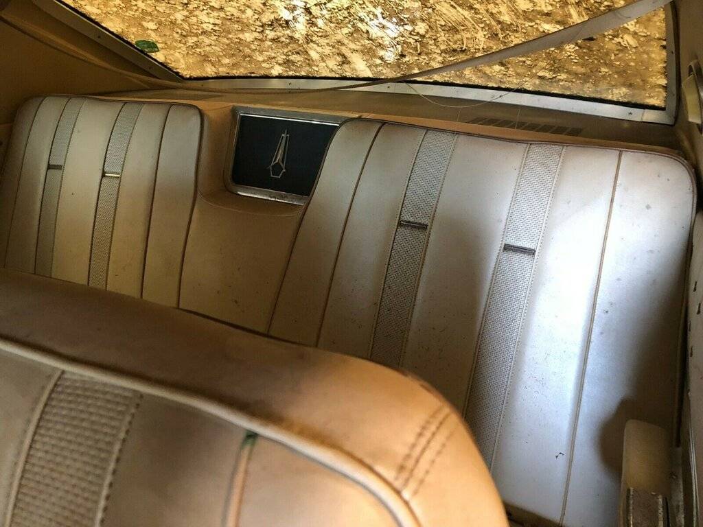

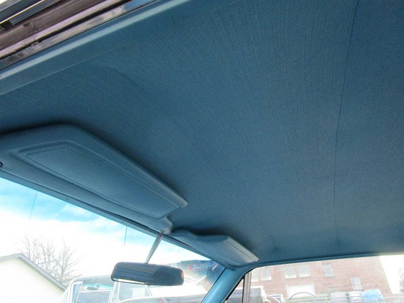

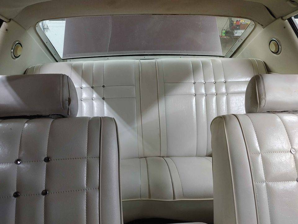

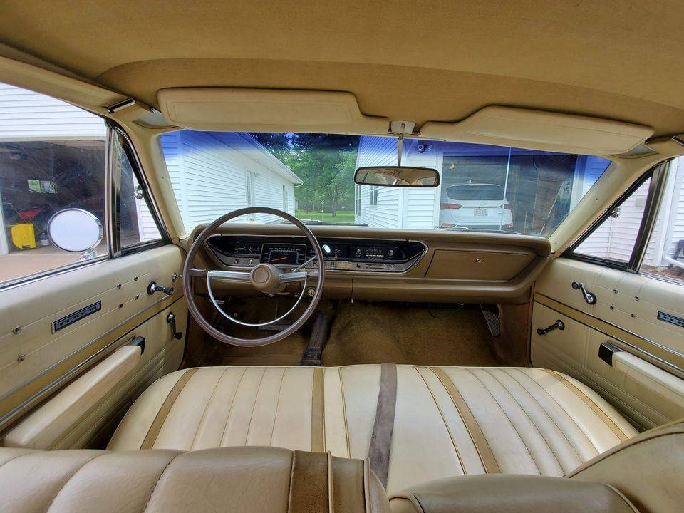

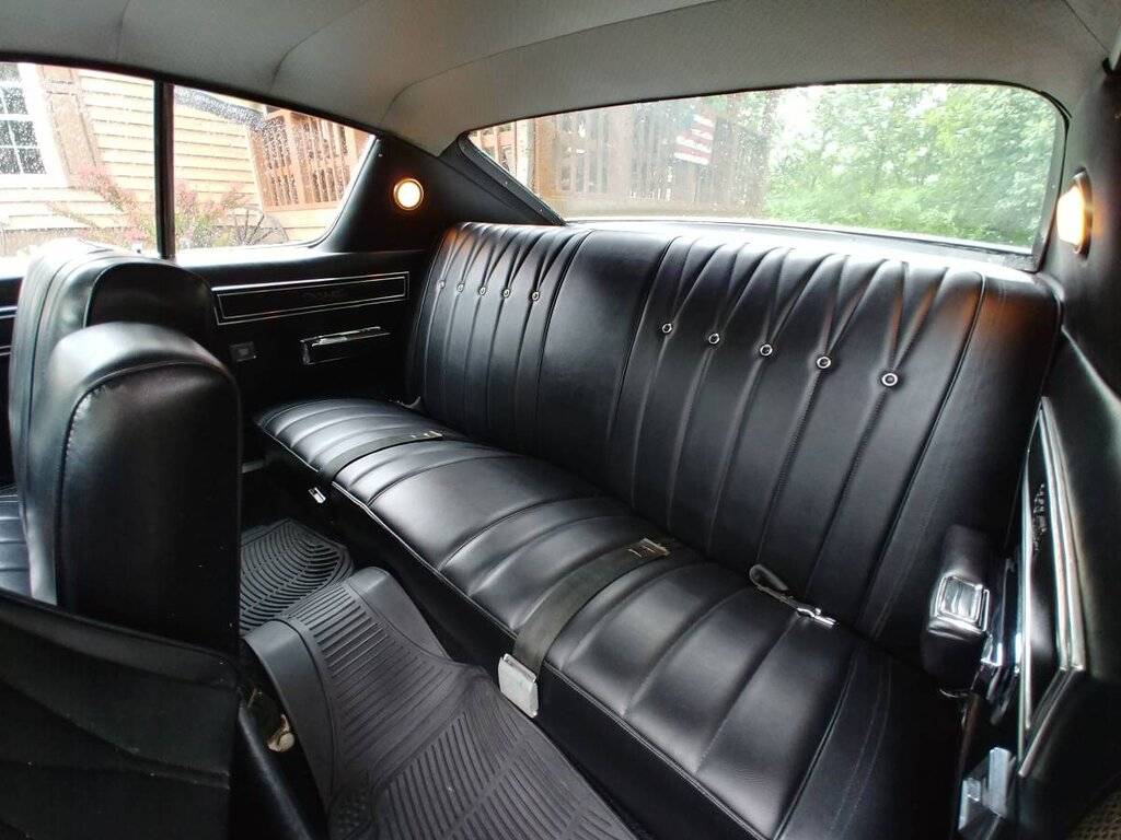

I'll see what I got, in my 1968 Fastop collection. some not the best close ups but cull AD pictures. Hope this helps.
