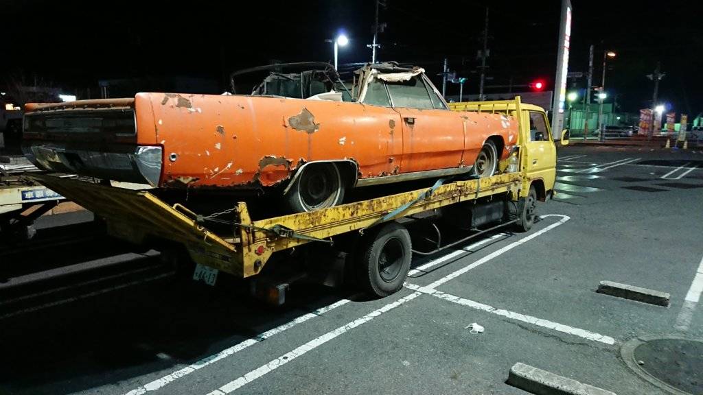

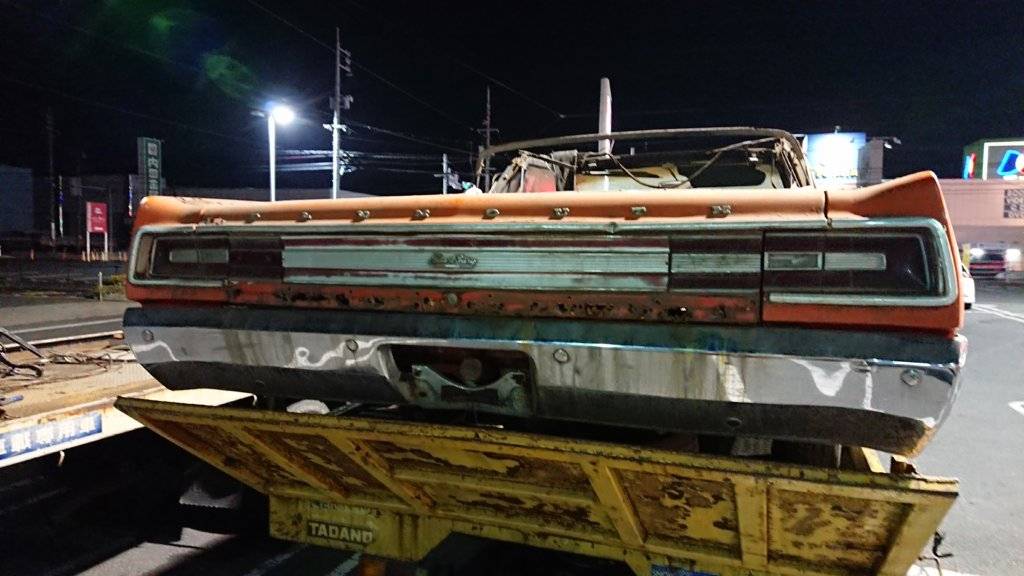

    here is somepics. I looked floor, trunk and frame, they needs some attention but not rusted out. I don't think I have to replace floor pan, I'm going to patch the holes.

    I see that it is a Sport Fury and is also missing the lower trim strip on the trunk lid and needs a trunk lid and a hood.
    That is going to be a big restoration project.

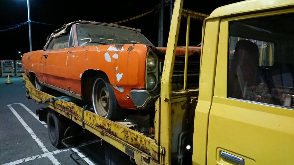

    picture from front

    Sorry to say but by those pictures did the tsunami wash this up too your front yard?
    That's a drive train & small parts car at best, hope someone paid you to remove it.
    :eek:
    (edit) chrome appears pretty good ona the rear bumper, don't know how that survived compared to the trunk.

    This is NOT a water damaged car, car rolls and most parts are there, sure it is long way, but with your helps, I'm sure I can make the car road worthy. either way, this car is something special to me.

    That peeling paint with the white under showing leads me to believe it's a bondo bucket and if you dip the body I'll bet'cha you'll have nothing much left. But it is a 4sd vert soooo...
