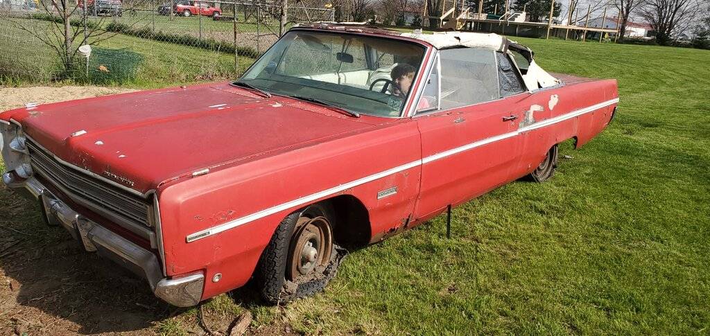

I recently purchased a 1968 Fury 3 convertible. It needs floor pans, trunk, and rear frame rails for starters. The rear wheel wells and convertible top frame are in great shape. I'm new to restoration but want to get started. Is this a parts car or project? What years and models would parts fit this car? Thank you!
My advice... This is a parts car for you.
A very wise man, who has restored several very high end cars, once told me "start with the best car that you can afford" on a restoration project. Your car needs, well... everything... From just that pic, I see thousands and thousands of dollars and hours in work. I don't know how much you can do yourself, but this could easily cost $30-50K to restore a car that you can buy a nice one that's all done for $15K. Something that needs a little TLC for half that.
Sell this car and buy something closer to done... Something that drives so you can putter with it and still go to the cars and coffee at Dairy Queen with Stan and the guys while you are working on it.
In other words, bluntly, this isn't going to be fun... This is going to be grueling, mind numbing work for a couple of years or more, every night and every weekend... Most likely, you'll never get close to finishing it and you'll get sick of looking at it in five years and you'll sell it in bushel baskets, losing just about every dollar you put in it and say "Why didn't someone tell me how hard this was?".
I would concur with Big_John, with bad floors and frame rails this car is too far gone. I would try to find a solid '68 Fury that needs some work and use this car for parts.
Dave
This is definitely a parts car.
A few things I have learned on over the years are that the more desirable the car is, the more work will have went into it over its life to keep it going. Some repairs will be great, others, not so much. Nice, “honest” convertibles of the 60s are hard to come by. This one has its obvious defects which are enough to disqualify it for restoration.
I believe the problems it has that are not so obvious would be heartbreaking.
I advise you to look for a car that has the least rust as you can find if a cbody is what you want. Unlike more popular cars, you can’t just buy any part you need for them and build a body from scratch.
When looking to buy an old car to restore you want to concentrate on the body, frame, glass, interior.. paying close attention to hard to see areas like underneath, firewall, inner body panels and such. Don’t worry so much about the engine and transmission. Those are comparatively easy to come by and no mystery to swap out if necessary.
Just my advice for what it’s worth.
Great advice. Now how do I get the parts from this car into the hands of people that need them? Thank you!
If I were you, I’d keep the car for parts for yourself. Tinker around with it without spending much cash. familiarize yourself with how it’s made and exactly what all really is wrong with it. Next time you’ll know what to look for.
That depends on what you want to do...
Easiest and fastest (hopefully) may be to post a for sale ad here for the complete car.
If you are willing to part it out, that can be done here too. You may even make a little more cash by doing so, but it really depends on what's left in good shape. I don't see selling much of the sheet metal, if any, for example. That takes some patience, willingness to take pictures and deal with people, some of whom are great and unfortunately, some of whom you will try your patience and then not buy. Nothing like dragging a bunch of parts out, cleaning them up, pricing them fairly, taking pictures from every angle, answering questions, figuring out shipping (possibly to Europe) and then never hearing from the buyer again. AMHIK.
Then there's the use it for your own parts option... '68 Fury convertibles aren't all that hard to come by if you want one. I think a '67 would share a lot of parts too. Mechanically, the range gets really wide, and now you can bring Dodges into the picture. Then there's the question of if you have your heart set on a convertible... Rag tops are great, but ask the man that owns one... They bring their own set of issues into the mix with even a good looking one having a soft floor. Then there are times when that hardtop Barracuda next to my 'vert in the garage is a lot more cozy on a cool day when it might rain. Just food for thought...
I'm probably coming off as someone that's trying to discourage you from doing anything... I'm not... I love the car hobby and love to bring guys into it. What I like to see happen is new guys having fun with their cars. You buy something that's drivable and needs a little TLC and tinkering. Those are the fun cars. You get to drive them and working on them isn't some major challenge or project. The last two cars I bought were exactly that... Both running, driving cars that needed a bit of work... With the exception of one being in the body shop for 8 weeks, both never really were more than a few hours work from being drivable. It took me a long time to figure that out...
Great advice in the previous posts. Bad floors and frame rails would be very expensive and time consuming, even if you are experienced in doing that work yourself. There are still some good deals on our beloved C bodies out there. Some nice solid examples that just need minor to moderate work to make them real nice cruisers. I don’t know what your budget is, but if 4 doors wouldn’t bother you, there would be more possibilities available obviously. Personally I love the look of a 4 door hardtop. This is a great hobby. Know your budget and skill set, research any prospective car, and buy accordingly. That will keep it fun for you and your family.
I strongly concur with @BigJohn's comments. To me, the "deal changers" are the underbody issues mentioned. Remember this is a unit-body construction car rather than a body/frame cars, which makes those issues more intense by comparison. Especially on a unit-body construction car without a solid TOP.
In general, Chrysler Corp didn't build a lot of convertibles compared to "closed" cars, compared to GM or Ford cars. Which might mean that ANY convertible would need to be saved for parts or restored, no matter what. But with the price of better cars being what they are, the financial viability of a full restoration (custom or stock) becomes and issue, too. But at some future point in time, the hardware that makes it a convertible can become more valuable and needed by some, very possibly. When? Not sure, maybe years later after all of the other ones have been crushed.
But the problem becomes that in order to save this one, you'll need a 2dr hardtop parts car to do it, possibly. A car body that is in better shape but that has all of its innards already gone.
In selling it, it will be much easier to deal with "in one piece" rather than having exterior sheet metal missing. Once that exterior sheet metal and trim is gone, it quickly becomes "junk" and will need to be kept out of sight and such to keep everybody else happy.
In the mean time, take some more extensive pictures of the floorpan areas for reference and possible future sale activities. Get it more resentable for the same reason. Don't get in a hurry to sell it, but do advertise it in several areas. Or put a too-low price on it. It might take a while, but somebody might say "I can do that", make an offer, and it'll be in a better home. A buyer with more resources (time, skills, and money) to make it all happen.

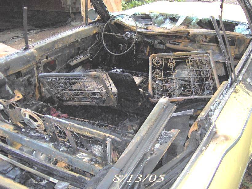

If you plan on getting another '68 Fury convertible, I would keep this one and save all of the parts that you can . Over the past years I have owned 3 '67 Fury parts cars for my two Furys that I drive. You never know what you will need later on. I know that doors and front fenders are the same on '67 and '68' Furys. The rear quarters have a different lower body line on the '68 than the '67 and the trunk lids are different. The top frame is a definite save. I had a devastating fire in my convertible in 2005 that ruined the entire interior. I was fortunate to find a '67 vert for parts locally for $600.00. It was a blessing. What ever you decide to do, I wish you the best.
J
