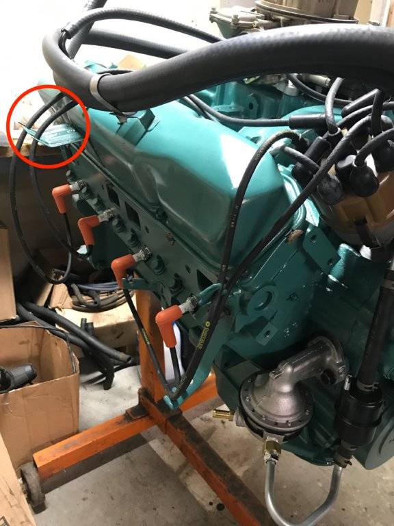

I am getting close to finishing up my '68 300 440. It was a non-HP motor, but I am using HP manifolds. One picture that I did not take well enough when I took everything apart was the routing of the spark plug wires and brackets. I have most of the brackets sorted out, but I am wondering if the valve covers were different on HP vs non-HP.
The reason for wondering is the routing of the #5 and #7 wires. I ordered the Lectric Limited HP reproduction wire set and they came with all 90* boots. Their non-HP set has two boots that are straight, that I assume were for 5/7. Makes sense that these were routed over the right valve cover and held by the valve cover bracket. Not sure about HP. Seems like maybe the #7 wire should not use the valve cover bracket and go all the way around the back of the engine. Not sure.

On my 383 HP with the same manifolds, the 7 & 8 wires went down the intake, over the valve cover and looped in from the rear, there was a small one wire clip at the rear of each cover. So, to answer, while all covers will bolt on, there may have been separate ones for the HP with these clips. The other wires on both sides went down the front of the engine and looped up from under to the plugs. Nothing went directly over the covers and down, I assume to avoid the upward sweep of the manifolds. I'll try and find some pictures that show the routing.
The valve cover shown is for a non-HP big block. The HP exhaust manifold will come up and rest against the plug wire bracket when installed. One option is to carefully cut off the plug wire bracket. I know this because I need to either swap valve covers or remove the bracket on the valve covers on my yellow '68 Sport Fury. If needed, I can see if I have a photo to post but if you search for a B Body HP right exhaust manifold on eBay or elsewhere you will see how it arches up whereas the non-HP is a log style exhaust manifold that is low and straight.

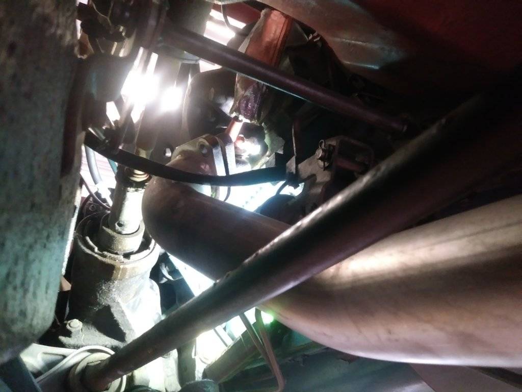

The left valve cover has the wire loom for number 7. All other wires go from under..
From underneath notice #7 is a 90 degree plug. I useda plug wire heat sheathing since they are known to get baked in this location,and sprk plug removal is easier from underneath....learned the hard way,,got the burn scars to prove it,LOL
