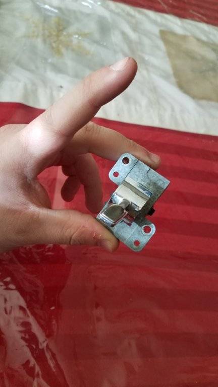

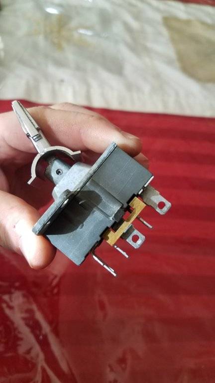

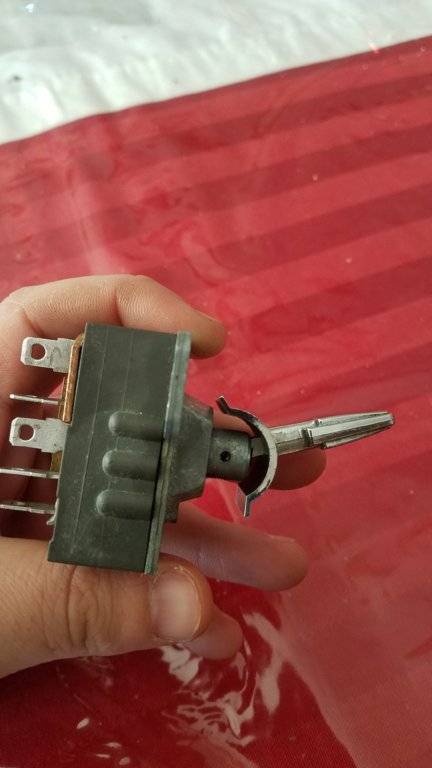

    Post a picture. I may have one in the draw, but with them out of the dash I'm not sure which is which.

    here are some photos, thanks scott

    are you sure its that and not the turn signal switch?

    I need the part number off of it.
    I will check my stash..
    Are you sure it is the culprit of no brake lights?

    I had that problem on my LeBaron once, and it turned out to be everything BUT the switch. Post a part number, which may help. There's a GOOD chance it is the same part as for '67.

    There are two numbers on the switch 2771176 and 19010.
