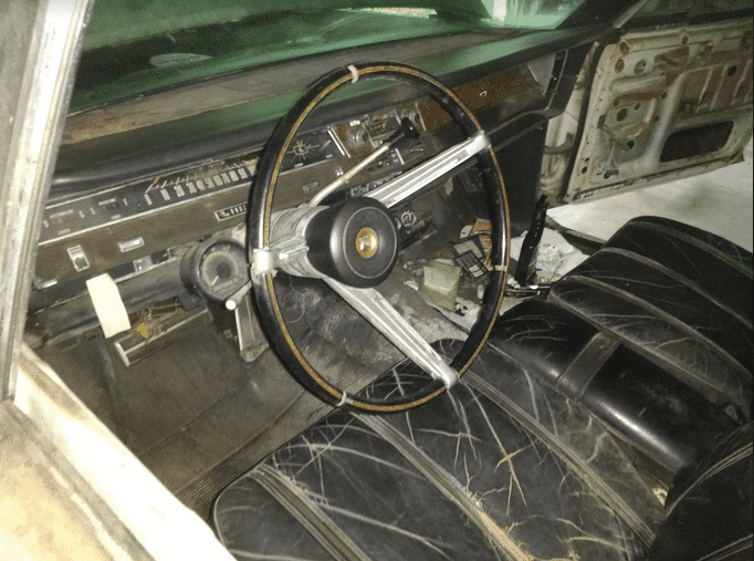

The New Yorker has some fairly uncommon options: AM/FM stereo and leather bucket seats. I don't see those options too often. The old-time leather seats are more thick and durable than the supple leather in newer cars and they've held up surprising well. It's funny though how the plastic on the steering wheels seem to continue to shrink. Those three cracks were there as long as I can remember but in the 70's they were just cracks. Now they are about 1/2" gaps.

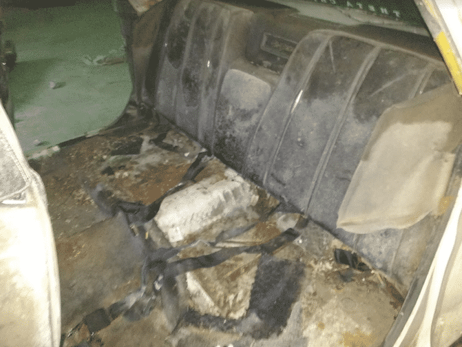

even though it was inside, this building had water problems which caused condensation, mold, and rust. Underneath the rear seat is the worst I've found so far. It actually caused one of the seat frame bars to rust away and there's some soft spots in that badly rusted area :(

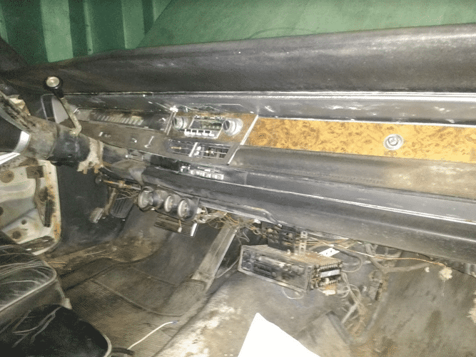

the interior looks worse than it is. it's covered with mold and dirt, but as I've been wiping it off in areas it seems mostly ok. the one disappointing spot is the radio bezel. I guess condensation must've collected there because it got corroded and the wood grain is ruined.

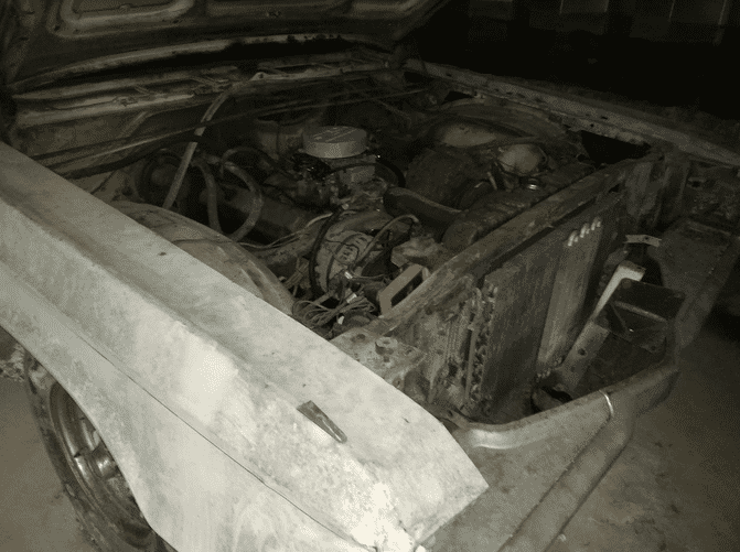

We started the engine a few weeks ago and once we got the cobwebs out of it, it sounded pretty good. This isn't the original 440, it's a rebuilt '74 that I had installed in '87. The story behind that is too long for here :|

The corrosion on your radio bezel is most likely from mouse pee. I've had the same issue on multiple '67 & '68 Chryslers. That spot up in the dash must be a good place to hang out.
Jeff
ugh, yes I wouldn't doubt about the mice. There is evidence of them living in different areas, including above the roof liner, which *was* in perfect condition but now has two small holes in it on either side were mousy chewed though, probably to make a little air hole for its nest :elmer:

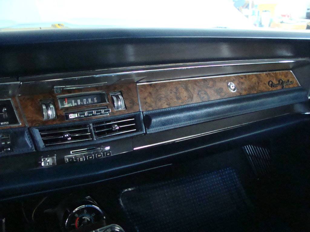

Thanks GOLDMYN for posting a pic of your NYer interior, I remember when mine was nice and clean like that. It gives me a target to aim for

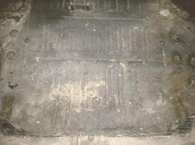

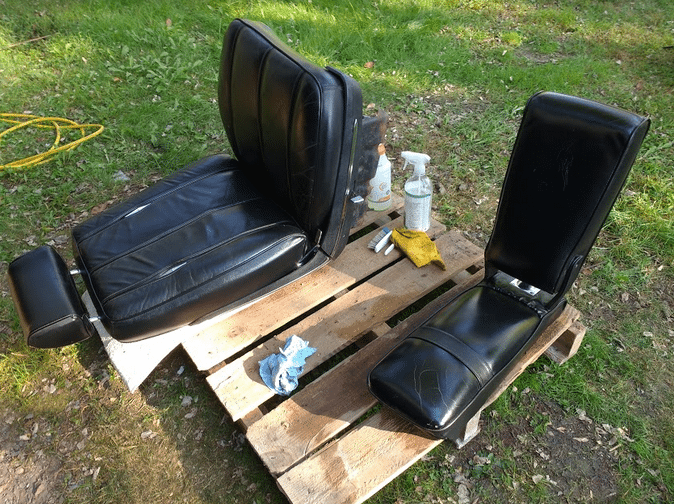

We pulled out the front seats and the rest of the carpet. The front floor pans are in bad shape. We cleaned up the front seats to put into the 300 so we get them reupholstered. They cleaned up nicely

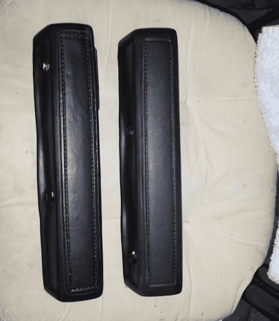

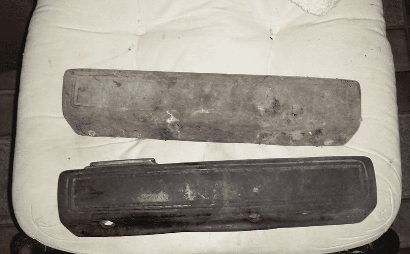

I cleaned up the armrests too
before...
after

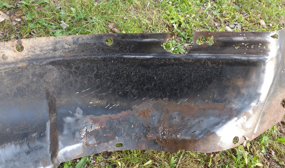

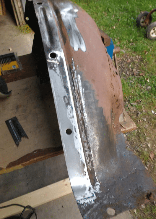

I figured I'd start with something easy that wouldn't require perfection: The driver-side fender well...(I know I could probably find/buy good ones but I want the experience)
It has some pretty rusty areas. Along the bottom of the picture you can see some embarrassingly poor work I did when I was young with my Dad's no-name flux welder. I plan to cut that out and do it right. But for now I took on the rusty part along the top because I figured it'd be easier.
Here's my nearly finished work. I think it turned out pretty decent. I think I may've put the mounting hole a tad too far from the edge. Hopefully there'll be enough play that it'll mount up ok w/o having to enlarge the hole.

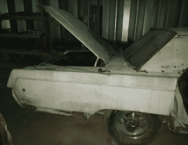

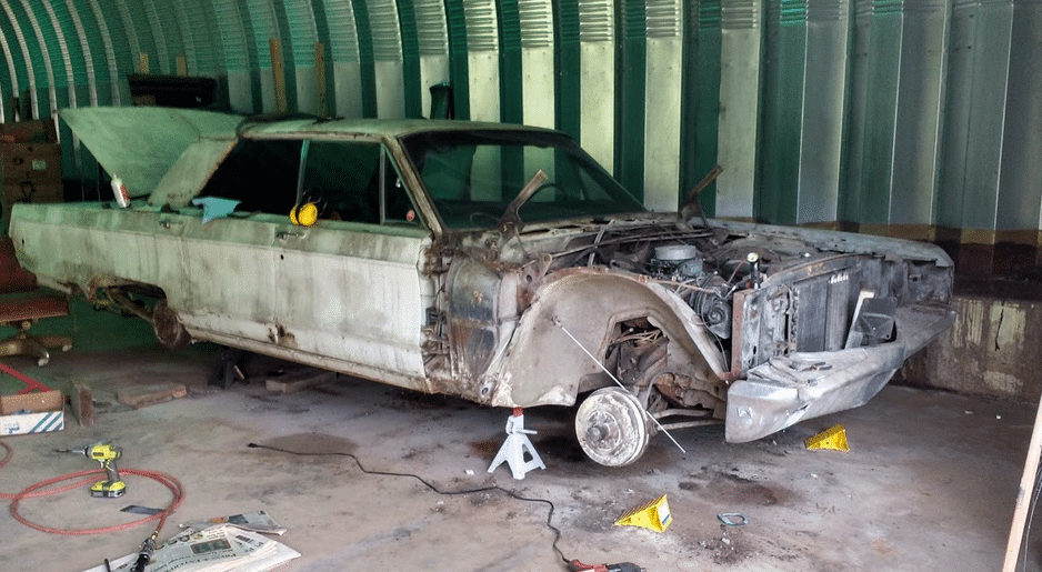

Been making some slow progress. I can only work on it a day or two a week for a few hours. Got the hood off, front fenders (driver side was still on for this pic)

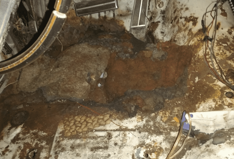

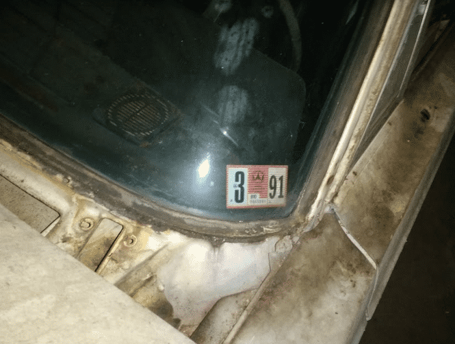

Got the carpet out. Driver-side floor is in bad shape. There must've been a spot-light installed and then removed before Dad bought the car in 71 because there is a hole in the A-pillar in about the right place for it. There was an aluminum plug in the hole but it wasn't sealed so water was seeping in their for years :(
