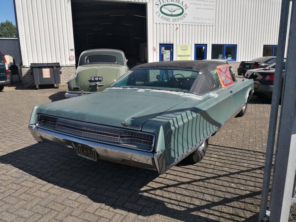

I own a 1968 Chrysler New Yorker since a while that I am restoring. Beside driving a 1969 Dodge D100 sweptline as a daily driver I'm not that familiar with Mopars, so that is why I'm posting this thread. To give some updates on the restoration, but also maybe getting some info and help.

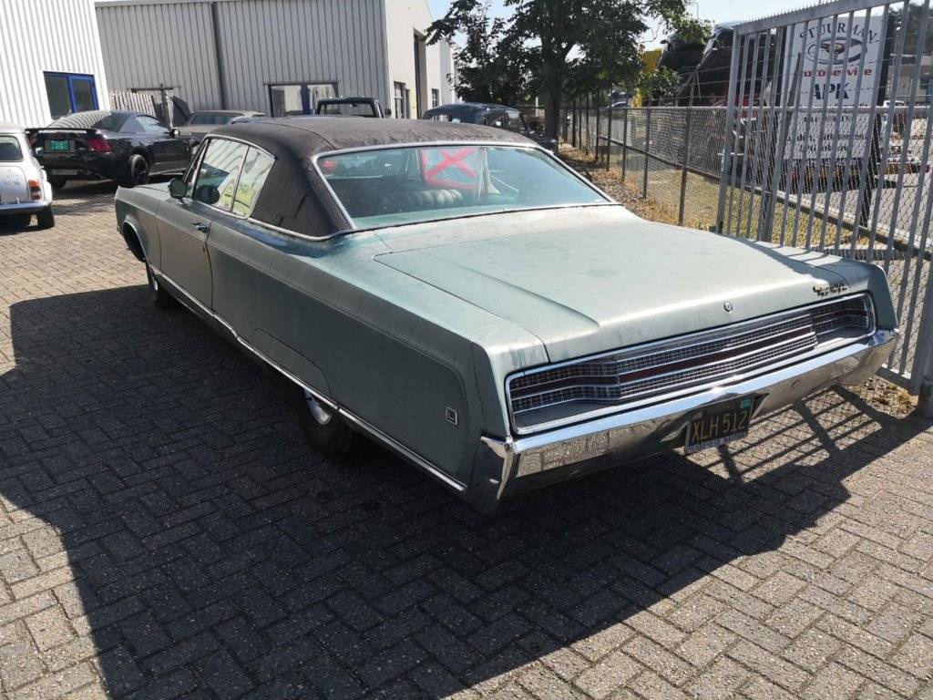

The New Yorker I'm restoring is a 1968 model and was sold new in California. It is an original one owner black plate car and it even has the original invoice and insurance papers.
I've bought the car off course because I liked the model, but also because of the history. The body is incredibly straight and original and that was what made me fell for this car. Although it is a California car, it does have some rust issues. A bit more than I was expecting, but that's normal with a older car.

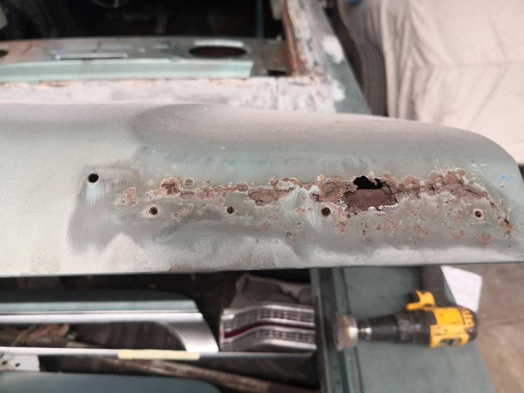

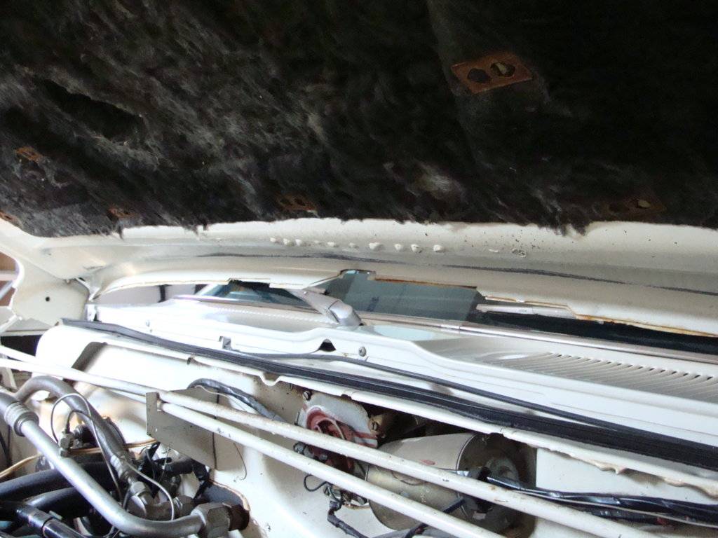

The left front floor pan is one of the issues, but that is easy to fix. A bit worse is the roof and underside of the rear window. It obviously had some moisture issues because of the vinyl roof and I do believe that is also the reason why the left front floor pan is rusted. I removed the vinyl roof (it had seen better days) and found a few small holes in the roof. The biggest problem is that the underside off the rear window molding has rusted away. It is quite complex shaped, so that is going to be a challenge to repair. The rest of the car looks like a California car should (luckily).

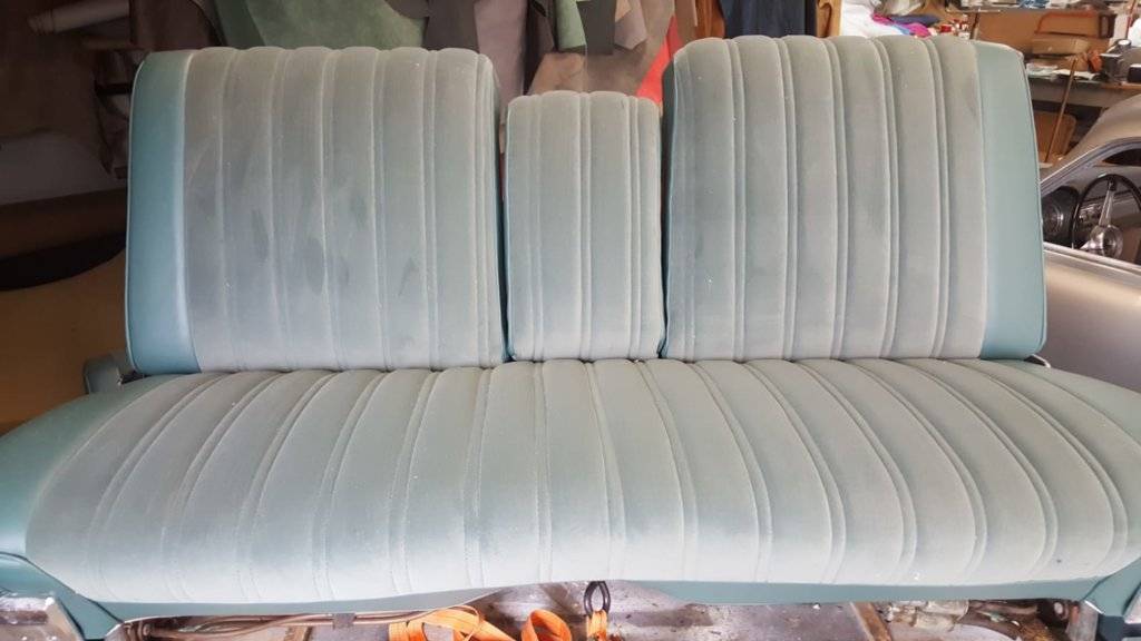

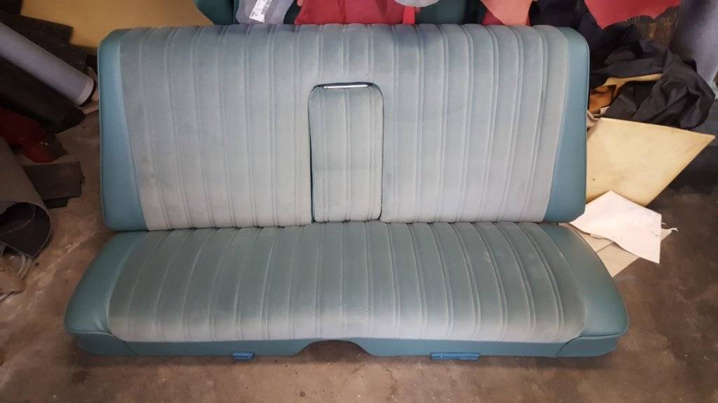

The interior was a bit tired and very dirty. The seats have already been reupholstered, but haven't done anything to the rest of the interior yet. Body first.
It needs new carpet and headliner and a lot of cleaning. The dashboard has a few cracks so I have to repair those. The door panels look like new (beside some cleaning), so I do have some luck with those.

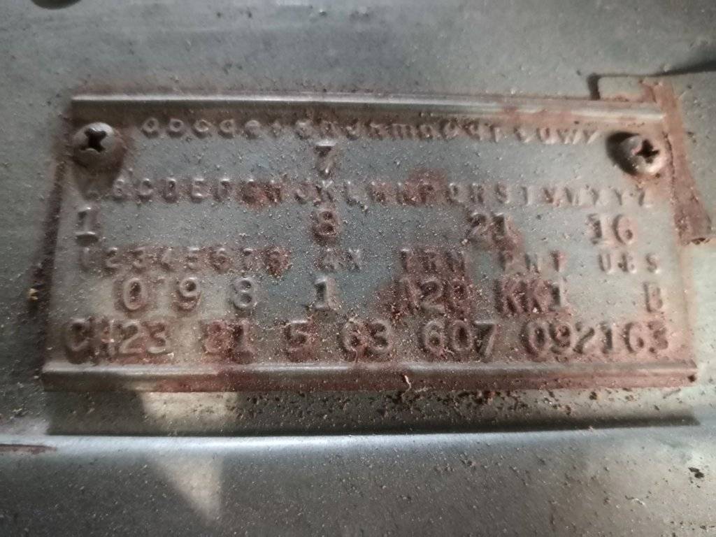

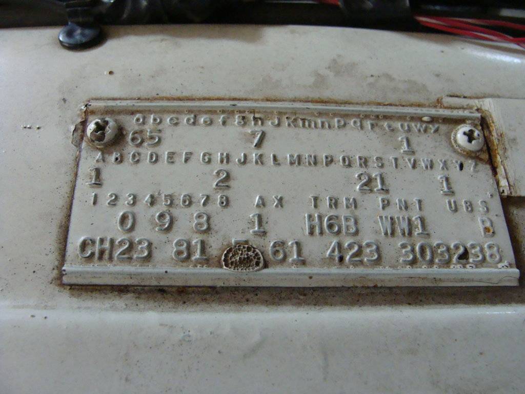

What I would like to know if there are ways to tell if it is matching numbers and if there are any stamped Vin or body numbers on a New Yorker? How do you decode the body tag of a New Yorker? I also have the build sheet in the rear seat.

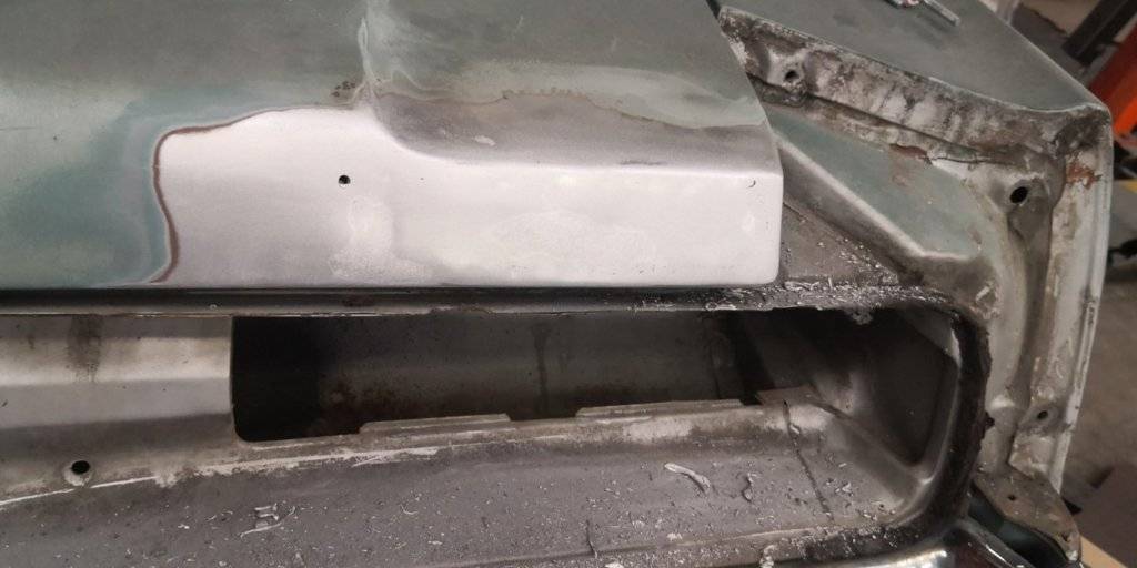

I already did a small rust repair on the trunk where it had some rust underneath the emblem. The rest of the rust still has to be repaired.

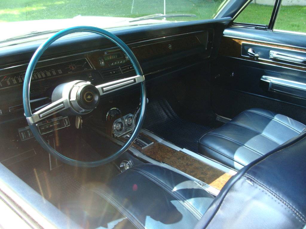

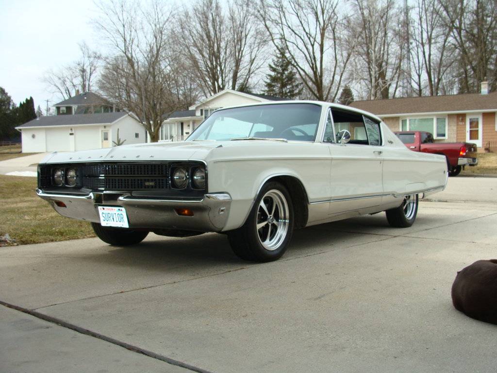

nice, you do good metal work, if you need any pix, let me know. i have 1968 new yorker,
original survivor
Thank you. That looks like a really nice New Yorker!
If I need any pictures I will let you know, thank you for the offer. Luckily the car was complete and in one piece before I started.
Can you show a picture of the fendertag...….
h7 - fender mounted turn signal indicators
second row
A1 - 26 inch radiator
k8 - power windows
r2 - am radio
s1 - a/c
x1 - tinted glass
y6 - black vinyltop
The '68 model cars do not have "numbers matching" criteria as there are no VIN number stamps on the engine or transmission. Check the date castings on the engine and transmission. As long as they are prior to the build date of the car, that is all you need to worry about. Somewhere in the car, there may be a build sheet that has additional information. Build sheets are often found under the seat springs.

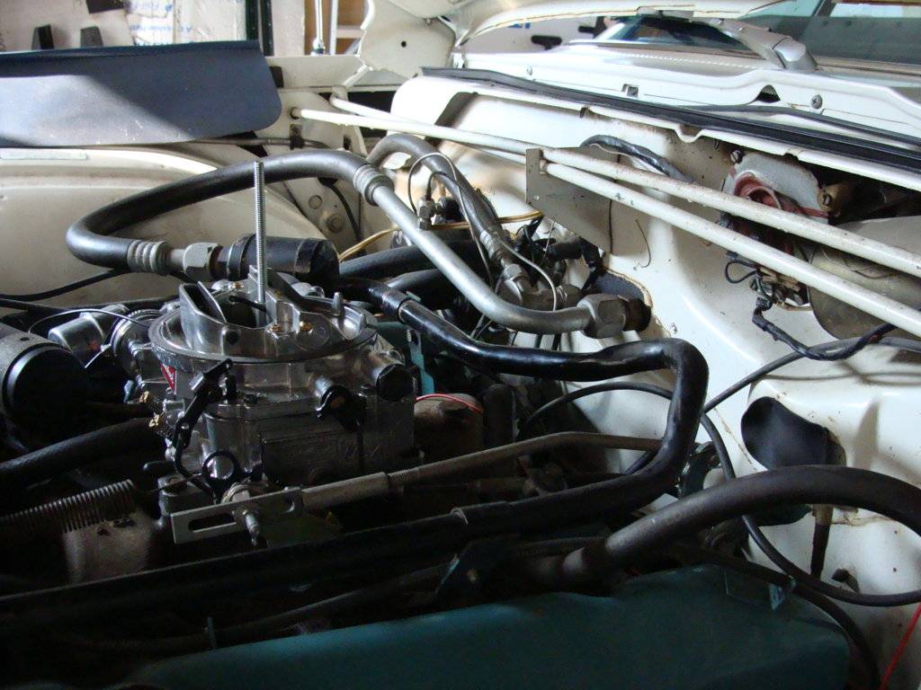

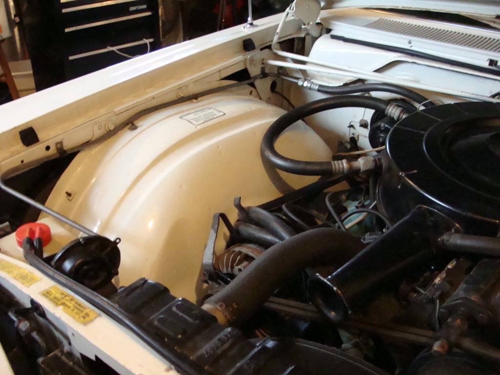

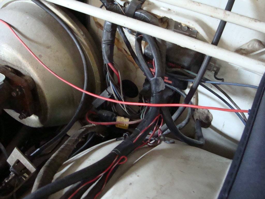

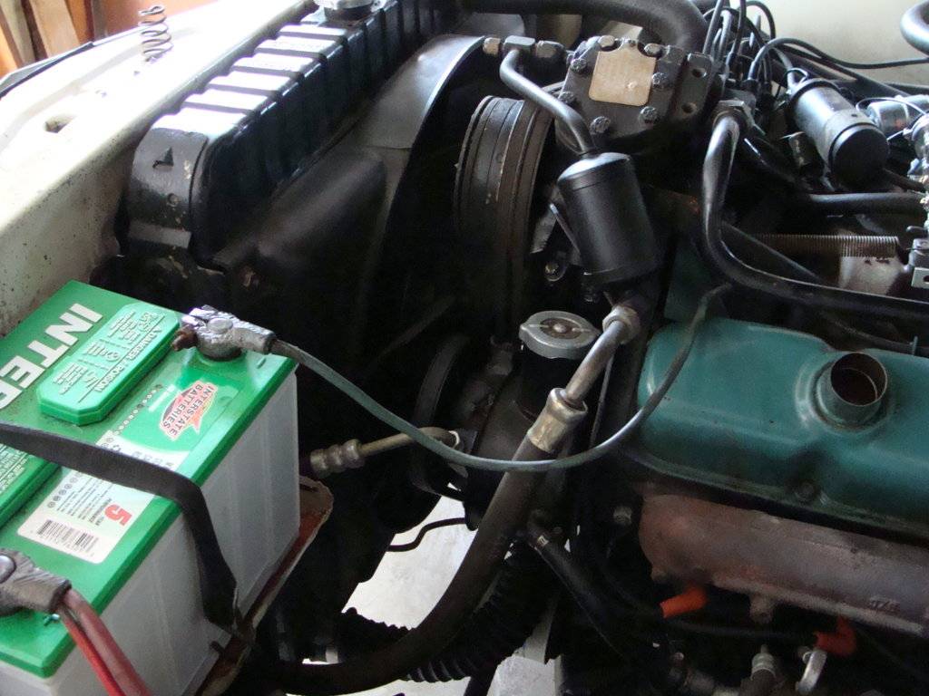

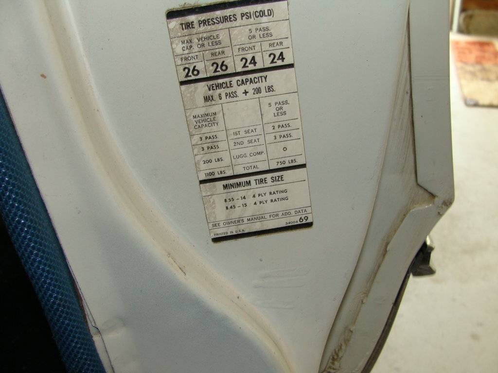

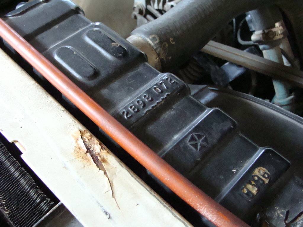

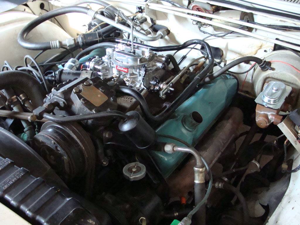

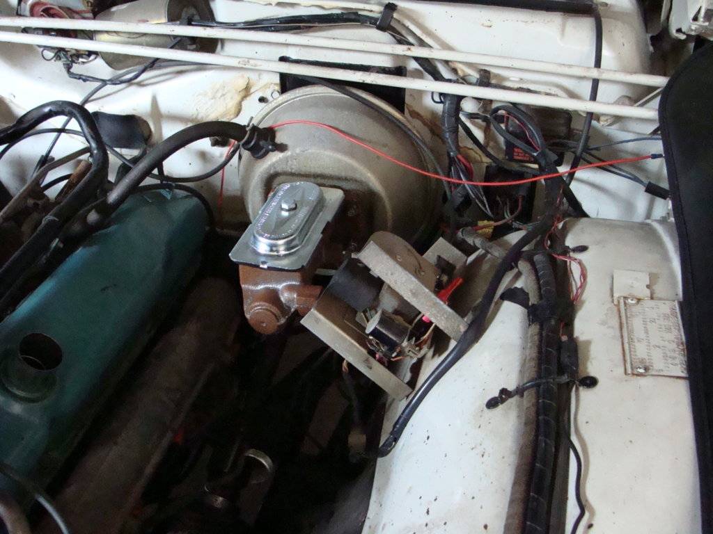

Does anyone (maybe goldmyn?) have good pictures of the engine bay? I've already searched on internet, but they al seem to be a little bit different. I would like to know how it looked originally and what color everything used to be? And maybe some pictures of the original stickers in the engine bay would be nice. Most seem to be still there, but I would like to be sure and keep or make it as original as possible.

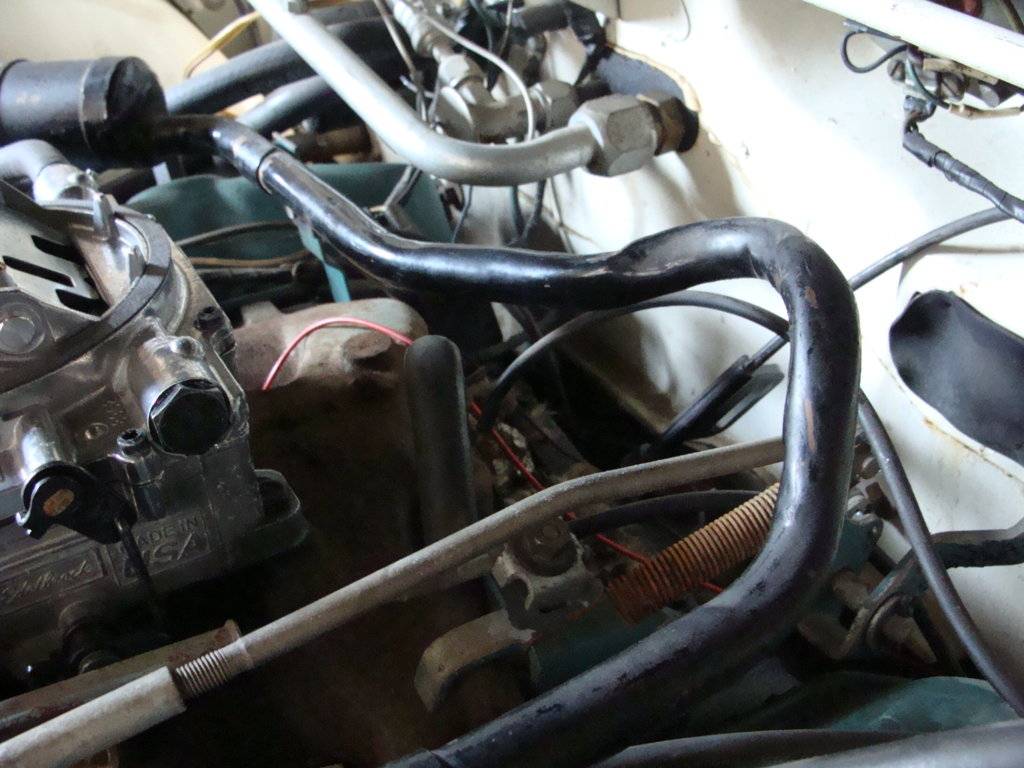

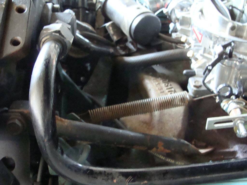

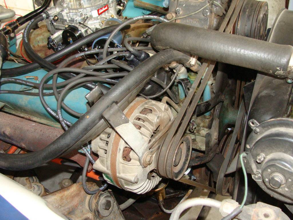

I removed the aftermarket cruise control and I'm sure you'll notice the metal pipe in
stead of hose @ the water pump
Thank you for the pictures. It really is a nice clean car! I really like the bucket seats and center console.
It does give a great impression how it should be. My New Yorker is not that bad, and as far as I can tell it looks really original except for the engine itself. I already knew that, the engine is painted black..... Luckily there is blue paint underneath the black. The bolts of the engine mounts are completely undamaged (normally you can tell if a bolt has been removed). So that's why I think it has never been removed. It is going to be blue again of course.
As far as I can tell from the pictures al the stickers are there on my car, except the sticker on the right front inner fender (passenger side). I can see there used to be a sticker, but it is gone. What kind of sticker used to be there?
