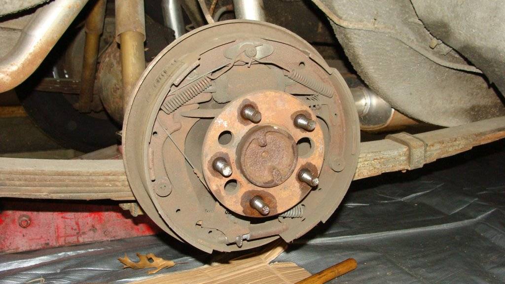

Hi, I'm looking for recommendations rear OEM type rear shocks for my car. Originally optioned with HD suspension. Not a fan of gas charged KYB if I can help it. Anything in the Monroe line? I appreciate the time. Mike

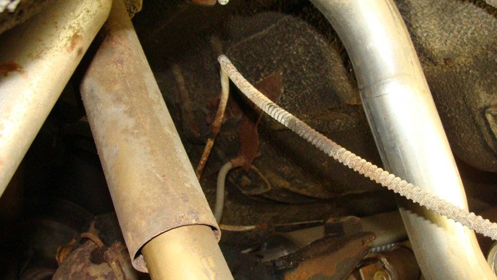

Thanks, I looked at those, didn't match what I wanted, I'm afraid the HD with springs will hit the exhaust pipe and be too harsh
