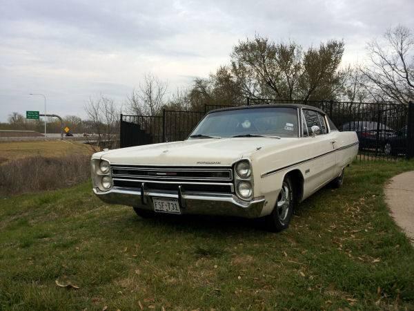

    well, here it goes. If I can live to see the day when this car is finished, and this page has pictures of a finished car on it..it will be freaking killer as hell. I hope I get there. I bought this Plymouth fury III in march 2013, in dallas texas. VIN# PX23G8D243539. I was told I'm the 3rd owner, and it is supposed to be a texas car. It's all there , and supposed to be all original. I looked at the fender tag, motor, and transmission numbers, and they are all from late Feb 1968, and the car was born Mar 6 1968 (if I remember the decoded info correctly), all within a week of each other. It is labeled as white, black top, red interior, 2 door fast top. It has a 383 2bbl and a 727 trans 3 speed auto on the column.:sFl_america2: 1968furyIII600x600.jpg I'm starting this post today, instead of being out driving this American made steel yacht because I was in the engine compartment wiping everything down, and the oil sending unit line broke off flush when I bumped it.. spent some time fixing that and started up, checked oil pressure gauge - GOOD.. put it into D and the idle doesn't kick down...hrum... I give it gas and roll a bit,, tap the brake, and almost faceplant the dashboard because the brakes locked. I think I broke some dry rotted vacuum line somewhere or something like that... So the wife says I cant drive it anymore until I restore it.

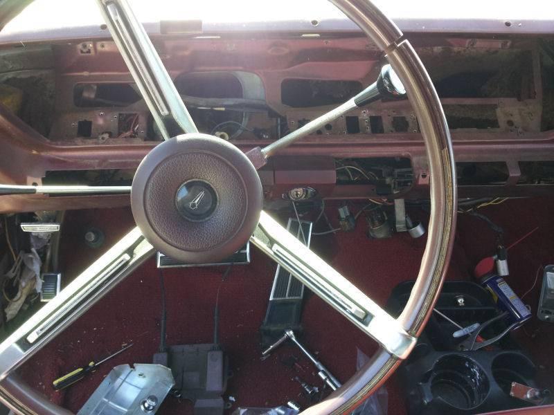

    still working on the old girl.... the whole interior is out and i went thru the dash wiring and gauges too... taping up wires, cleaning up everything, etc... 45 years of dirt and dead bugs and broken dash light bulbs and everything else up in the dash and inside the door frames, etc..
    changed the transmission kickdown, pan, shifter seal. Drop the valve body to get to the kickdown seal - WAY easier and worth the time to undo the valve body than to try to fish the kickdown seal out with a hook or other rig. Counter sinking the new seal in was easy with the valve body out of the way. ive got pictures of the 'press' i made to press in the seal, ill get the pic online soon. Trying to do the work and keep the transmission in the car... we'll see how it goes.
    fixed all the windows - they all roll down now :) - BONUS - they all roll back up too!
    Got ECI front brake disc conversion on order and it is on the way from CT...
    new front shocks installed. KYB were special order from here and monroe was the OEM fit it seems - so went with monroe gas fronts.
    front sway bar is off and new bushings are ready to go on ( moog k7061 )
    rear shocks soon...
    going to go with aftermarket gauges - too much time/money to rebuild the originals right now...
    wheels + tires after the brake conversion...
