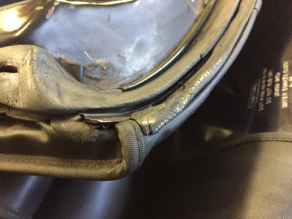

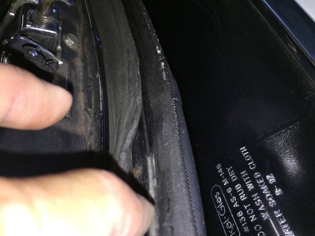

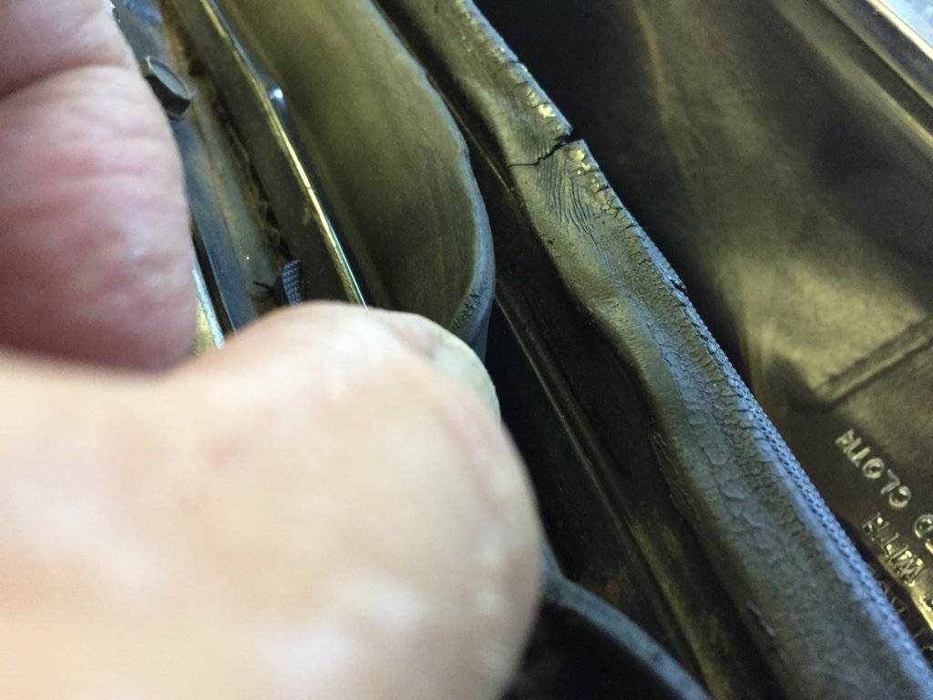

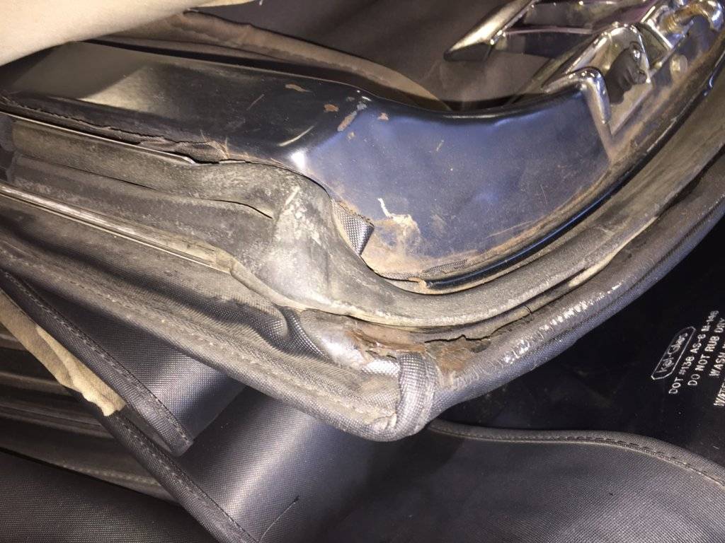

Here is how my Polara has the seals
The leading seal is in rough condition but should help for where the seals install
Oh
The leading seal has to be installed when the top is attached
There’s no other way to install it
