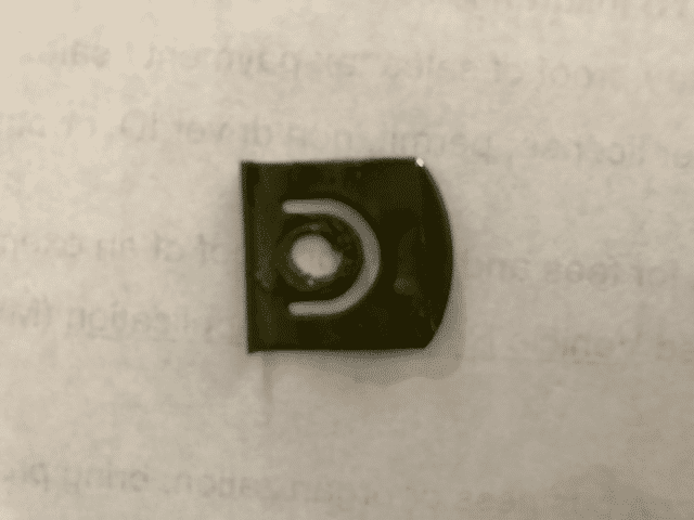

Just a quick question I have a 1968 Plymouth sport fury convertible I have been restoring.The body shop for whatever reason removed all of the clips from the winshield frame and never bothered to bag them so now that the car is painted they do not have a clue were anything is or how to put the chrome back on. I bought new winshield correct gasket I just need to buy new winshield clips for the chrome. Does anyone know where I can purchase these or if they are interchangeable I found ones for 1968 belvedere that look exactly the same. Also they need to replace the boot trim which appears to have a galvanized looking piece that goes under the trim does anyone know if this requires any special clips or does it just screw in the body. I know the boot trim screws in with the snap srews. I wish at this point I would of just removed the chrome myself in this day of cell cameras it would of been to easy to snap a few photos and place the parts in marked bags especially at the price there charging. Its been there for 3 years now. Its seems my story as ridiculous as it sounds is more the norm

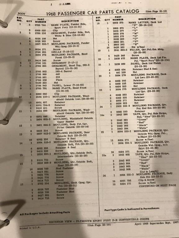

My 68 Polara 2dr ht screw into the frame.
Your pictures of clips look very close to mine, but my front window trim uses two different ones on the front window. 8 upper clips with one p/n and 10 lower.
Your parts manual is your best friend here. Have noted that my Polara is the same as the Fury I P-E. My assumption is that your car could use the same clips , but possibly in different quantities.
Just checked the manual. your sport fury convertible is the same as the Polara 2 dr ht for ft window clips.
Items 10 & 11. In the pic.
Mine are green like yours and also blue. I can’t find my clips right now to know which are upper and which are lower.

those clips pictured above are the same as my 65 fury front windshield trim clips. I have quite a few spare here but Ive noticed you can buy them new now at Vans Autos
