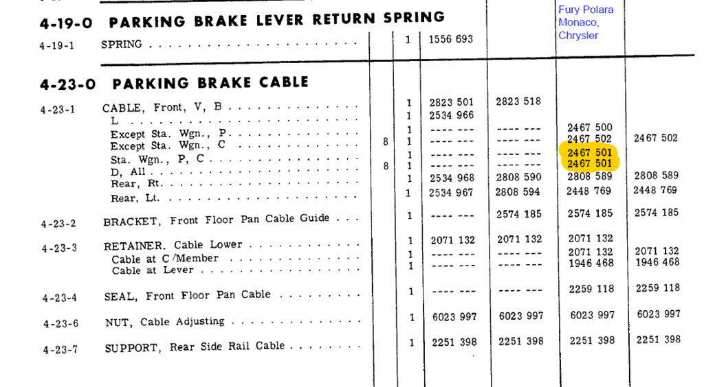

Also should be able to compare numbers in the parts book. Some of it may be due to the location and style of the release mechanism. And if I recall correctly the Fury is just a little shorter than the Polara and Chrysler.
High lighted is the original number you need. Fits all station wagons and all Dodge ( Polara, Monaco).
Chrysler and Imperial except Station wagons are the same. Plymouth except wagons is also different. Overall cable length is within a 1/2 inch ( from my two samples above), but the sheath and retaining spots are different between the models.

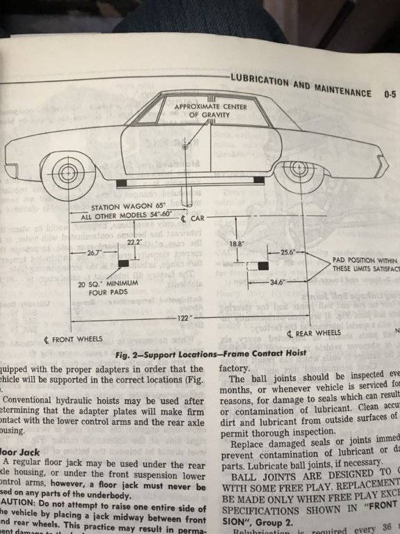

All wagons have 122" wheel base.
Dodge and Chrysler except wagons were 124.
Fury is 119"
So yeah you are right.

There again Ma Mopar is messing with us. The wagons have the same wheel base as the Dodge Polara and Monaco sedans and HT.
so corrections to your post above.
All C-body wagons and Polara and Monaco cars have a 122” wheel base.
