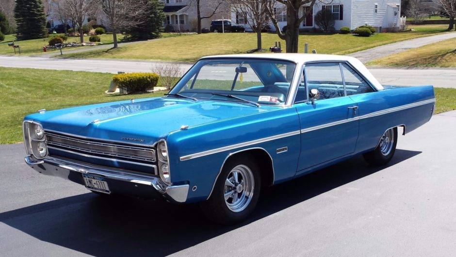

The 1968 Fury side marker lights look exactly the same as the side marker lights from my 1968 Dodge Dart (sold). Were the side marker lights for 1968 standard across all Dodge and Plymouth A B C body cars? Thanks! (I know Chrysler was square)

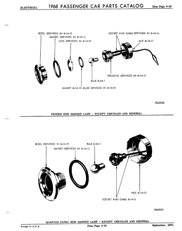

Pic from internet
Same except Chrysler and Imperial on the front fender. Looks like rear had a few more variations.
Fist column is Valiant, Barracuda,Dart.
Second is Belvedere, Satellite,coronet, Charger. Third is C bodies and fourth is imp. Wagons show some difference

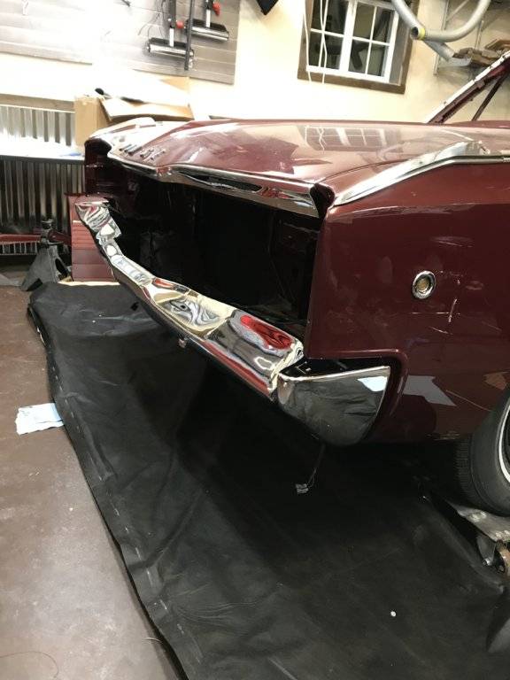

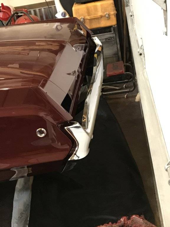

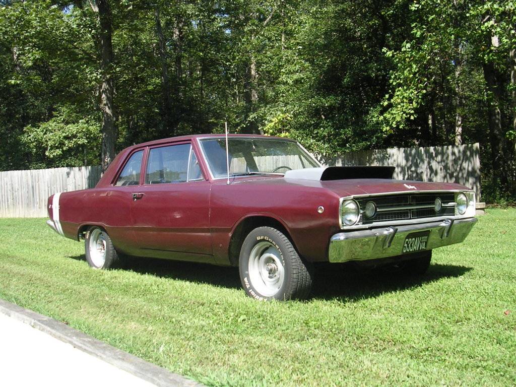

The dart has a sharp body line the light mounts on, the fury has a smooth surface with no body line. So they are different for that reason.

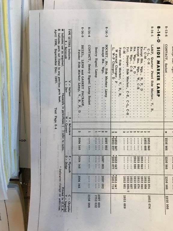

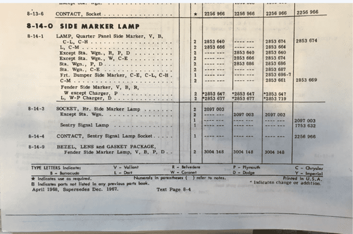

So by part # 2853 677, my L Dart shares this side marker with WP Dodge Charger, but no other cars. Charger also has body line.

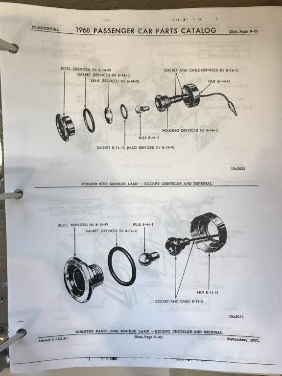

What is odd is the Bezel, Lens and gasket packages are the same number, but up above for the item they are different? Is the 8-14-1 just the socket and wiring? (I edited post #2 above, turned the picture, and added the illustration)
‘68 Polara (pretty flat)

View attachment 265460 View attachment 265461

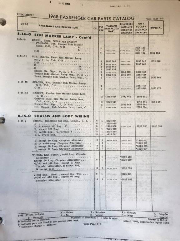

But the Bezel for L line Dart, & WP line charger are not shown on your catalog page.
Lines V, B, P have part# 2853-647, bezel 3001-148. Line D Dodge full size shares bezel with V, B, P, but has different p# for light assembly.
We need copy from the top of next page to see if lines L, WP, have different bezel part#.
This is where they start 8-14-0
L and w-p Charger. This section doesn’t very well match the picture section. Is the whole assembly 8-14-1 ?
