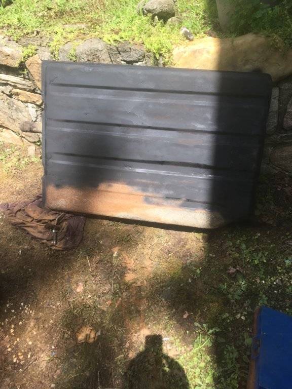

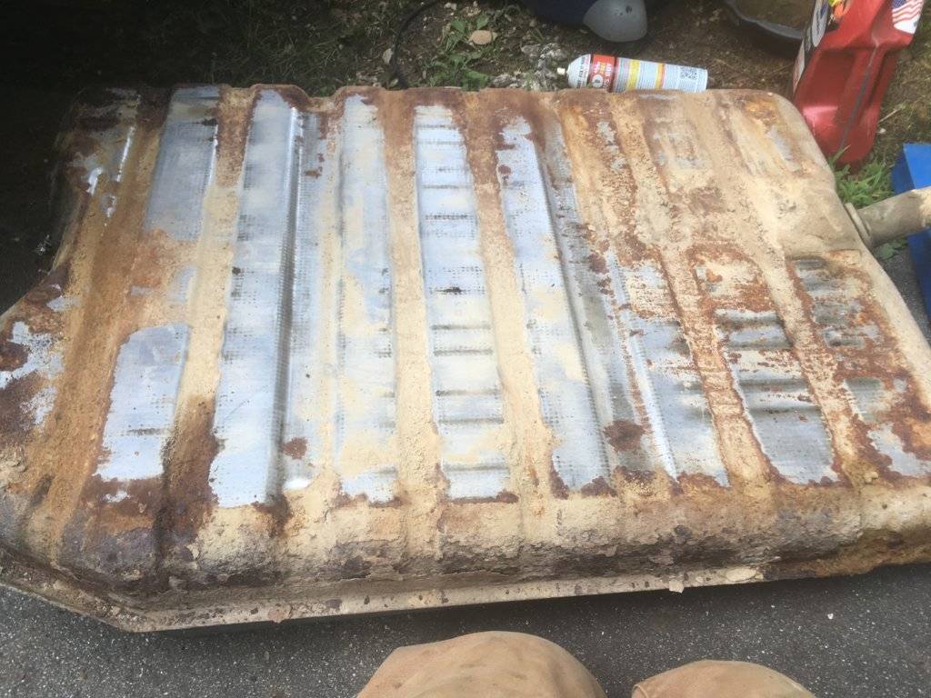

Pulled the fuel line out today. Going to pull the fuel tank tomorrow. Fuel tank gets a look over, cleaning and dealing with rust on the tank and above the tank. May try some rust converter.
Fuel tank before and after rust converter. The before is the top side. It’s still shiny because of the pad that is over it.
I am trying out truck spray on bed liner for the under coating and the gas tank.
Gas tank has 2 very small holes in the top of the tank. Going to epoxy them.
So, today I sprayed half of the fuel tank and the underside of the trunk with the bed liner.
