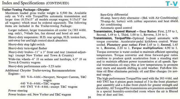

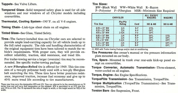

I believe stock is 15x6 4.5 bolt pattern? What is a safe offset/backspacing? 4, maybe 4.5, and what are stock tire sizes?

I’d agree with 15x6 wheels.
ford steel wheels center holes are too small to fit over the center register on a mopar.
https://www.hamtramck-historical.co...ershipDataBook/1969/69_Chrysler_Specs0024.jpg
I believe 4” was the stock backspacing for a 6” wheel and 4 1/4” typical for a 7” wide wheel.

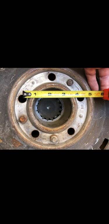

200 bucks! Good deal? Mopar 15x6.5. He's says they are 5x4.25. Is that possible? Thought 5x4.5. His tape measure is off center it look like.
