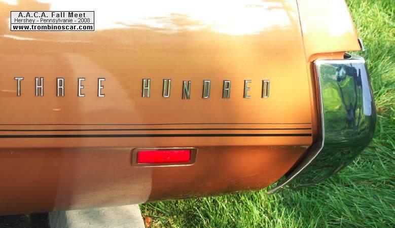

No measuring tape, but this is an unmolested original.
Looks to be about 1/4 , 1/4 , 7/16 with 1/8 between for a total of 1 3/16" +/- , about the same as the reflector.

Look at you with the reference photo.
I cant say I have ever seen those. If I have I never paid attention to them enough to realize they were an original option
Thanks for the great shot.....! That helps a lot. Those stripes really help to break up the massive side of these cars.

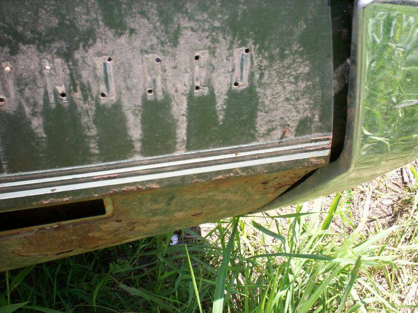

Might help.
Thanks for the great shot.....! That helps a lot. Those stripes really help to break up the massive side of these cars. [/QUOTE]
I can't help but wonder what methed was used to apply these stripes, I'm sure they are painted because I have a paint stripe code on my build sheet. Had to be by machine...or stensil. The three stripes running the length of the 1/4 panel would take a steady hand.

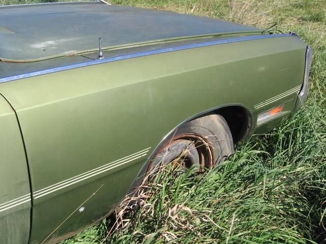

I had a 69 300 back in the early 70's. The three stripes on mine were higher up with the top stripe just below the upper body crease. They were painted on and thinner, like the ones shown on the green car above.

White stripes not original
I have added more stripe-pictures of another green car! These are original!

Here another picture of original stripes...

All very helpful pictures and info. I'll use these along with some judgement when the time comes to apply them to my 69.
I have to think that some variation in the stripes would be concidered normal in a production atmosphere. (first shift on monday...... or...... second shift on friday).....?
