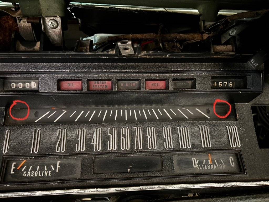

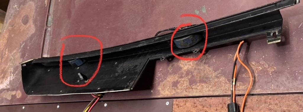

After some work today I only found the 2 lights that are above the instrument panel (photo with 2 red circles).

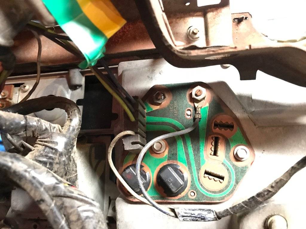

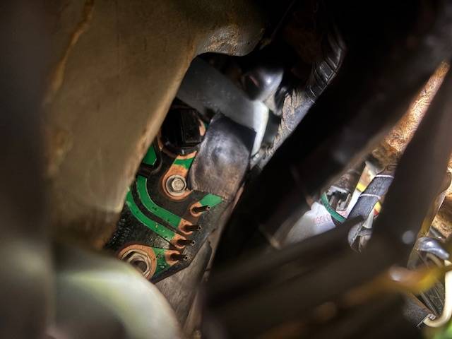

It was hard to see if there were some on the circuit board,

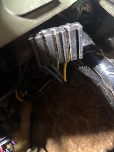

Looking underneath my dash (after removing several things) I see a 4 pin connector.
Testing the wiring going to the circuit board there does not seem to be any (dimmer) related light. Is this correct?

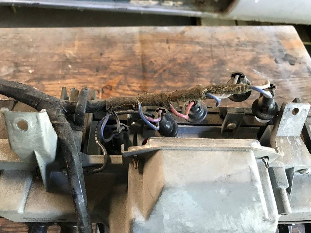

The only dash lights are the ones that you have circled. No lights behind the instrument panel except for the warning lights and turn signals.
THANKS, no more searching then :). If somebody has a photo of the back of the dash/instrument panel of the 69, I would be interested to see it...

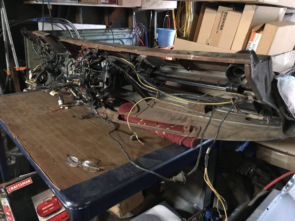

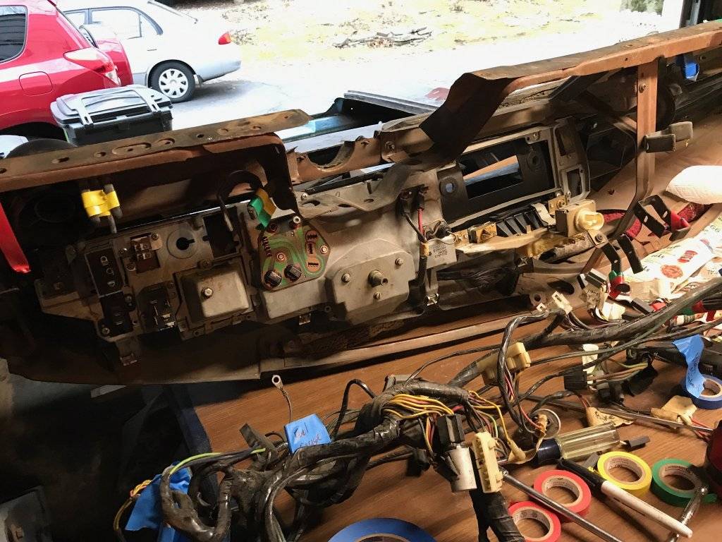

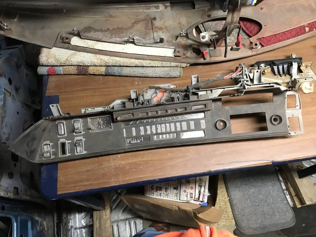

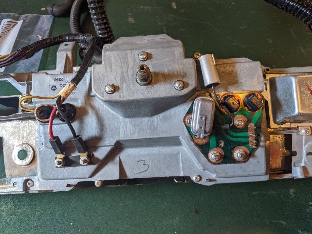

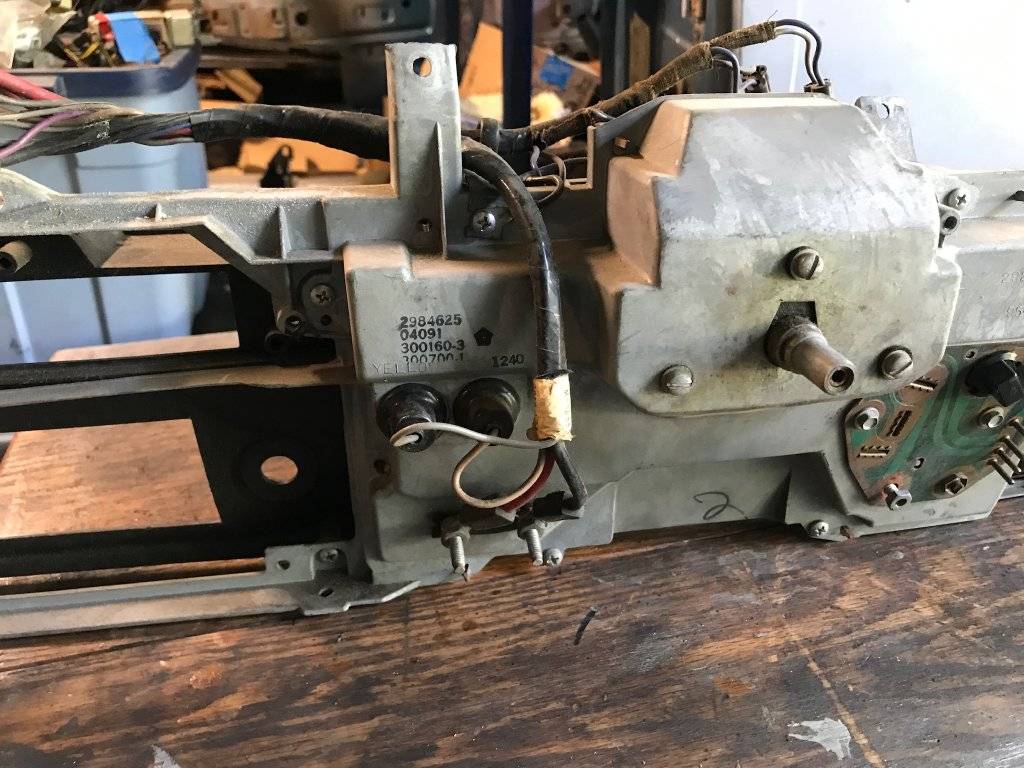

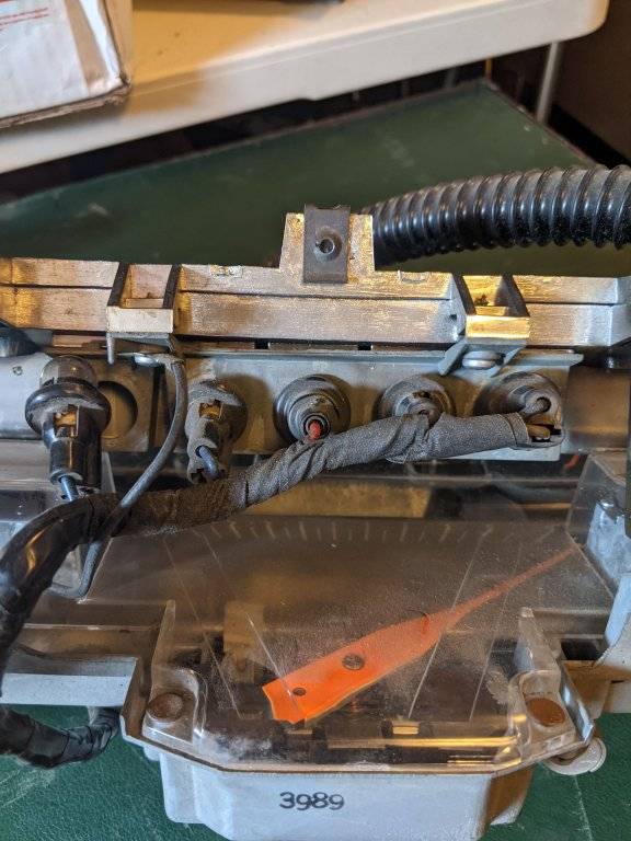

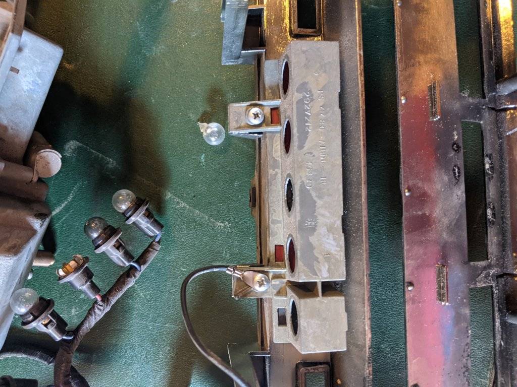

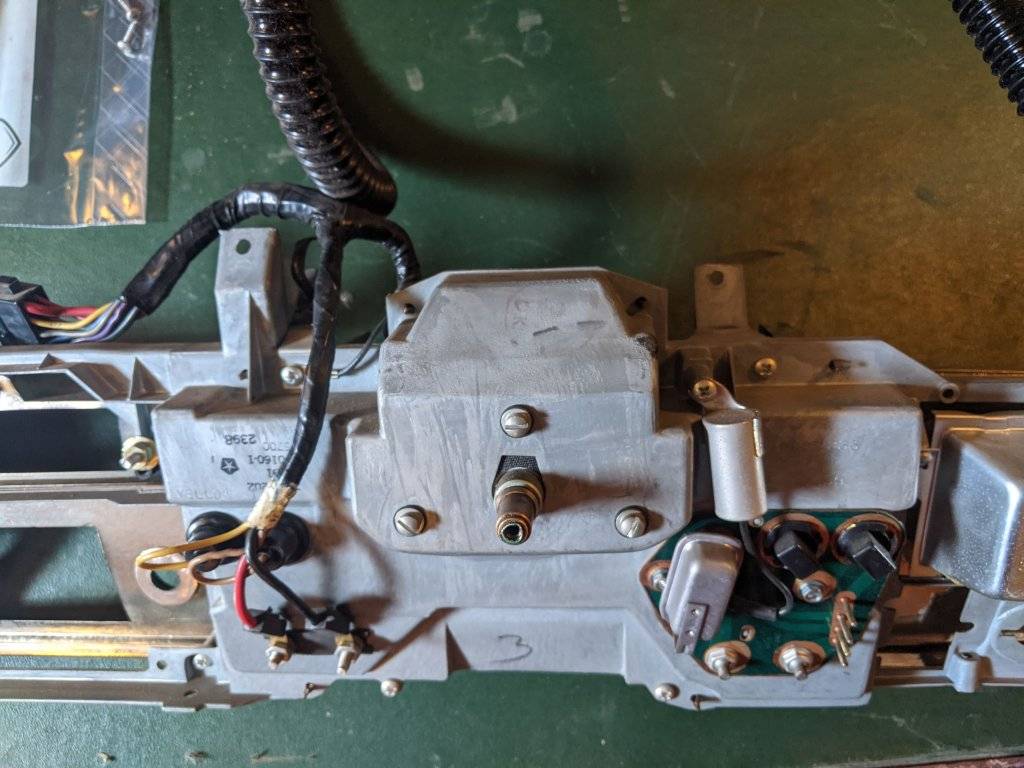

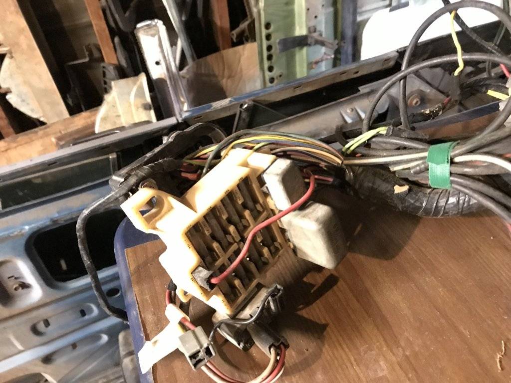

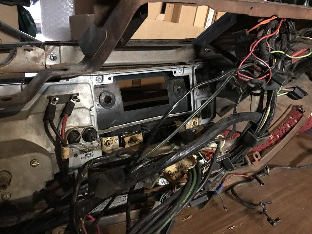

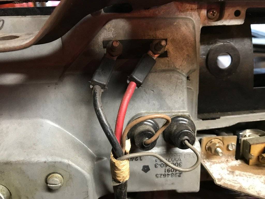

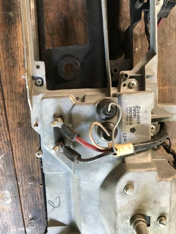

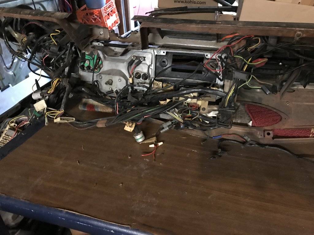

Not sure if these are the photos you are looking for, it this is what I have. These are from a 1970, but they should be the same.

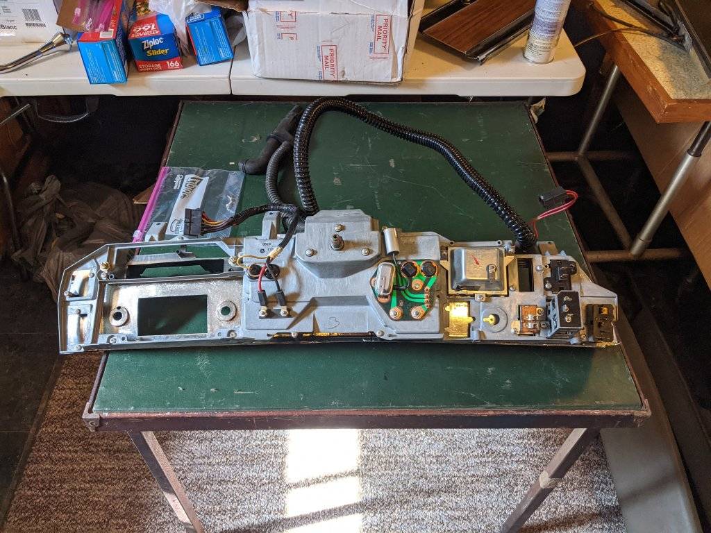

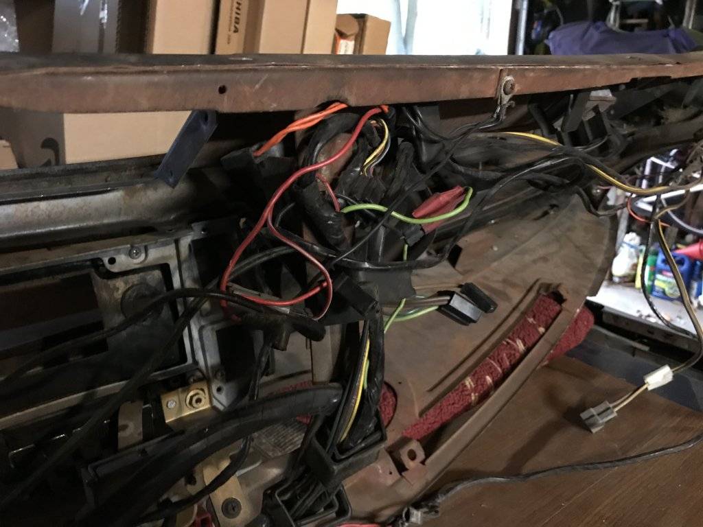

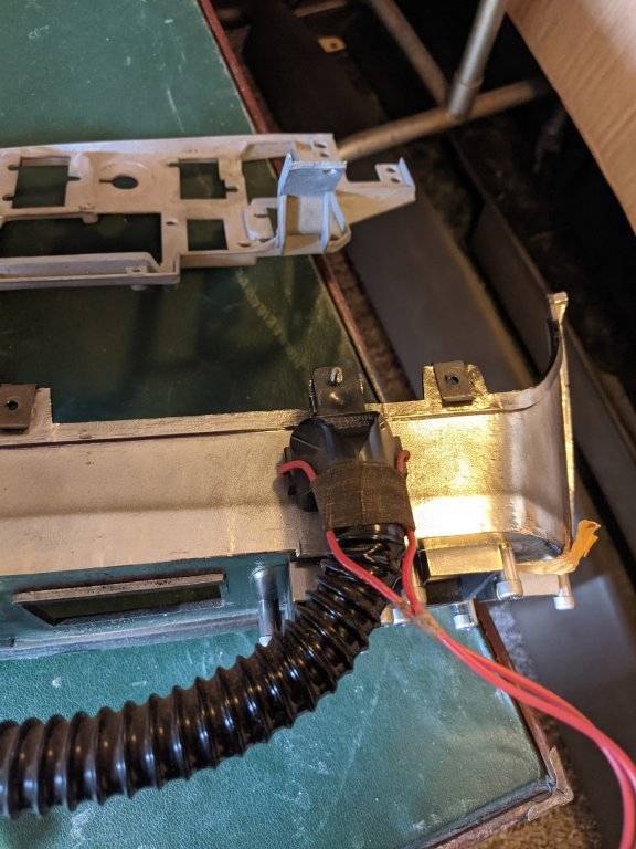

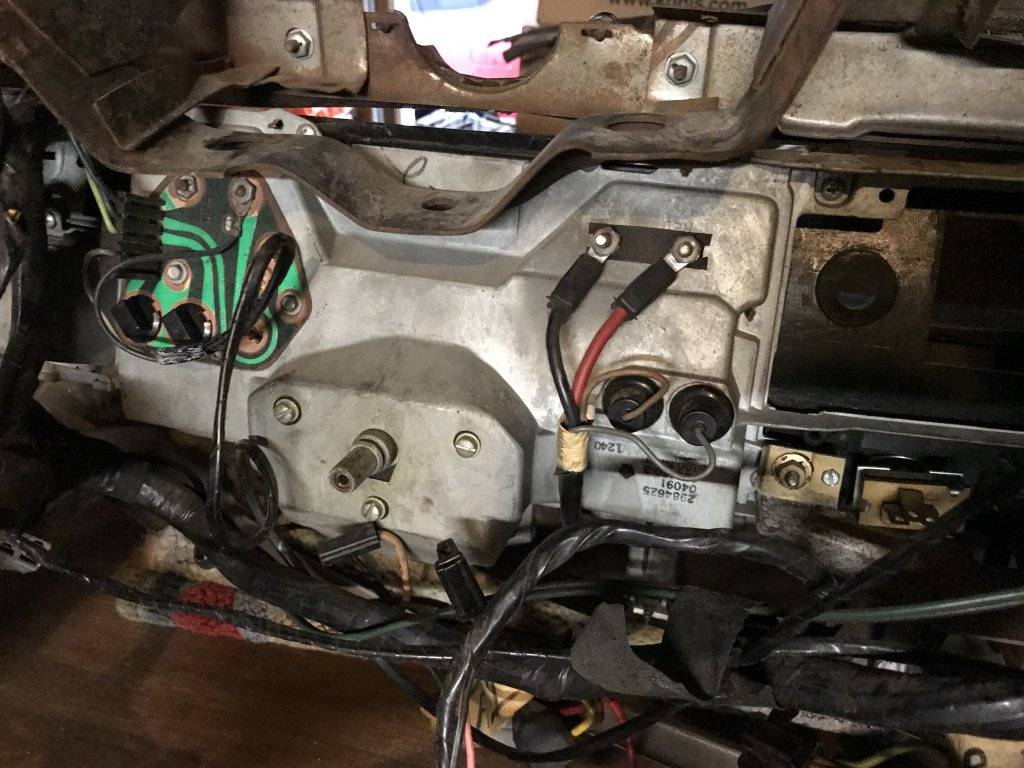

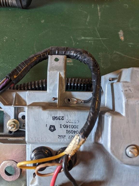

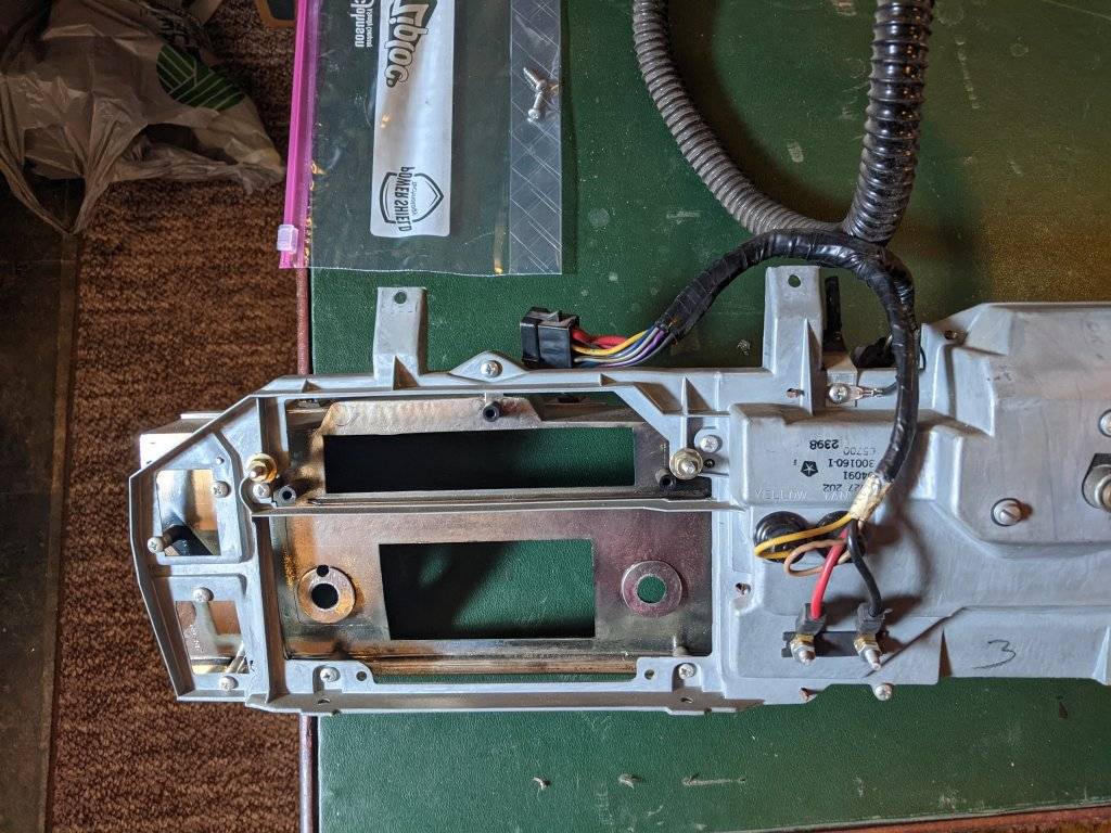

Here are a few more before disassembly. Keep in mind the dash is upside down on the table.

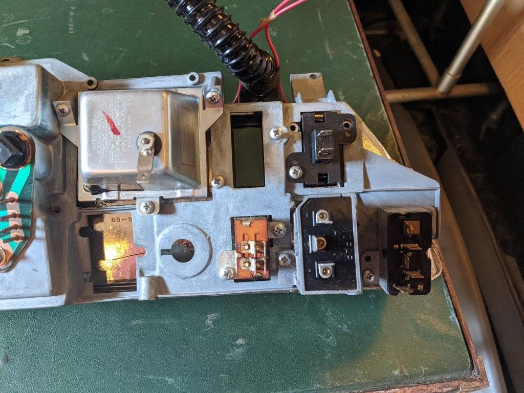

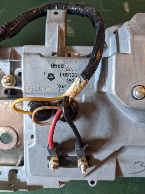

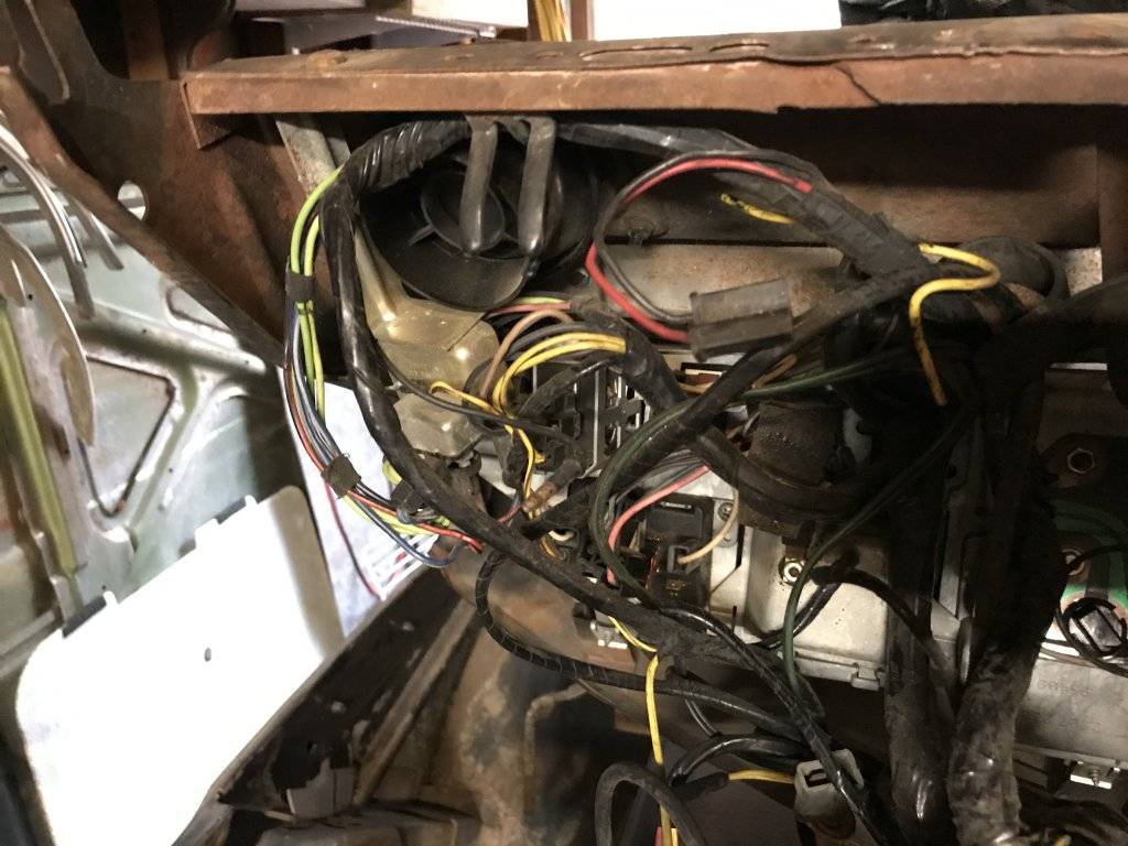

do you know where the yellow wire on the last photo is coming from / going to? thanks
difficult to see but on the right (yellow wire) i see something like fasten belts and on the left I see lock doors or something like that.
That is correct, fasten belts and door locks are what those two are. As far as the yellow wire, my other picture here shows it going into the main harness ...hope this helps!!
