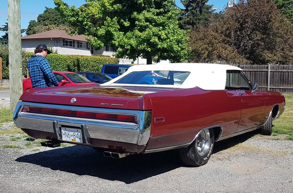

    i have 235 70s on my 70 300, i havent noticed any issues.
    i would prefer a little more width in the rear tho...

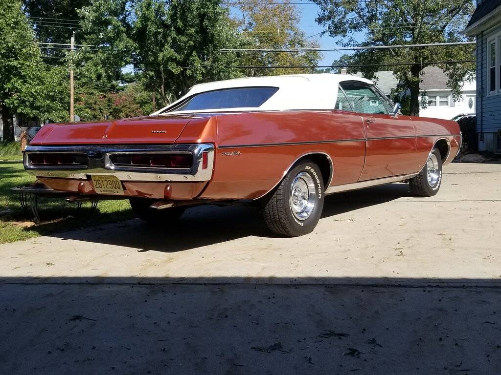

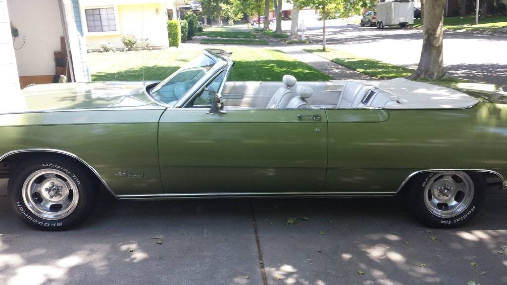

    On the Newport running 23570R15 on 15x7 rims
    28 inches tall and witha 2.94 gear and 27 tooth speedo pinion speedometer is bang on.
    On the 69 Fury,22570R15 27.4 inches tall on 15x7 M body rims stock wheel covers,big imrovement over the old 5.5 rims and 21570r15 tires--which were way too small,BTW.
    With 2.76 gears the new tire size is equivalent to original bias ply 7.75-15 27.42 inches tall and speedo is also bang on..

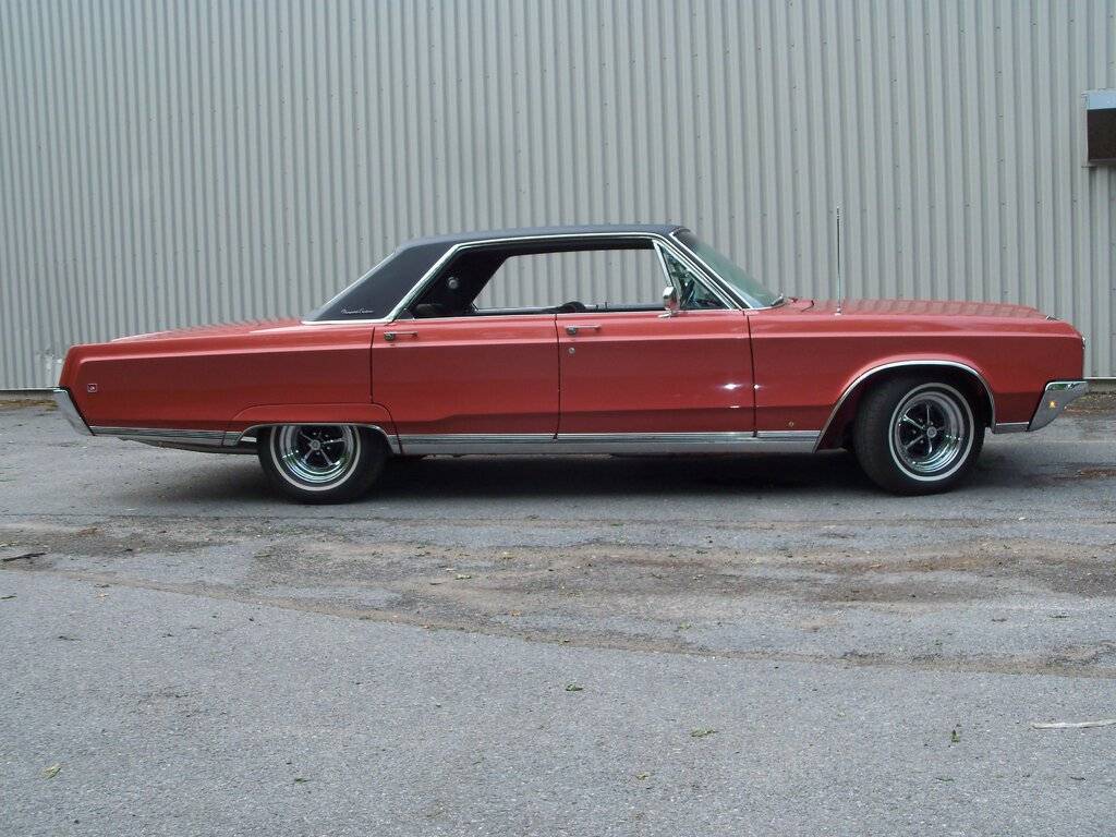

    If we want to stick with w.w.s, 225 or 235 is the size to get. They’re still readily available and cost much less than a Coker or other custom made tire.
    These are 225/70x15 on a 7” wide rim with 4.25 backspace.
    When viewed from the front or back it doesn’t look like it’s balancing on ice skates any more.

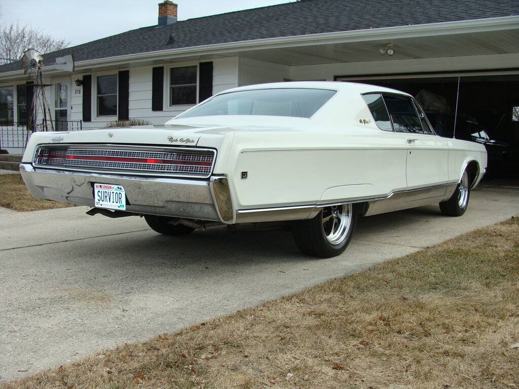

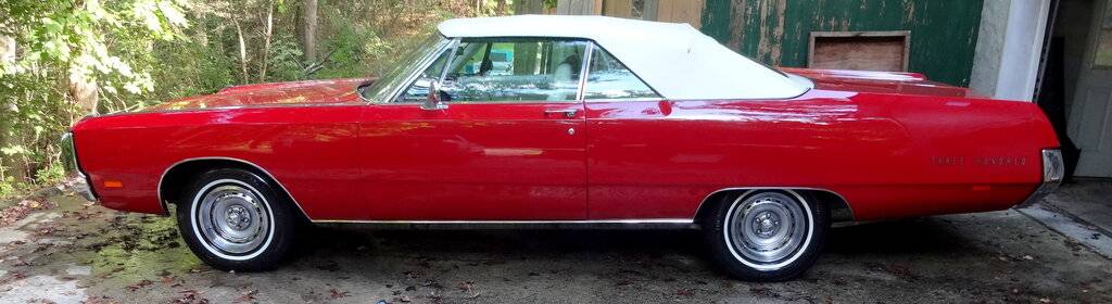

    245/60R15s all around, mounted on 7" wheels. Did have 235s; wanted a larger tire when I bought new ones.
    New
    Old

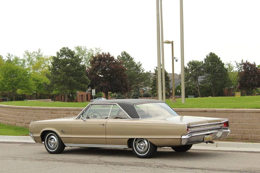

    235x70x15. whitewall. Cooper looks the most OEM.
