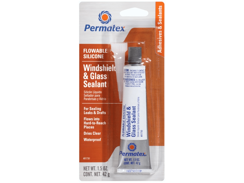

I recently found a minor leak on one of the top corners of the 70 Newport windshield I am working on and I used a product that is silicone based but is very viscous so it creeps in all cracks and seals perfectly. I picked it up at Auto Zone. It was labeled "wind shield sealer/repair kit". Worked perfectly for me. Not everyone may advise this but I felt it was the least expensive and most non evasive way to repair my leak..

Permatex makes a windshield sealant and that is probably what you want to use. Butyl tape would only be used if you were removing the windshield. I'm not familiar with any urethane sealant that is used after a windshield install. The only time I've ever seen it used was to glue in windshields in more modern vehicles.
