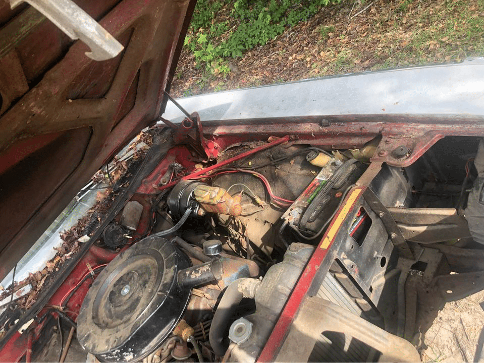

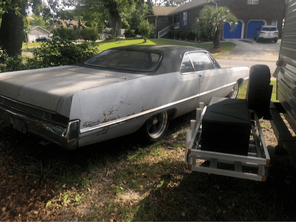

He said the brakes are pretty much engaged when the brake is touched. Says it's way too tight.
Can't drive it due to this. He also said the master and booster were rebuilt and were correct for this application.
Would this be the rod between the two that is the wrong size?
No tag info yet.
No tag info yet.
The rod is adjustable. First thing I'd do is shorten it up and see if that fixes it.
