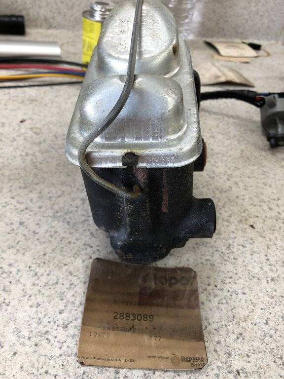

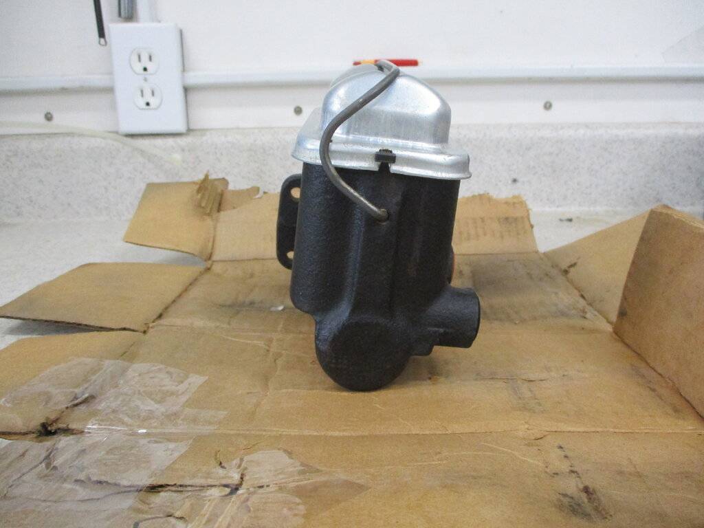

The overall subject is discussed here. Pics of "Booster Steve" rebuilt 69-70 8.5 inch dual-diaphragm unit.
The correct OEM-looking master cylinders (with a "thermometer" shape at the forward end of the casting) are also hard to find but not impossible. I scored an NOS with a fairly big price tag. I'm under the impression (no personal experience) that the incorrect aftermarket units typically bolt up and work fine. Not sure about the problem you have with your brake lines, but not surprised either if you're trying an aftermarket master.
