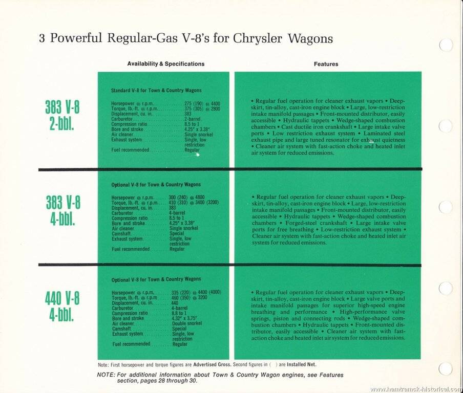

383 2v standard The 1970 Hamtramck Registry - 1969 Chrysler Dealership Data Book - Town & Country Wagon

383 4 bbl & 440 350 HP were the only engine options, no TNT for wagons.
