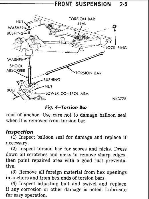

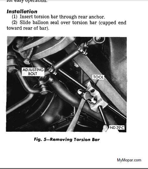

Did you (1) Remove upper control arm rebound bumper.?
The Factory Service Manual (FSM) is your friend.
This is from the 1968 FSM for the Fury, I doubt 1969 would be much different.
Some people 'index' the torsion bars before removal and think that is important but I think you are already beyond that point.
Good Luck...
