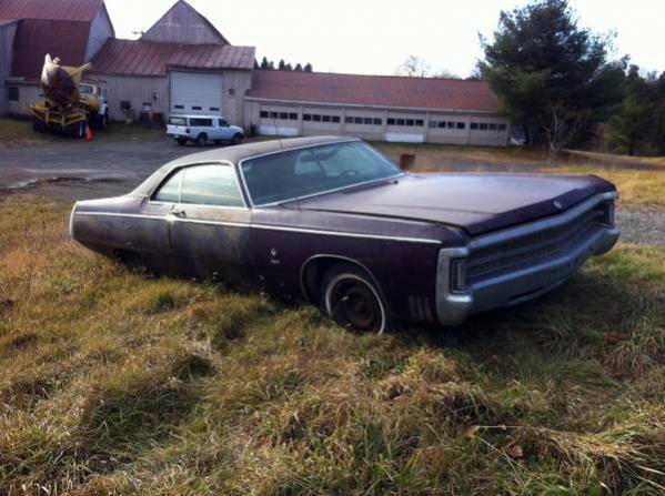

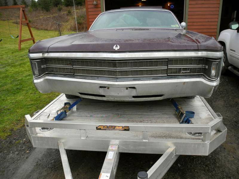

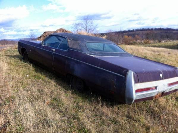

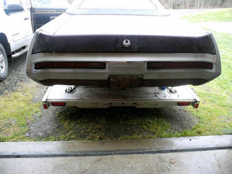

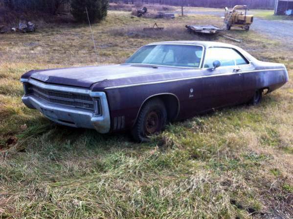

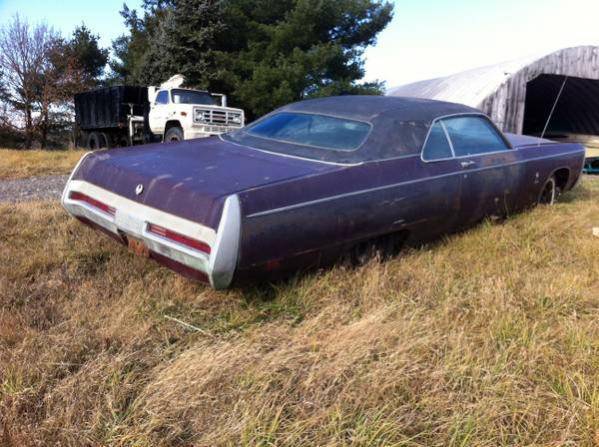

Well, it's done! My 1½ Years long search got to an end. Thanks to all you guys supporting me :)
A special thanks goes to Dano for all his kindness and patience. He's a really nice guy!
Another big thanks goes to Matt (detmatt) for all his help during my search!
It will take a few weeks until I have the car here but I can start with sharing all pictures I have.
I will do a total restauration from top to bottom and try to do as much as possible by myself. This will take a few years. Or even a few more... but I'm not in a hurry.
I'm sure I will have a lot of questions during this process!
Cheers, Julian

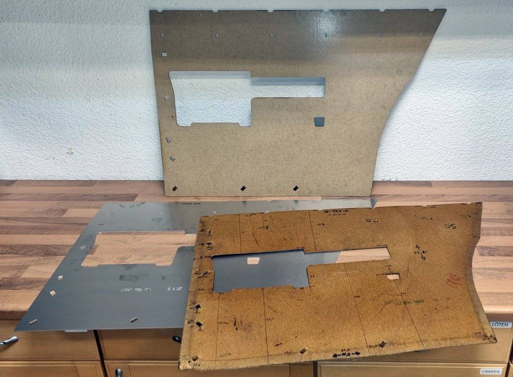

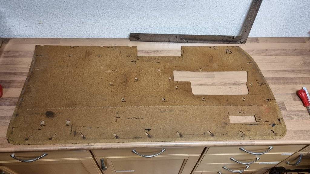

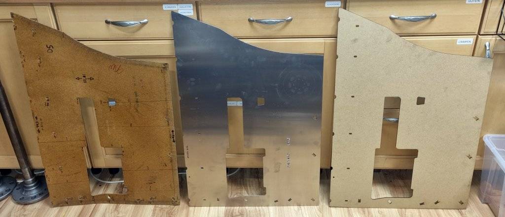

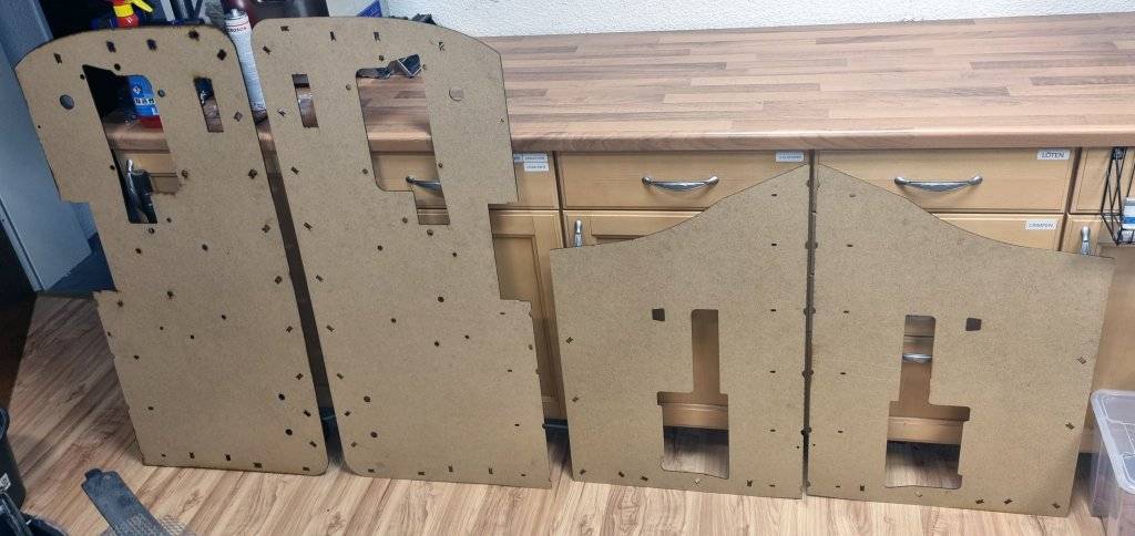

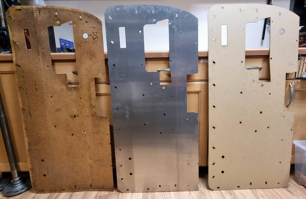

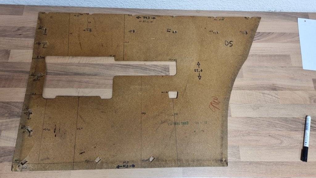

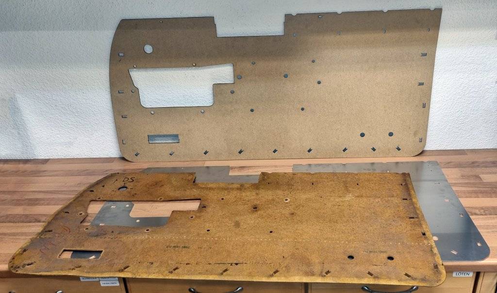

Finally, the Door Boards are done! Laser Cut from 3mm MDF boards.
I checked them against the originals and they are a perfect fit! :)

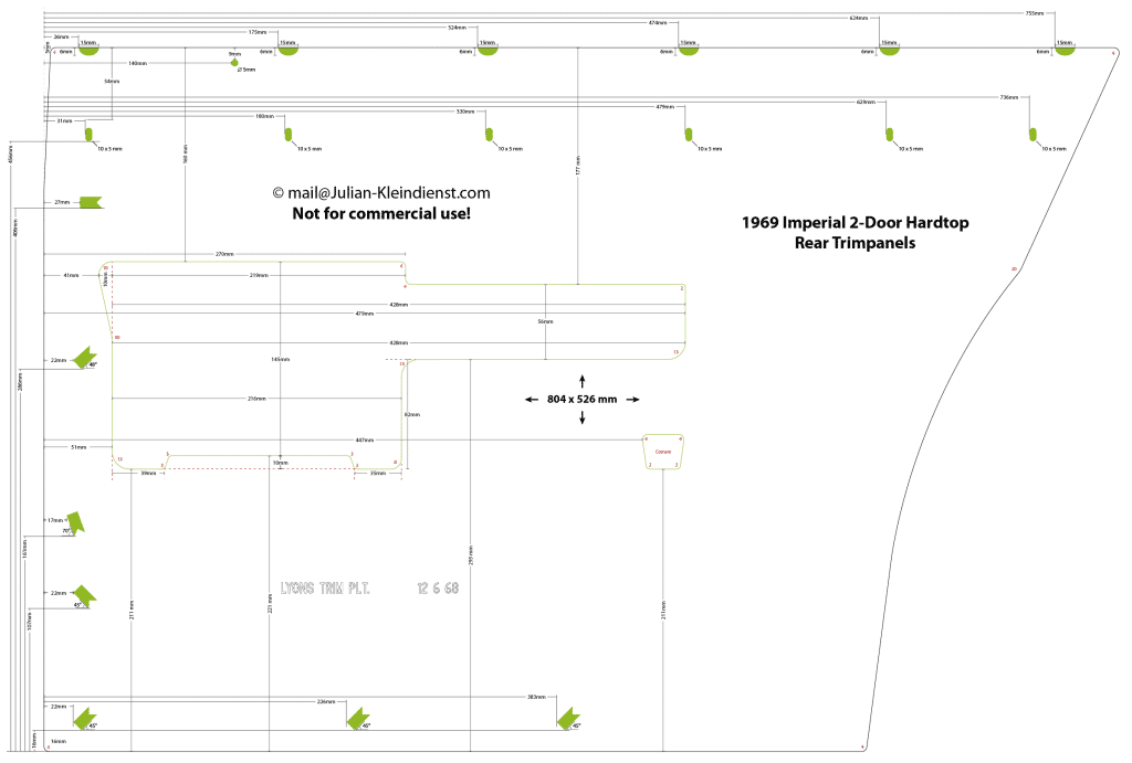

They are free to use for everyone who needs them as long as it’s for personal, non-commercial use!
Since reproductions are not available, I made my one Templates for the Door and Rear Trim Panel Boards. After multiple rounds of measuring and correcting my Templates, they are finally done.
They are perfectly fitting 1969 Imperial 2dr Hardtops. I’m not sure about other brands and model years since they constantly changed the door pulls and such.
The PDF-Files are scalable, vector-based Templates with all the exact measurements for everyone who needs them to cut the boards out by hand.
The DXF-Files are optimized, ready to use files for CNC use with a Laser or Mill.

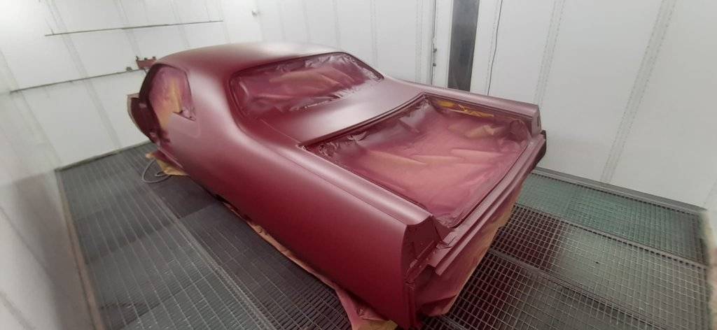

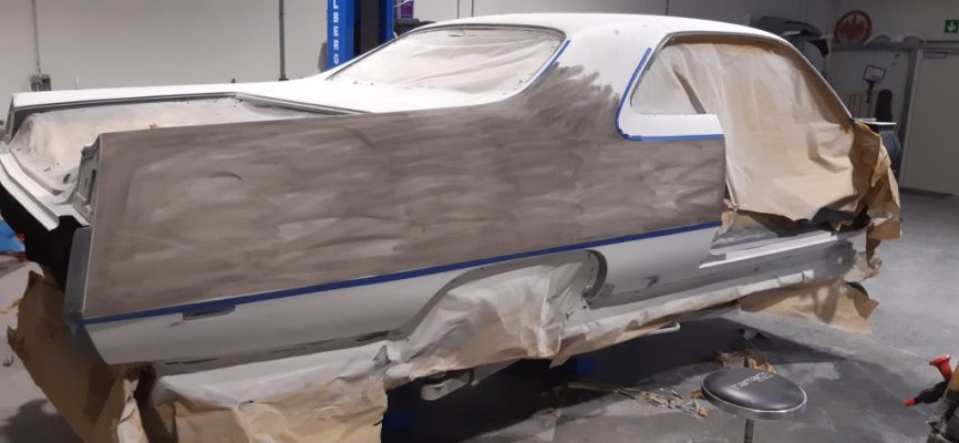

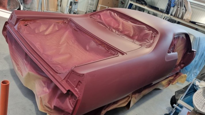

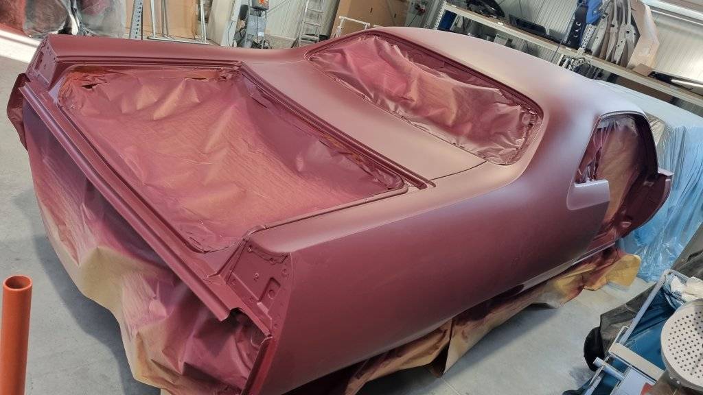

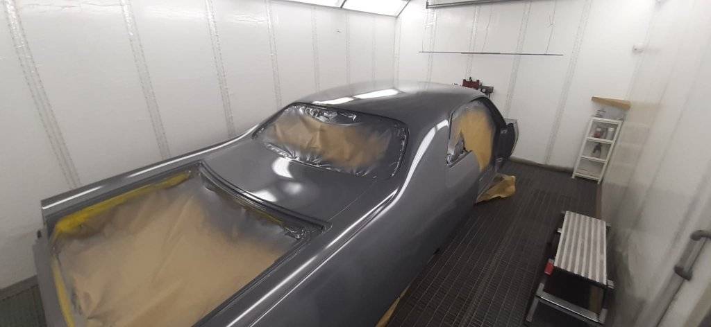

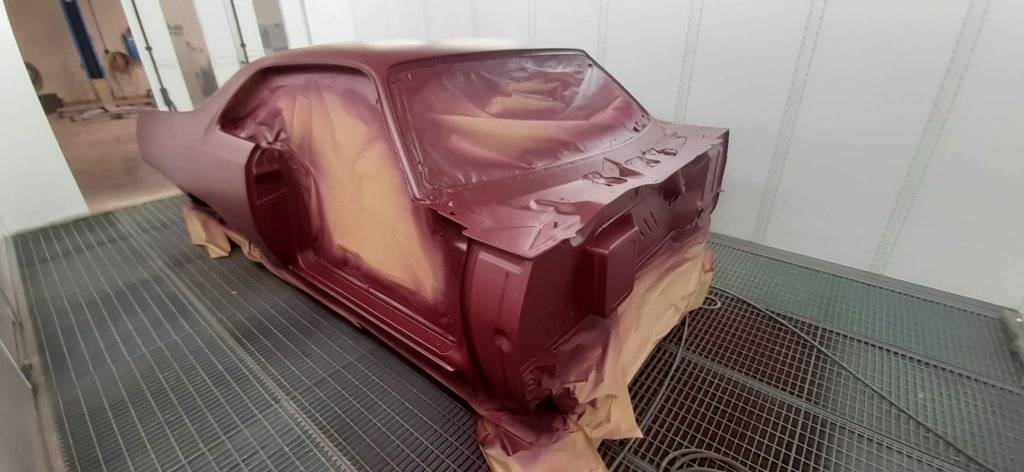

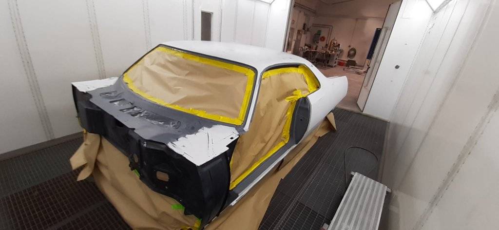

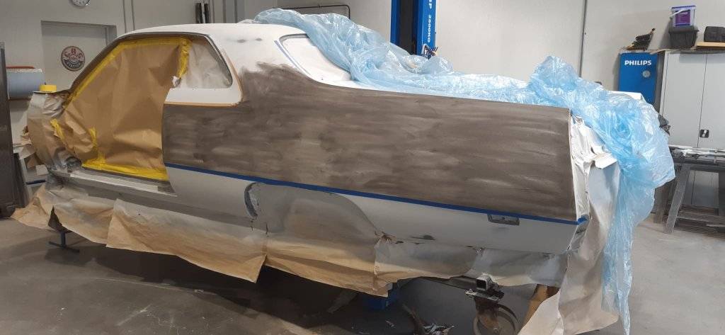

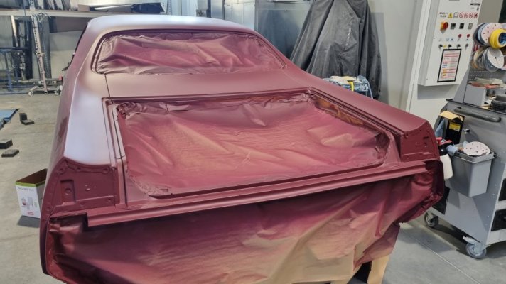

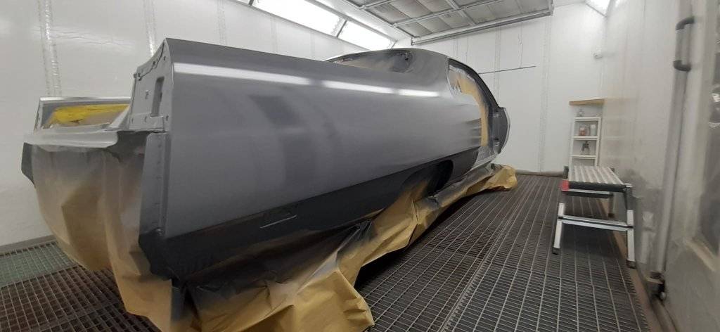

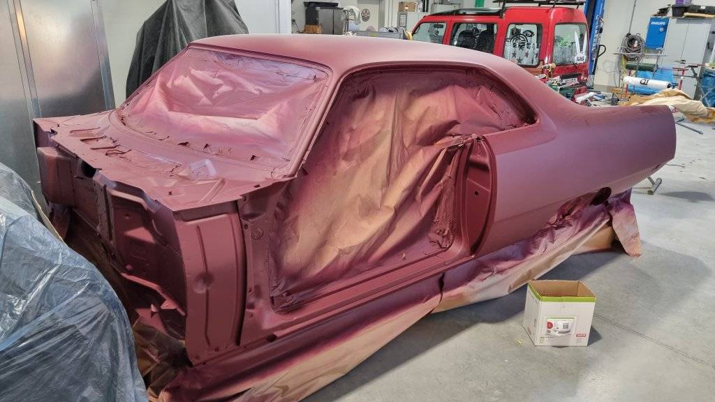

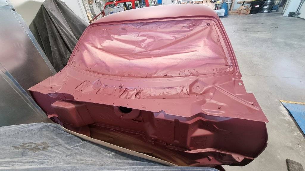

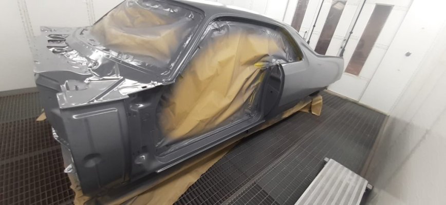

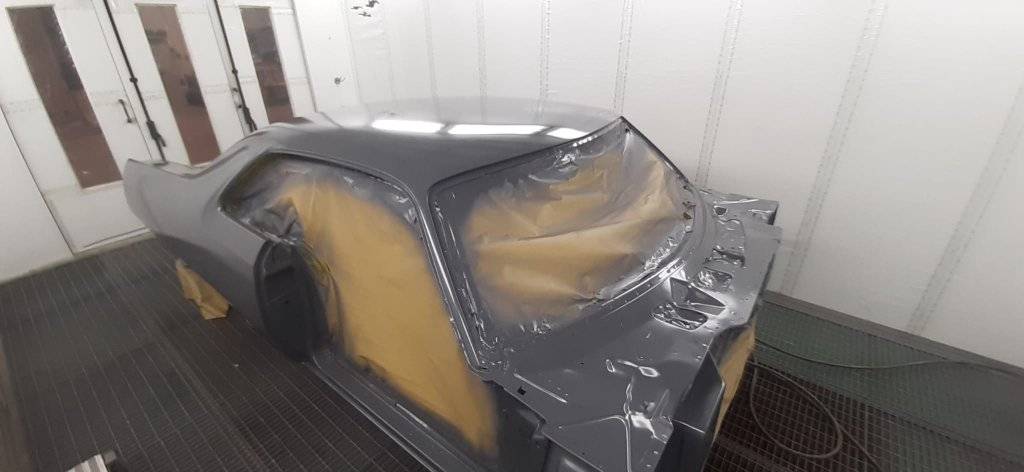

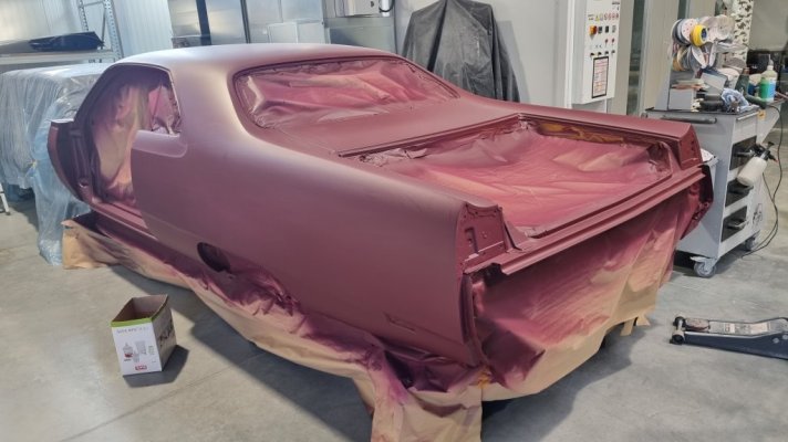

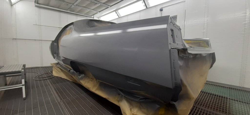

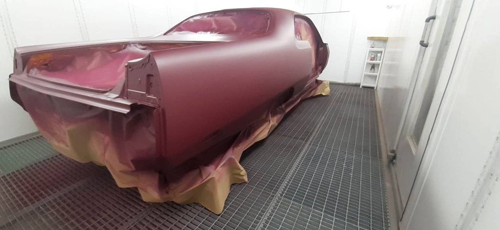

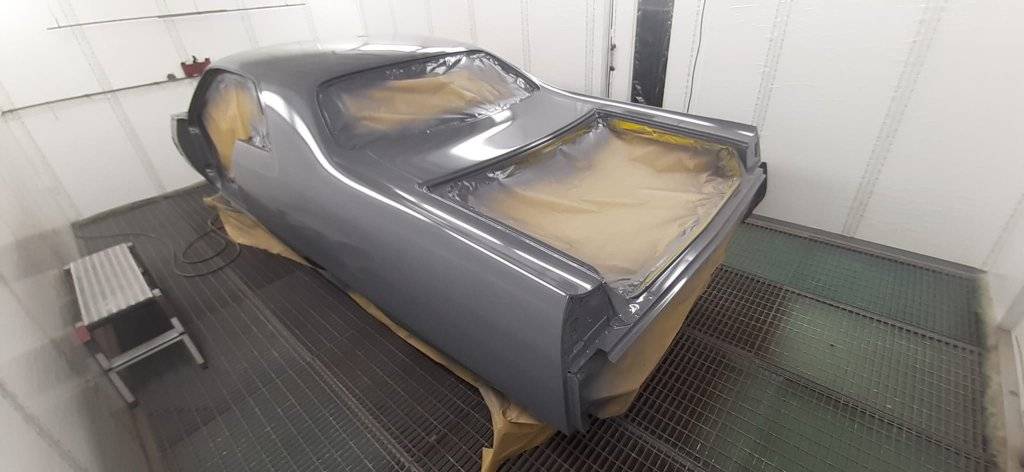

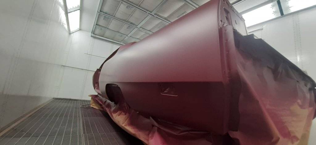

And then, a thin, final coat of filler was applied to seal everything. Already tinted to match the M9 base coat.
Next will be to prep the doors and fenders to this stage to match the body lines and finish.
Meanwhile I will scuff, seal and prep the underside so it can be painted as well.
After all that, there will finally be the M9 base coat and 3 coats of clear. :)
