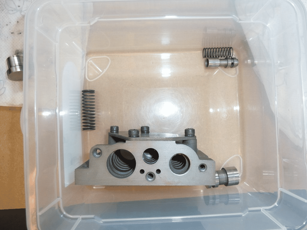

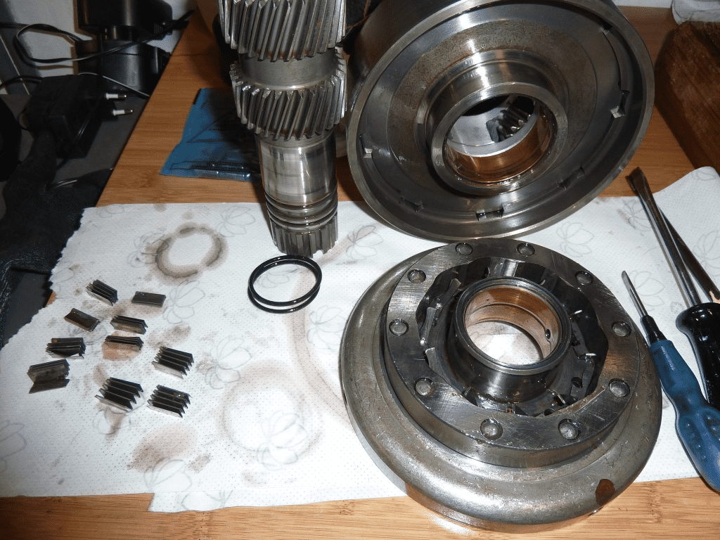

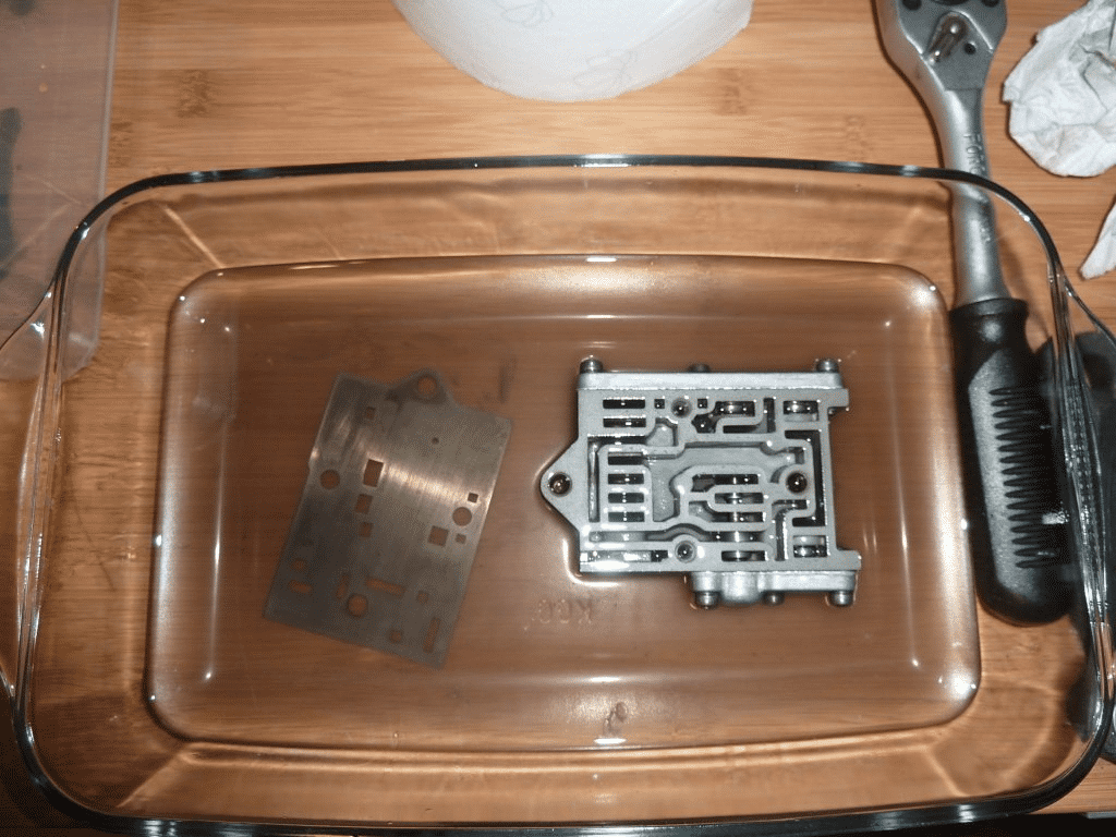

2 years ago, the rear axle seized on my '58 Plymouth Belvedere (a guy working on it had forgot to put oil in it), resulting in a broken Torqueflite transmission (the cast iron one). I knew transmission shops were really expensive (I'm in Europe and automatic transmission are rare), so I set out to do it myself, with the help of a fellow enthousiast in France who knows Torqueflites really well.
Long story short, I did it. It took me some time, as I did carefully move one step at a time. You have to be meticulous and very thorough about that job. Use proper tools, and lots of solvent to clean everything, always. I used clear plastic boxes to stock parts. You will need also some compressed air (a small compressor will do), as cleanliness is of utmost importance.
Aside from that, it's a pretty straigthforward job.
And I enjoyed it.
Furthermore it gave me confidence in my mechanical skills.
If I could repair an automatic transmission, then I could do a lot more !

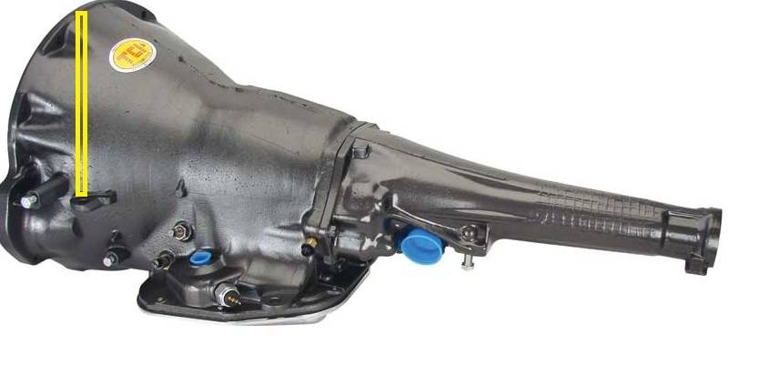

I used a couple pieces of threaded rod and some nuts and washers and attached them to the ears on the bellhousing (yellow on the pic). That let me flip it on its back so it wasn't rolling around on the bench.
