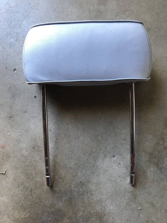

This is what would have been in the car...
Nice,thank you.Anyone here buy the repos n what do u think?

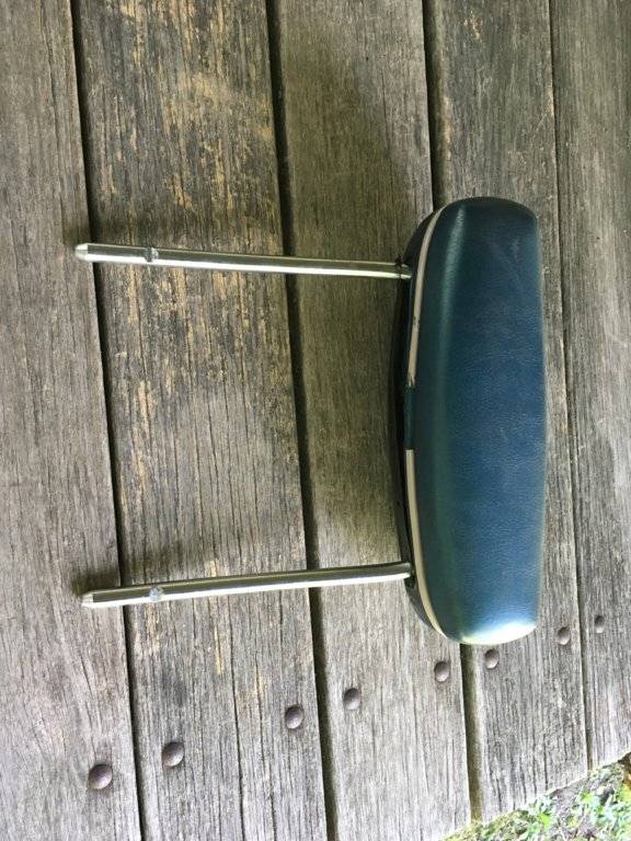

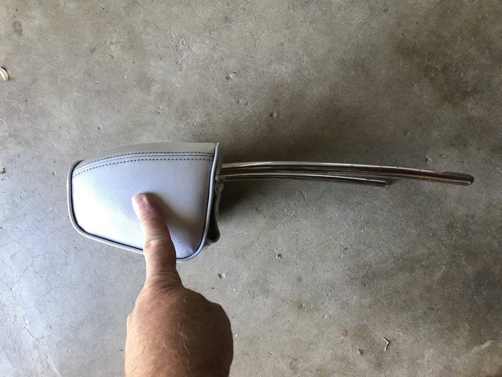

Besides the obvious physical differences in appearance (I know, that’s redundant), the bench-type are moveable up or down, while the bucket-type are fixed.
Does anyone have a pic of bench seat type so I can see the physical difference?

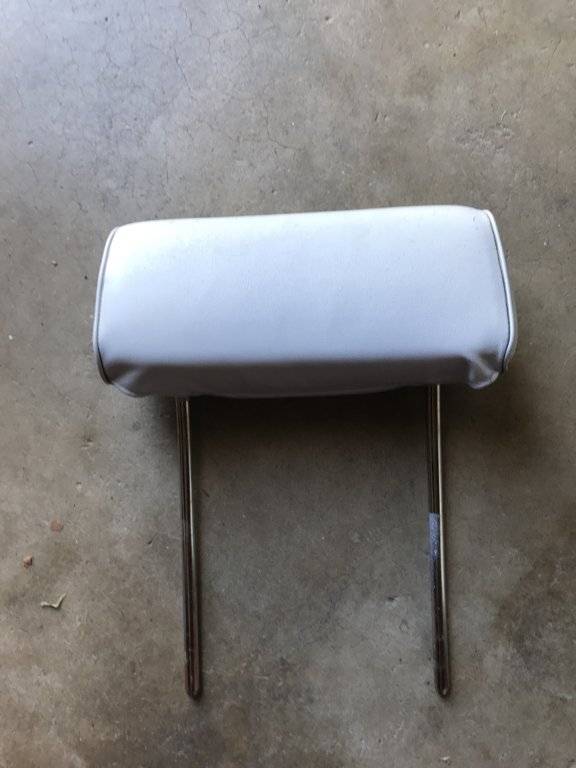

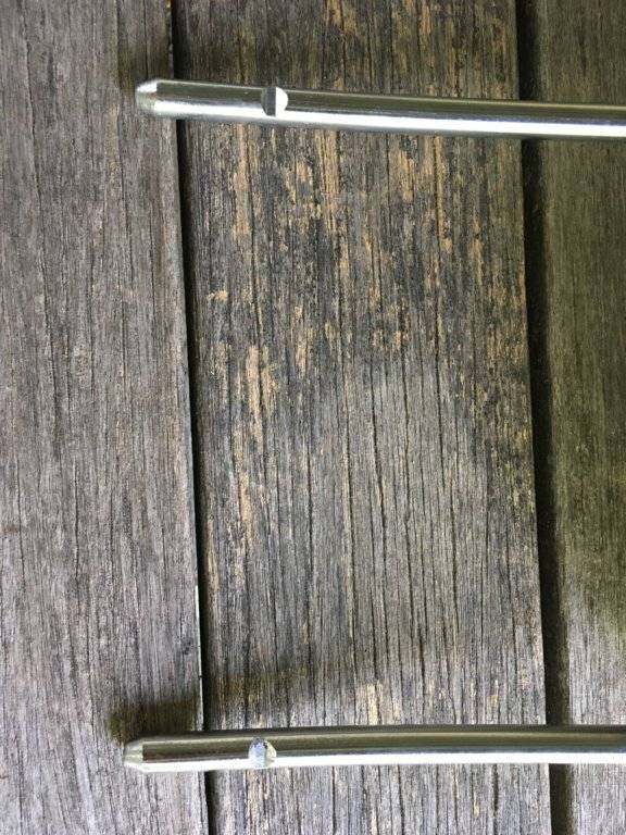

And btw, here is a pic of an original from my ‘69 GTX, which I’ve owned since ‘78. Please notice that there is only one notch in the shafts. The bench-type have three. I guess it is semantics as to whether or not they are “adjustable”. Here’s my amended statement: The bucket-type are intended to be fixed, while the bench-type are intended to be adjustable up and down. Unless C body are different than B body. Does somebody know more?
And 300 rag’s picture is of the correct, fixed position, so I’m not sure what it’s proving. Please enlighten me!
I certainly admit that the bucket-type are not immovable. These cars come completely apart and a person can change things how they like. Are the C body bucket-type different than the B body? Anybody got a pic of a C body bucket-type with three notches, as the bench-type all have? I maintain that the bucket-type are intended, by the designers, and as built, to be fixed.
